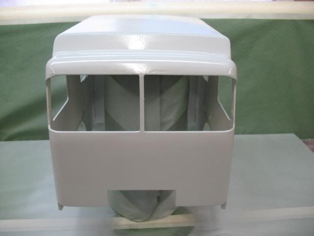

I got a bunch of nit picken work done today on the truck. After meeting with the company and taking a little walk around the plant with Nick and getting a good up close look at the trucks I seen a few things I was not happy with the way the windows looked so I cut the nose off again and lowered it 3/8 of a inch then also cut the side windows to match that 3/8.I also changed the curve in the upper corners of the windshield.
Nose Lowered
Then I cut the side windows down.

Well after a lot of filler work and now I finialy got the body in K2 fill and kill primer Ill wet sand this out and use a DuPont surface primer and scotch bright that and start paint wont be long now this truck will be making fast progress now. I have the decal shop working on the decals now too..
I have been working on the truck I ran into a issue with the nose of the body that slowed me up but I got it fixed and all primer work is done and it is in the White color as i type and will be ready for the red tomarrow i hope.
