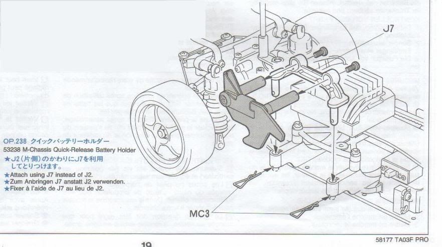

  2. The instructions on the Carbon Battery plate. How will this work? How does the battery gets fixed?

2. To use the carbon chassis plates on a base model TA03 kit you will also need the FRP chassis conversion set which has all of the mounting hardware included.

Just look at the TA-03F Pro manual provided. The carbon chassis plates replace the FRP plates, so you'll need the parts that are required for that. Of the top of my head, those parts are:
- the plastic part to mount the steering system on (GPM makes an aluminium version)
- the plastic parts for the battery mount
- the antenna-tube holder.

I allready have the full carbon chassis conversion etc etc etc. I'm talking bout the carbon battery plate hop up conversion for the TA03.

Not sure which 'battery plate' you are referring to; Perhaps the quick release?
Hope this helps!
