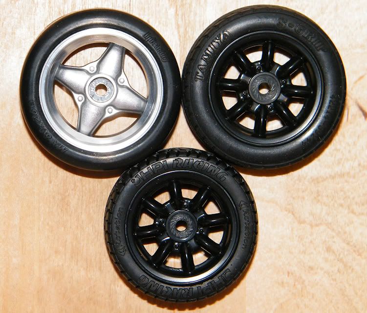

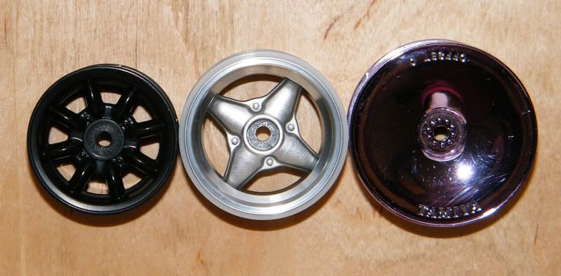

Didn't see this thread somehow but now that I have I'll try to give some of my input on the CR wheels tires.
Stretching Mini tires onto the CR wheels won't work, I'll try to take some pictures to explain what I mean. As for the CR wheels, they also come in 8 spoke pattern. Anyway here is a comparison of the wheel size.
With tires mounted. The two black ones are Mini wheels with 60mm and 55mm tires.

I've actually done the stretching and it does work after a fashion. The edges of the tire are higher than the center after the stretching, but I figure I can force that with copious foam stuffing. B)
