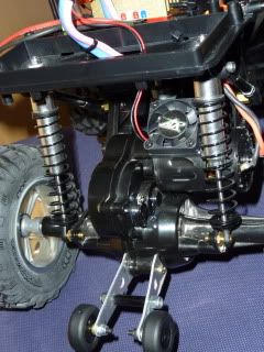

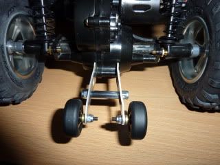

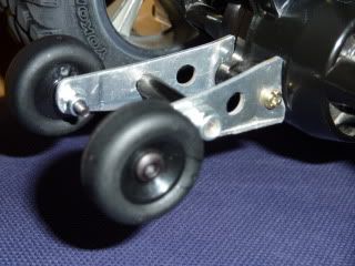

Got my wheelie bar working good today with a little bit of drilling and such. I used two model airplane wheels, they are aluminum and rubber, and some other bits to get it all mounted. Seemed to work pretty good

3. numerous body mounts, I have now installed the parma body mounts in the rear as you can see from the picture I believe.
