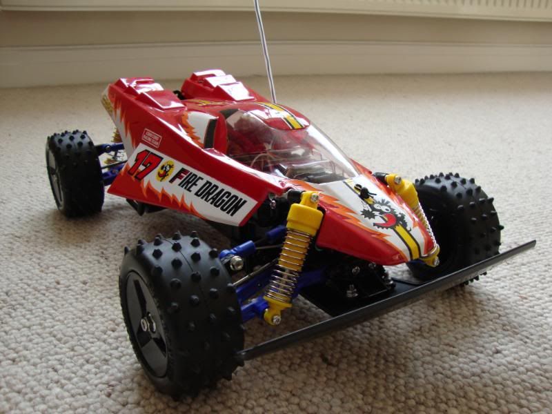

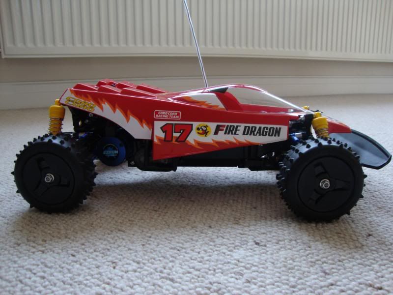

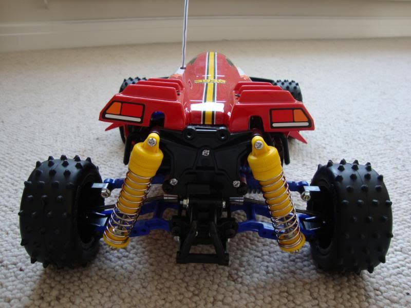

Well here she is! just needs a driver and then its hop up time ;)
I must admit I like this car, I know its not to everyones taste but I really think its quite cool :D
Well I just gave it its first test drive, only on my street but crikey its quick! when I use the GT tuned Hornet on the street I use about half of the length of the cul de sac, but this thing needed the hole street!
The standard tyres are way to hard, on tarmac its like driving on glass! the car would spin for fun which at that speed made it entertaining :(
The car however is very planted and stable, the grid on our street would make the hornet do a triple somersault and crash but the FD glides over it at double the speed. It also looks fab in red with bright yellow dampers :)
So now its a quest for grip as I do like to take the car out on the rough stuff but its also nice to be able to just take it on the front for a quick play!
Also what a difference in battery time, the hornet will do well over 30 mins with a good 15-20 at full power, the ezrun did about 5 or ten at full power and I need to run it down now. Think its time for a better battery!
Boothy
