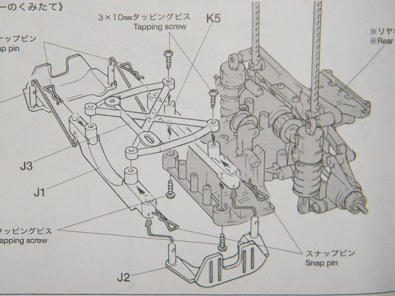

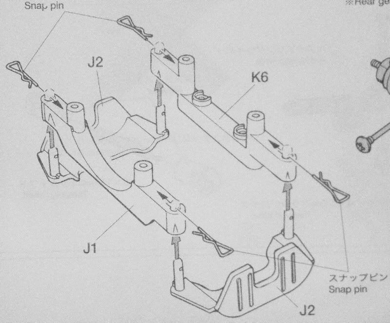

On the 03F-S side, I have a conundrum..... the front gearbox mounts onto the chassis no problems, and the top plate to the 03F-S front and rear gearboxes..... but once I mount the rear gearbox, I can't mount the second battery holder bridge part! The gearbox mounts in the way!!!!
Anyone have any idea? I would prefer not to have to go to an 03R rear gearbox, suitably fettled (ie. lightened)......

AFAIK, the F and F-S use the same rear gearbox. Are you using the right battery bridges? The F-S/R-S FRP chassis set comes with additional battery bridges to get past the rear gearbox.
If you lack those specific bridges you will have to use the TA03F Pro carbon battery plate set...

Does anyone have the F-S/R-S chassis set instructions scanned and available, or know where they could be grabbed from? Seems I need to find out exactly which bridges these are..... although my guess would be the K5 and K6 parts...

I was hoping it would be different.... my problem is that the rear 03F gearbox covers up the rear battery mount holes....

In that case you'll need the specific battery bridges. AFAIK, changing the 03F rear gearbox for a 03R rear gearbox (= 03F front gearbox) will not solve your problem, as they use exactly the same screw holes.

Does anyone have the F-S/R-S chassis set instructions scanned and available, or know where they could be grabbed from? Would really like to see what I'm missing....
Alex
Relax....I think the part you need is the K parts which aren't sold separately. :lol:
For a TA03F-S battery mounting position you need K5.
For A TA03R-S battery mounting position you need K6 but unlike the K5 which goes OVER the gearbox the K6 goes under it. In other words. On the TA03F-S you have K5 then gearbox then chassis plate. On the TA03R-S you have gearbox then K6 then chassis plate.
