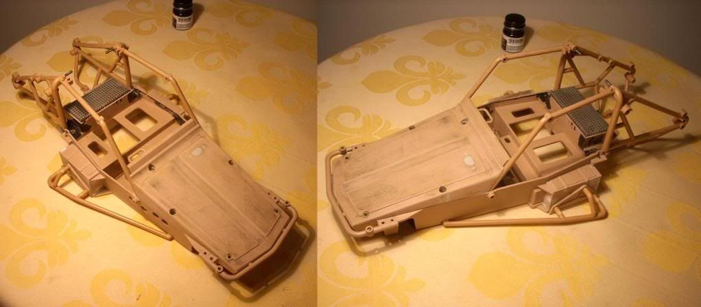

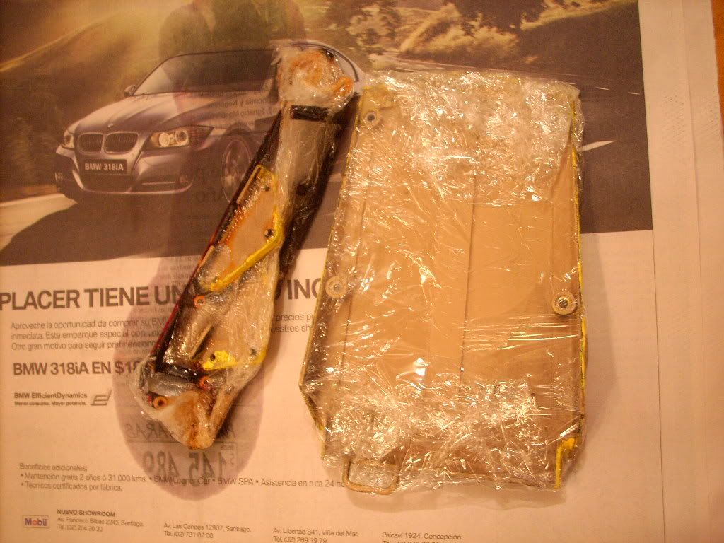

Well, just last Friday I could stop a minute and get onto working the FAV again. This time I think I come up with a useful way to use the brake fluid to strip the parts. My buddy Julio gave me a little bottle of brake fluid (have a look at the pictures). I had nothing else to use, only that very little quantity of fluid, so I had to think of a possible way to get things working properly for my money. I grabbed the bonnet, side bars and plates and covered them with some ordinary plastic film that is used to cover sandwiches. Prior to doing that I covered them with brake fluid using a small brush. I did the same with the bonnet. The main body was not as easy, although only the sides of it were pianted. I just covered the sides of it with very little brake fluid again using the small brush but had to let it out in the air, no plastic film covering it.
After less than one day I noticed the paint started to wrinkle and today I could take the paint off the parts. It was pretty easy, although for the main body part I had to repeat the process, because not all the paint came off. I got most of the paint off of it, and now I repeated the process. I think the 3rd or 4th time will get it all off and ready. And the best part of this is... I still have plenty of brake fluid!
I thought about sharing the experience with you guys because I have used lots of brake fluid in the past to strip a Monster Beetle, and I have noticed most TCers like to submerge parts in lots of this expensive fluid. Well, here's a cheap way of doing it. Hope the info will be of use to you guys.

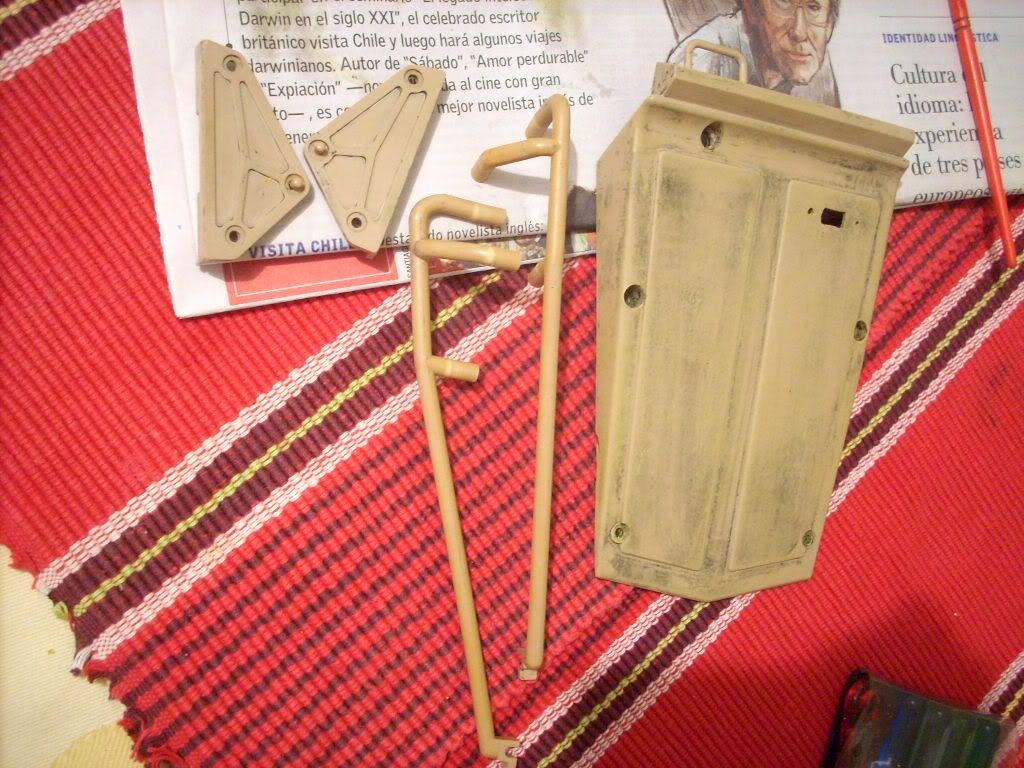

Well, it took me many hours to get the body ready to the point I wanted it to be. Here's a picture so you can see I repaired the two holes in the bonnet. Hopefully, I'll have some time to stop and work this buggy again next weekend. :lol:EBFAV.jpg
Great idea Erich very innovative I would never have though of using cling wrap very clever that is thinking outside the square .I have had my FAV soaking for 4 weeks now I finally hit it with a scourer yesterday with good results .
By the way that has to be the smallest bottle of brake fluid I have ever seen ,but it did the job and that is what counts

Well, it took me many hours to get the body ready to the point I wanted it to be. Here's a picture so you can see I repaired the two holes in the bonnet. Hopefully, I'll have some time to stop and work this buggy again next weekend. :mellow:EBFAV.jpg
That looks great :) Always good to see restoration going well. Good work my friend.

Hiya Stuart! Well, when making it "outside the square" I was thinking "anywhere fitting my budget". :angry:

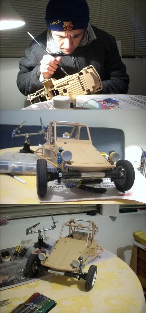

Today I had to come back home a bit earlier because of the rains we have had. No worries -I spent a couple of hours working the FAV. :)
By now I know I'd rather work and restore ten cars before painting another one! I love to paint the details, but the bodies are always such a pita! Anyway, I'm loving this model. Recently I noticed TC member Regressing saying "the FAV is too cool to run it". Well, I'm starting to have the same feeling... but I know in the end I'll take this one for a run or two as soon as possible :lol:
I love the repro lamps made by NZ's Beetlelover. They look cool beside the front hydraulic shocks.
I really believe the Fast Attack Vehicle must be one of the most beautiful RC models ever made by Tamiya! :lol:
Looks like winter has set in as well and truley Erich I am wearing a beannie as well as I type this .
The Fav is my favourite Tamiya buggy I have 8 I would collect all of them if I could they are great to work on the detail on them is amazing .
They run well virtually bullet proof can take the knocks and still come back for more.
Your resto job looks great so far mate it looks like you are enjoying yourself and that is what matters .
I have recently done two up in civvy colours and currently working on a third one in french blue .
Looks great EB :)
Stuart.

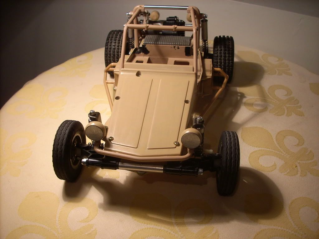

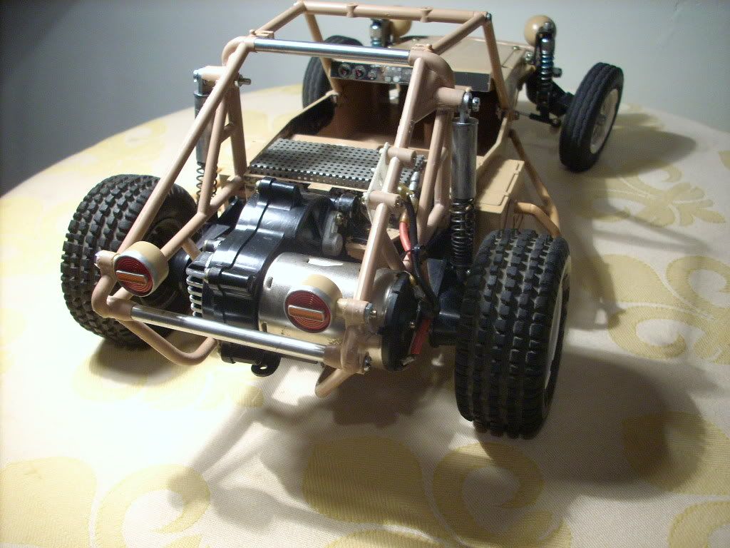

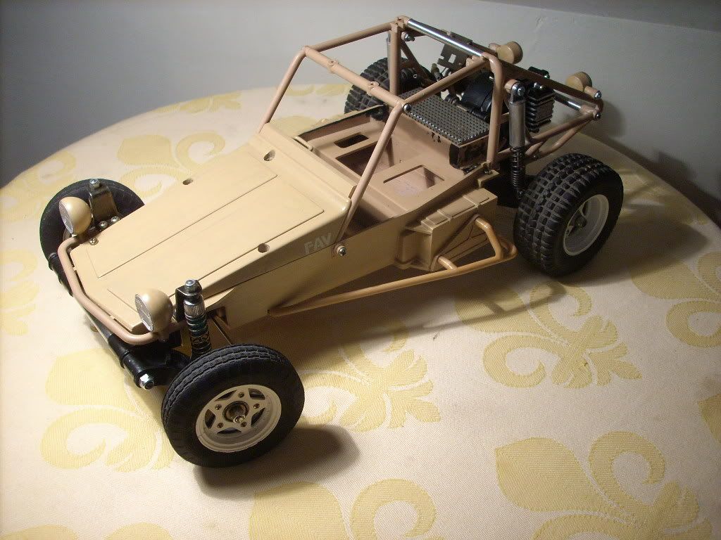

Well, the FAV restoration is now in its last steps. I can not do any more with this model because I have not found the missing parts (driver body and right arm, top parts of the box and the bit that goes on top of the rollcage, oh, and the M-60, too).
Tonight I finished the lamps. These are the wonderful reproductions that NZ's TC member Beetlelover has for sale. I would recommend these to anybody looking for replacements.
Anyway, here's some pics of my whisky buggy.
