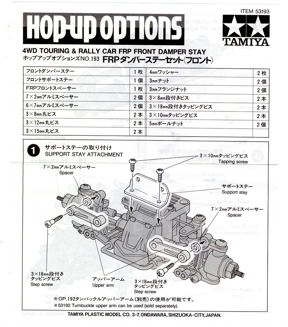

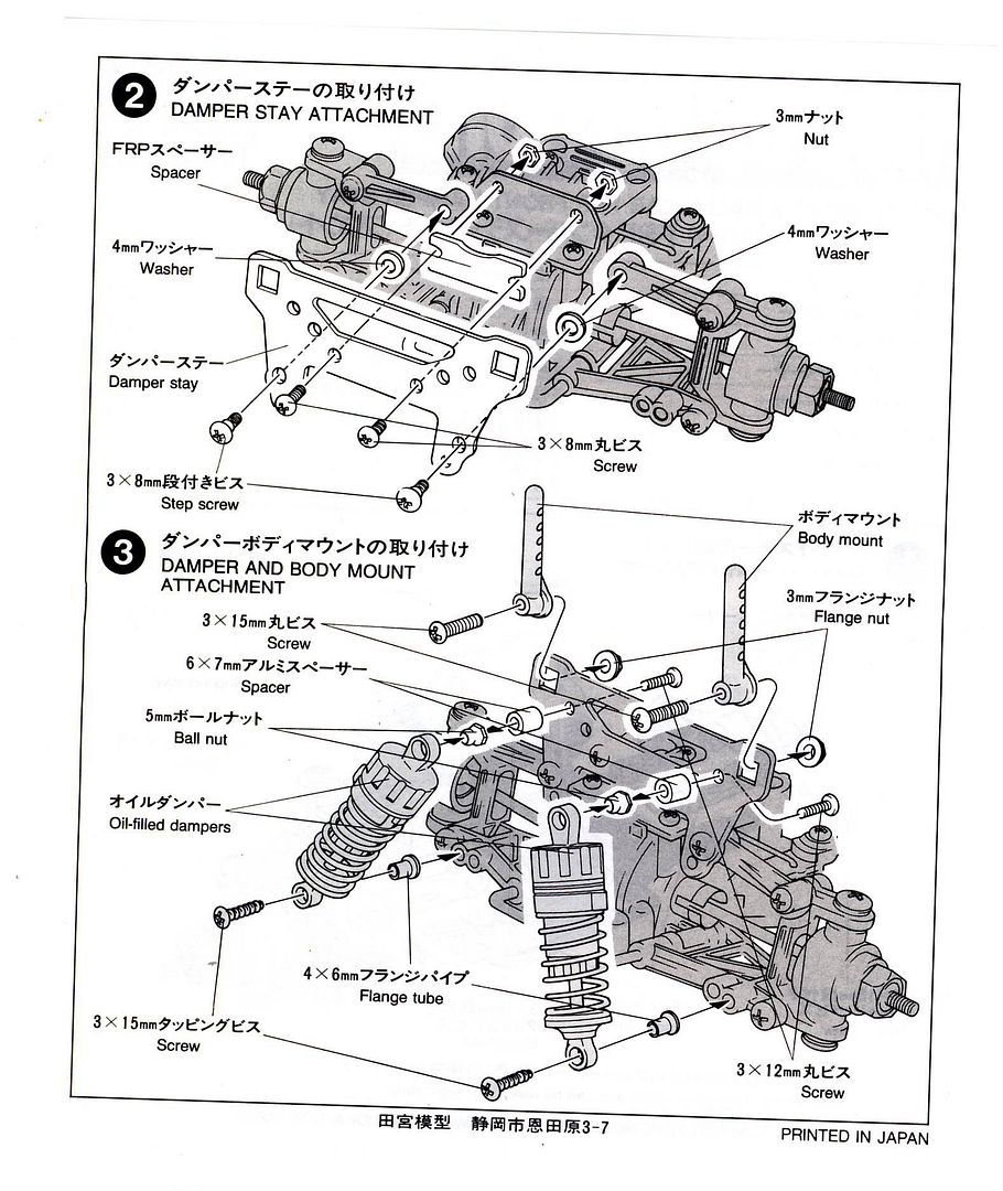

Tamiya's FRP towers come with the hardware to mount the solid upper links, as depicted in the instructions:
Many thanks OCD,ive always fancied a look at the Tamiya instructions for that exact part.through experience ive found Tamiya realy are "all inclusive" when it comes to their own hop up.
Due to the GPM and Tamiya towers always being shown in there packets,its hard to see if you get all the ness bits and pieces.
I know the Tamiya top link packet has the same set up..kinda special sized step screws to fit perfect thru the FRP and attach to the ball nut they supply.
The GPM towers (alloy and carbon/FRP) seem to have a bag of collars and screws? my alloy ones had screws and collars for the shocks only? perhaps their spec changes (luck of the draw) as to what comes in the pack.
