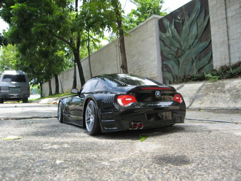

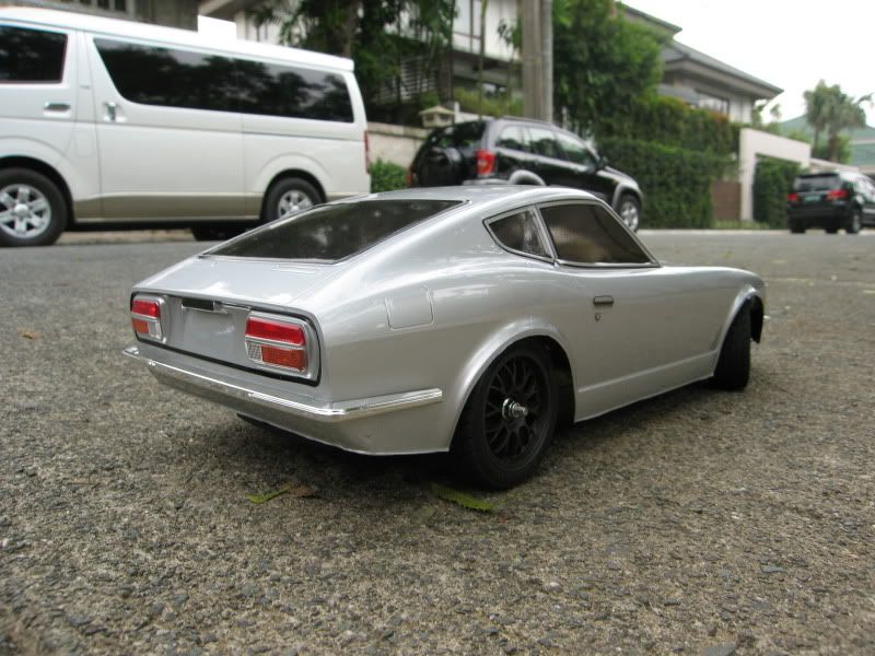

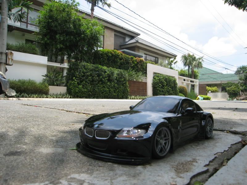

Fitting Tamiya shells made for the proper chassis like your lambo and TT01 Type E is pretty straight forward, drill the correct dimple guides.
Though I had the same trouble when fitting Tamiya body shells made for another Tamiya chassis, i.e. An enzo ferrari(TT01/TB02) to a TA02 chassis. They do not have dimpled guides on where to drill.
So what i now do is buy the ABC stealth body mounts: Here it is in my TT01D Type E with 240Z body and BMW Z4 M coupe body:
A sample video:
It does not only make mounting body post easier, the main bonus of the stealth mount is making your R/C look like the real thing!
And the body mounts are study, i have run my car hard without the body going off the chassis. Just don't hit something, for sure it will fly off.
