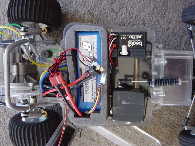

I ended up putting a Hobbywing Ezerun 13T brushless setup in mine with a nice little 2200mah Lipo. At first it had so much power it was undriveable but after changing the speed control setting, backing off the punch and timing it is now much easier to get the power down and still very fast.
Finally went Lipo man what a difference.
Recently did the same, awesome huh? The other day I stuck those lipo's in every RC I had/could, Now I have to buy some sub-6 size Lipo packs for the rest of my fleet :)
