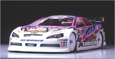

No idea who makes that body .. and as for "better", I guess at that level the low & sloping nose, small & low roof & low splitters & skirts would make a difference - as in maybe a few 1000ths of a second a lap ...
Me, I doubt I'd see a difference (aerodynamically anyway) between that and a shoebox ;)
Me, I doubt I'd see a difference (aerodynamically anyway) between that and a shoebox :lol:
You would be surprised. Even at club level with slow motors (10.5 brushless) having proper aero shells make a massive difference. Most use a variation of the Mazda speed 6 shell (protoform or HB) although the RF9 is great is you want lots of turning. The new popular shell is the Protoform LTC-R if you want a a compromise between the r9 and the speed 6.
The body affects how a car handles. Some body gives neutral handling, some gives better rear traction, some gives better steering (front traction), some are designed for carpet, etc etc. Some work better with wider body post
The bodies in question are Protoform LTC-R. This is the first body to ever beat out the Protoform MazdaSpeed 6 in a world level event. The Protoform lineup are pretty much the only bodies to choose from in competitve RC (as they work best). For 190mm rubber tire Electric competition racing they are as follows (listed from tight to loose):
- Mazda 6 (not widely used)
- MazdaSpeed 6
- LTC-R (modeled after the Lexus IS-F)
- R9-R (not widely used)
The standard Mazda 6 body yeilds very little steering. Its low front downforce can be used to calm down a twitchy car.
The R9-R body is typically unstable in competition. It is generally only used as a band aid for a bad setup (to add more steering).
PS: It looks like the standard Mazda 6 is discontinued now. They now offer the a new P37-R body (obviously modeled after the Infinity G37). Unfortunately I don't know where this body fits into the handling lineup...
Here is the link to the protoform 190mm lineup: http://racepf.com/touring-car-190mm/
