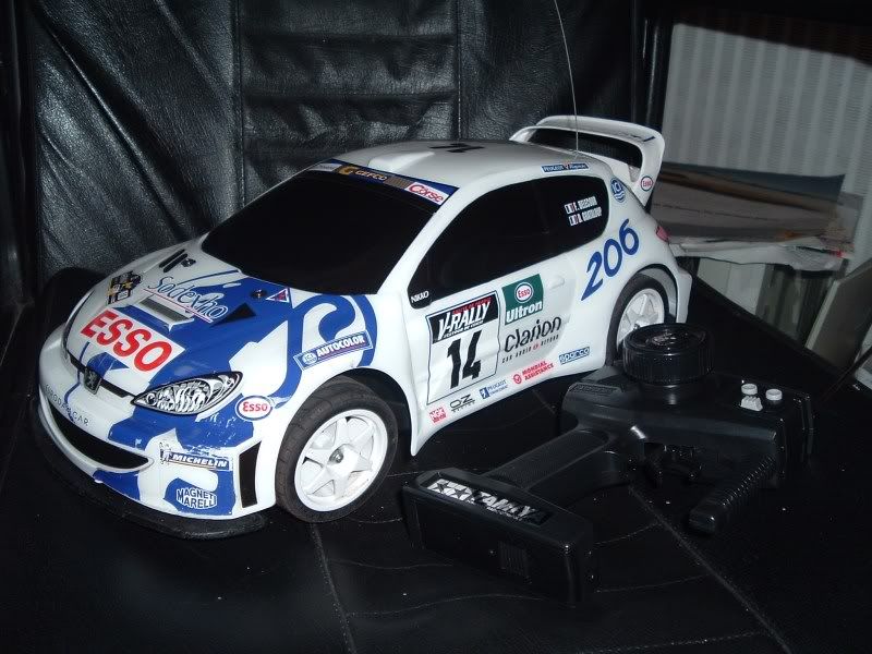

I bought a Tamiya RC car on the cheap (£3!) at a boot sale a few years back after seeing that someone on eBay was going to be making Metro shells (guess what car I'm into lol). It never happened and the RC went into storage for a while until I found out about these :D
http://cgi.ebay.co.uk/ws/eBayISAPI.dll?Vie...sid=p2759.l1259
But then I found a problem...
The one I have appears to be this...
http://www.anticsonline.co.uk/468_1_17570.html
Which is 240mm wheelbase instead of 257mm :( The guy on eBay reckons the QD is a stretched M-Series chassis and what I need is a T-Series... hope this makes some sense? I've had a look on eBay and it seems that you have to build these from scratch, including the radio kit etc?
So what I'm wondering is whether I can transfer all the motors, wheels, radio etc from the Pug and put it onto a bare T-Series chassis? Not sure how quick the one I have is compared to "proper" hobbyist-built RCs so any advice would be much appreciated :)
Don't want to spend megabucks on this as it's an on-the-side project really, what do you think is the best route for me?
Cheers :)

The QD (Quickdrive) series is only just a step above a radio control toy, not even up to the standard of an M-Chassis. Certainly not a hobby class radio control. The £3 you paid is a 'take it off my hands please' fee. :lol:
There will be very little from the QD that will be able to be used on a real hobby class RC.
The chassis under the body you have linked is a 257mm wheelbase TA02 rally chassis. I would use a TA02 or a TB01 as a rally chassis long before I'd ever buy another DF03.

£30 ish sounds OK if it'll be quicker and better than the current chassis I've got. The Pug shell seems to sit pretty central on the QD chassis so not sure if it will only fit other QD's?
The shell is in pretty good shape, no cracks etc and all the stickers seem to be fine as well :)
The pug shell is identical to the ta03fs(TA03 Front motor Short wheelbase) 206 that I have.
