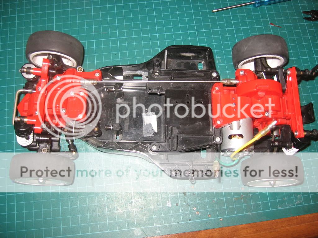

As Tamiya released the F-150 in Lexan on the TA02 chassis, I thought that would be a good start. After contemplating for a while how to tuck everything under the body (i.e. 'slam'), and almost buying SDI's negative offset wheels, I decided to try and use leftover M04 arms I had from my M04-to-scorcher conversion. A bit of elbow grease and a lot of trial and error later, the chassis is ready.

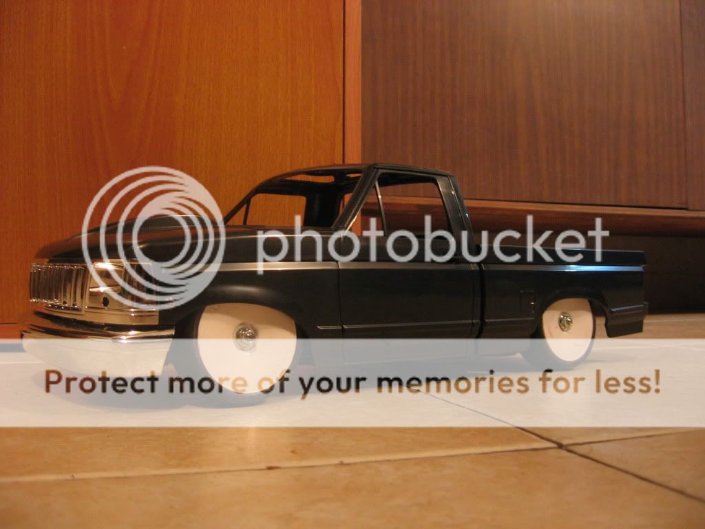

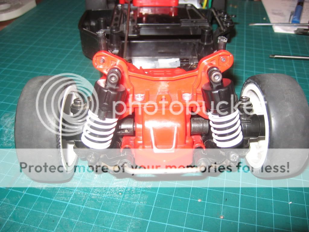

Almost touching...

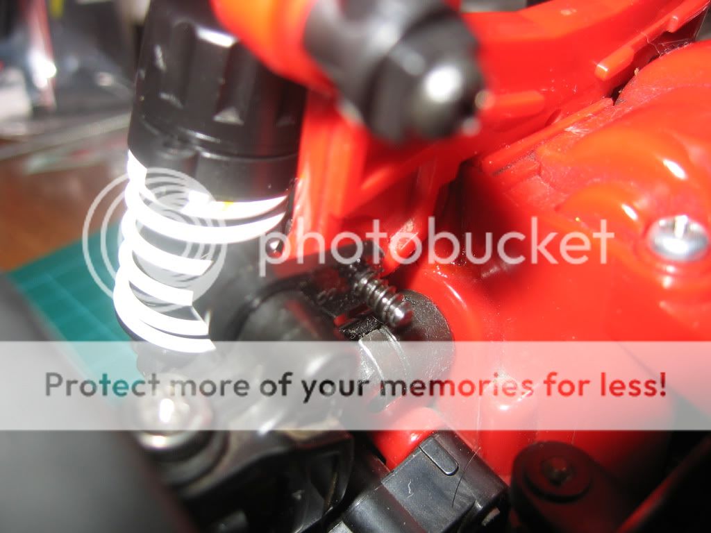

Used servo horns as upper arms

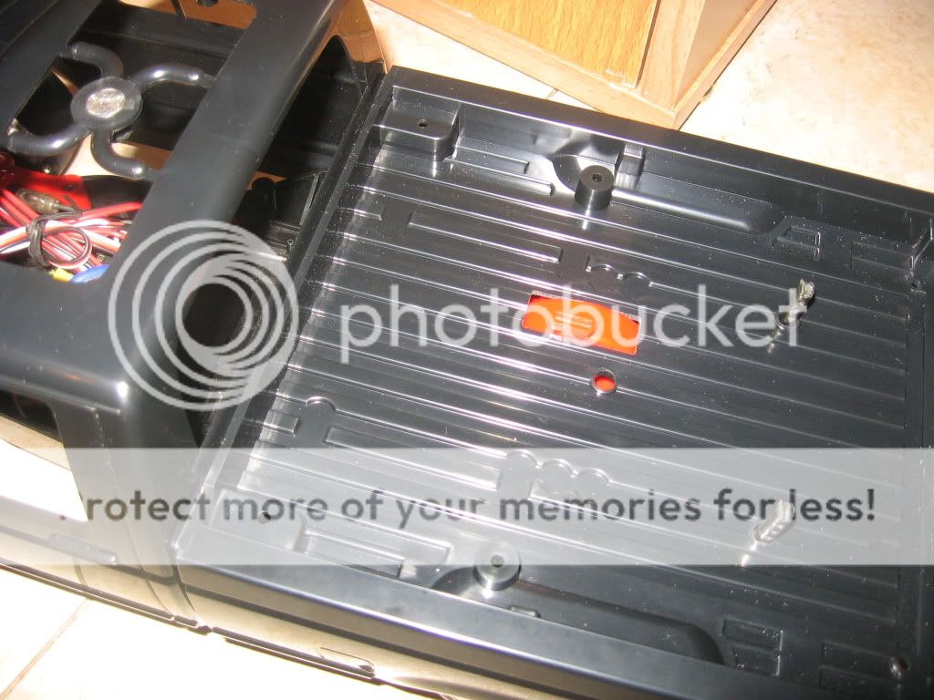

After sorting out the chassis, fitting the body was the next challenge. I managed to do that be cutting the rear shock tower and opening a slot in the truck bed for the spur cover (which obviously coudn't be cut). I'm hoping the paint would help conceal that. I'll be changing the wheels as soon as the new ones arrive.
Like it. Had you thought about making a cover for the rear bed like you often see on these kinds of custom trucks? That'd also get around your exposed spur cover problem.
i was just about to suggest the same thing - a custom smoothed bed that you could drop in as a cover

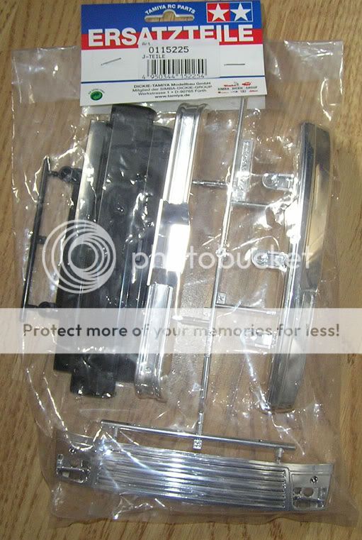

I was scratching my head over how to make the front grill look more like the real truck, until I realized that the King Blackfoot front grill is a direct replacement, and with its horizontal mesh it's far more appropriate than the Extreme's vertical mesh grill.
The problem is that I can't seem to source this part anywhere - PLEASE HELP!!!
