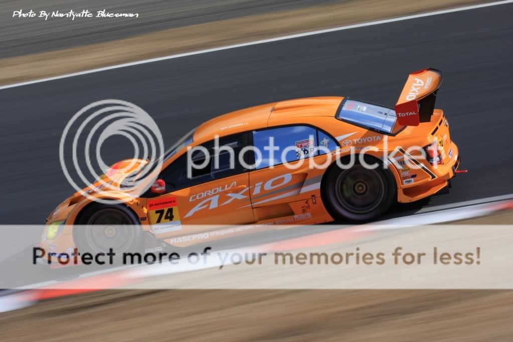

Tamiya says to use Camel Yellow PS-19,that is the box art color,but it is the wrong color for the real car. I have the body painted usig PS-19.
I believe you could pull that colour... Lamé Flake backed with the right yellow.
Check out my showroom for the TA04R in there. That's Lamé Flake over (or under, in truth) fluoro orange. I'm sure with a bit of experimenting it can be done.
