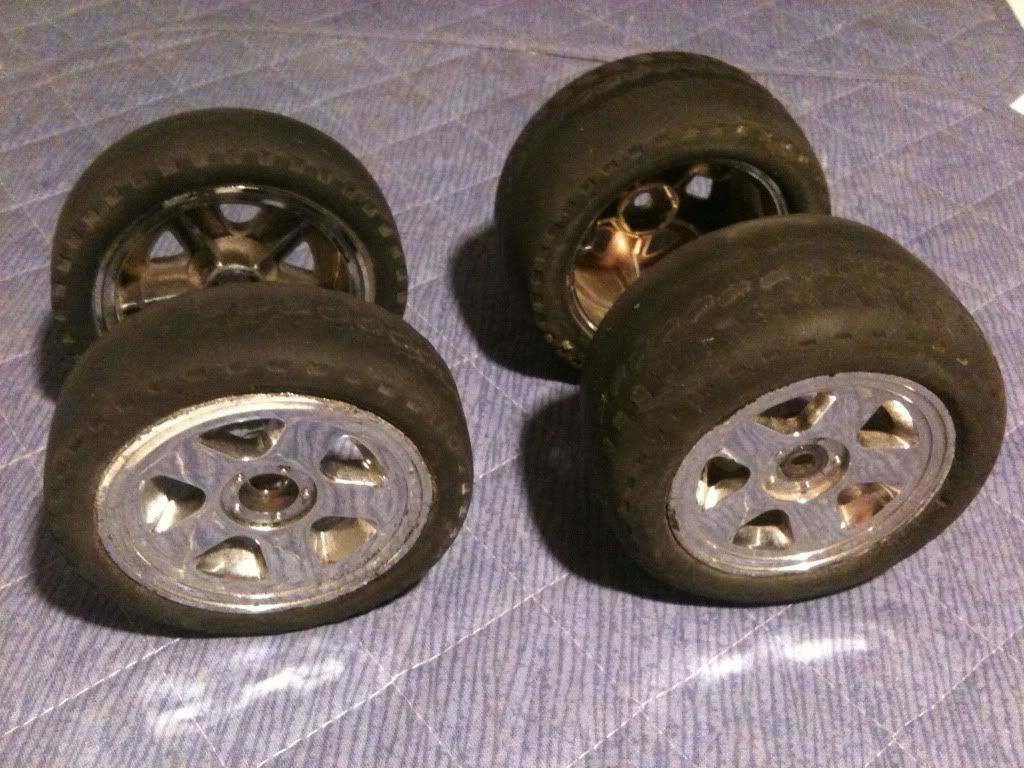

I've tried the Carson wheel/tire combo extensively. They provide good grip on tarmac, concrete, and carpet, but wear pretty fast. I have run both the black ones and the chrome ones. I managed to break the rim edge on all off the black ones into fragments - Somehow the chrome ones held up. Maybe because I ran them in a softer environment :-) The front rims have a good, tight grip on the bearings unlike some of the Tamiya ones, where the bearings rattle around...

What tamiya did you run those rims on?

I and my son ran the wheels on DT02 / Desert Gators.
