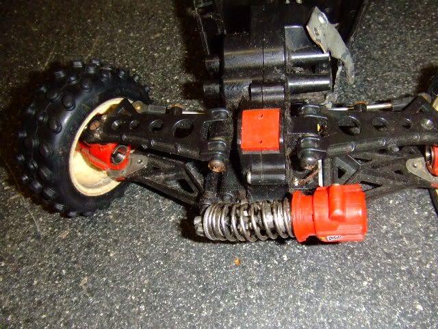

Oh boy what a mess :o - the front end looked 70% correct, the rear about 40% correct and the middle, well lets forget the Falcon chassis tub !!
Stripped it down to realise the job lot of builders screws holding 'it' together were right through both front and rear gearbox cases, one metal bevel gear in one 'box was sheared and chewed up, the nylon spur in the other 'box had a screw through the outer edge ! Nothing that can't be replaced :rolleyes:

So here it is as it arrived.. will put some more pics up once the recovered parts are cleaned up...
Plenty of parts on the way :( , gears, ball bearings, shafts etc - the wishbones are about the only black plastic parts that won't be replaced !

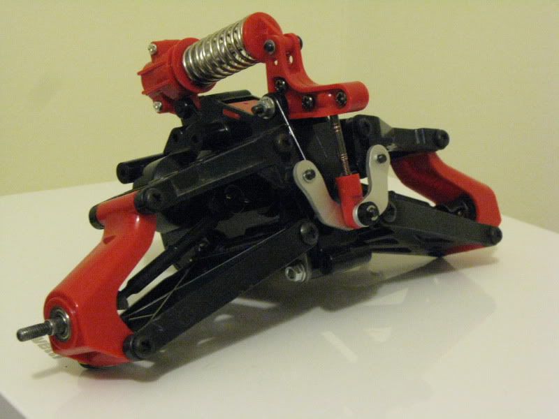

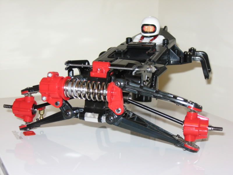

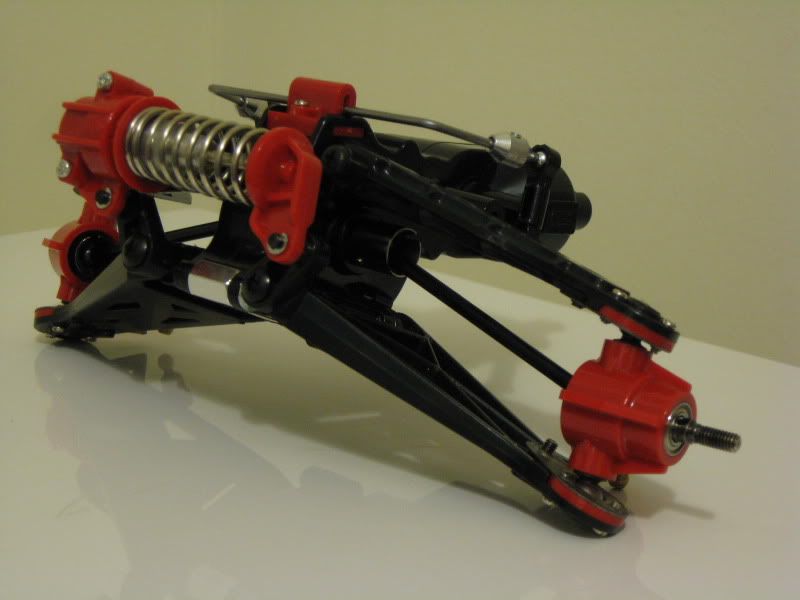

Front end rebuilt - i think the only original parts are about half the gearbox internals, the propshaft coupling, the drive shaft couplings and the upper and lower wishbones. The rest has been replaced with original or rere parts.

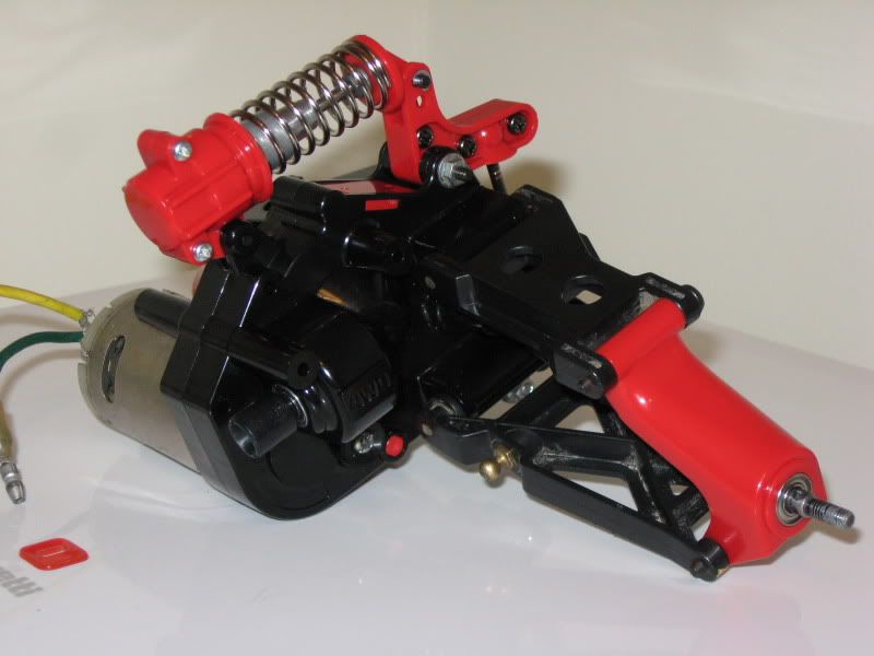

Rear end partly rebuilt - as per the front, only original bits are a few internals from the gearbox and the propshaft coupling plus upper and lower wishbones !. Still got the stabiliser to fit, held up as the ball connector bag i bought only had 2 of them (should have been 4 !). Fitted the original 540 motor it came with, but might swap this for a new Ansmann 21T or 23T as they are cheap and i ahve one in the Manta Ray and it goes well enough for my driving talent in a 4WD buggy.
I've put the hop-up rear suspension to one side, and built new monoshocks for front and rear using the new original hotshot metal cylinders, inner parts and springs coupled to rere plastic end caps, filled with Schumacher 60 silicon damper oil.

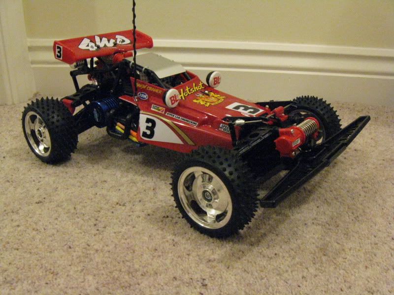

The green never happened, nor the union jack decals - went boxart, but with an EZRun 4300kv (9T) brushless motor/esc kit.
finished with the original wheels resprayed in silver/chrome..
with Seben Racing wheels/tyres (£18 a set)..standard 12mm hex drive, so swapped the triangular wheel adaptors fro 12mm hexes
Still have it, its covered all of 100metres since it was 'restored' lol!
