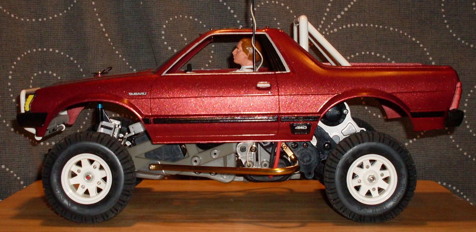

I am wondering if anyone has tried this before and how it will turn out..
I was doing my Christmas cards last night and a lot of very fine glitter came off all over my keyboard and it looked really good. I then got to thinking..
If I spray paint my new Sand Scorcher body and then cover it lightly with the super fine glitter and then spray the lacquer. Do you think this is worth a try or will I end up wrecking a body?
