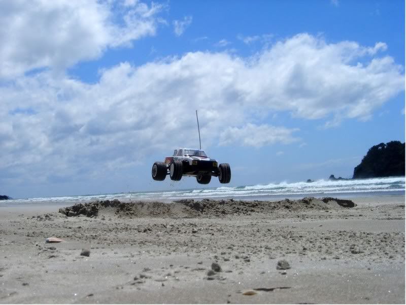

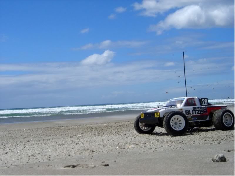

Sorry, love these pics so had to share :)
Those pics are awesome Berman. Thanks for the reply guys I was looking into getting one of the two when possible.
