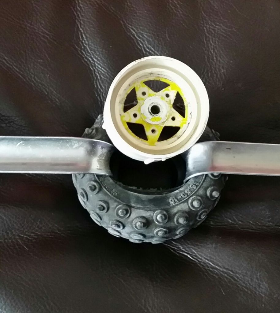

I used two metal ladel handles with curved ends for hanging up. I then got someone to stretch the tyre by hooking them in either side of the tyre and pulling it open. The wheel slipped into the tyre really easily then.
