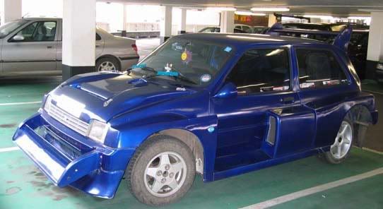

Got my TA-02 chassis through and put the 6R4 shell on but for a while couldn't figure out why the rear wheels were sitting so far inside the shell... almost looked a bit like this!
Looking at it more closely the rear wheels are set more into the car than the front and looking at a lot of RC car pics the rear wheels are wider than the fronts (so the rears look a lot more dished from the side)
My chassis looks pretty much the same as this one just with different wheels on...

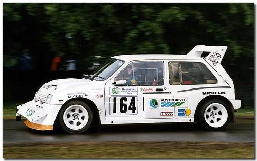

Where do I get sets of matching wheels with standard fronts and the fatter rears so I end up with a normal looking car that should end up looking something like...
(looks like fat rear wheels on that as well)
