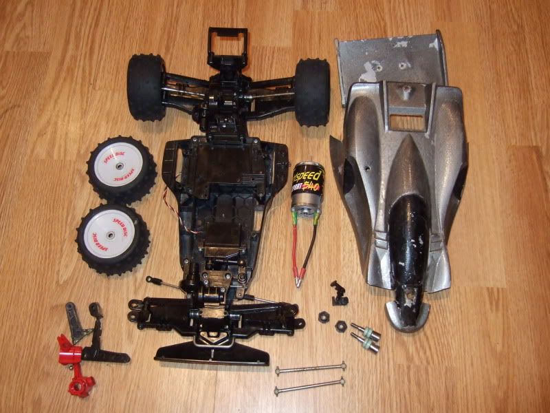

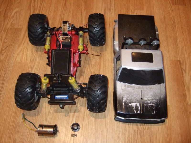

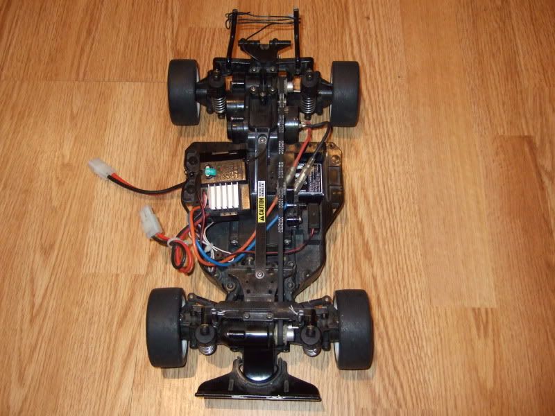

Here's the current collection in it's sorry state:
The Porsche
The Blackfoot
The Manta Ray

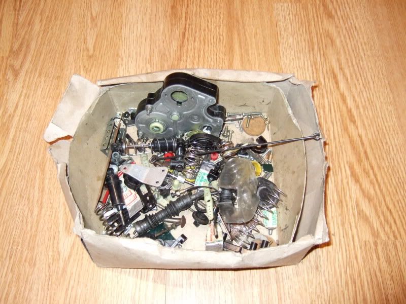

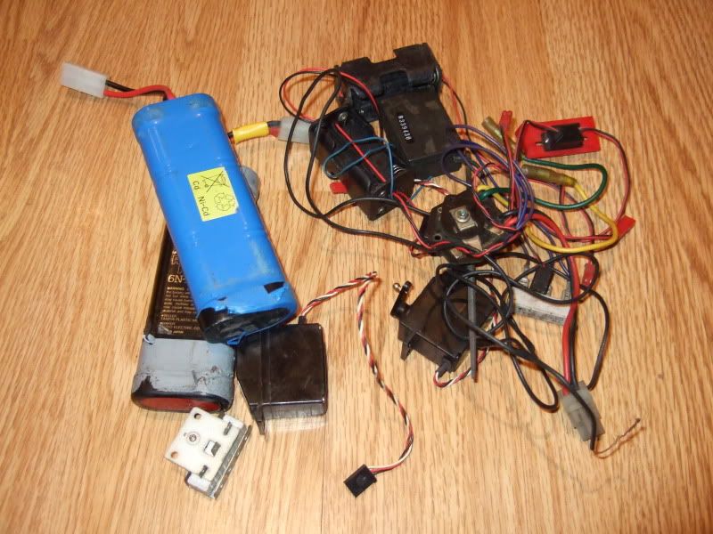

And a collection of random bits
I've got my work cut out but I think I should be able to get everything working and looking good again,
