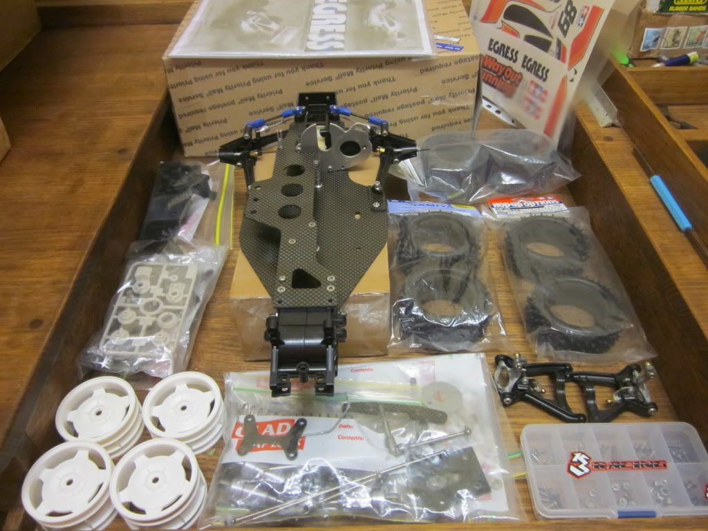

Here is a snapshot of where I'm at right now with the build. Most of the chassis parts are saved or new. I will definately be running this...gently.

Thanks to the recent Egress/Vanquish threads I got Eggy out of the box for a butchers. Now I've decided to use as many of the original to car parts and build it as a runner first. All the extra plastic from Avante 2011 can be used later when Eggy retires.
All the mechanicals are original including bearings and all but a couple of screws. Non original parts are wheels, tyres, body, decals, rear gearbox covers and the front cross member (front hinge).

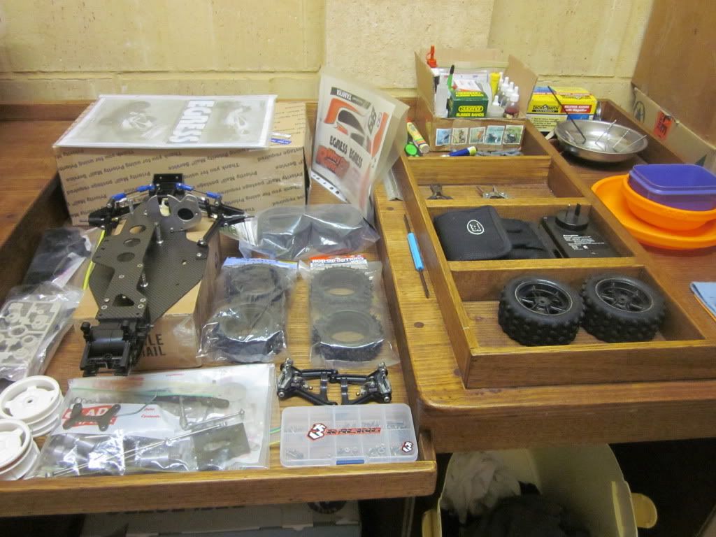

This is my work station.

When I stripped it down, the front cross member which is meant to be two piece was in five pieces. A friend is making me an alloy replacement which will kick start this project again. Then I can start thinking about which motor/esc and radio to run it with. All suggestions welcome.

Got it yesterday. Thanks to Hux Sr for the awesome job, built from scratch. Machined from aluminium billet, just check out his work on the front hubs (magic).
