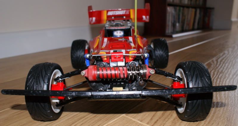

....and this is what your car should look like at the front end.
Thanks, the pic really helps, I wasn't sure what part of the B tree was used:
Makes more sense now, short shock 80mm right?
Ben
Ben
Yep, Hotshot 2 & Boomerang used the short 80mm CVA at the front.
