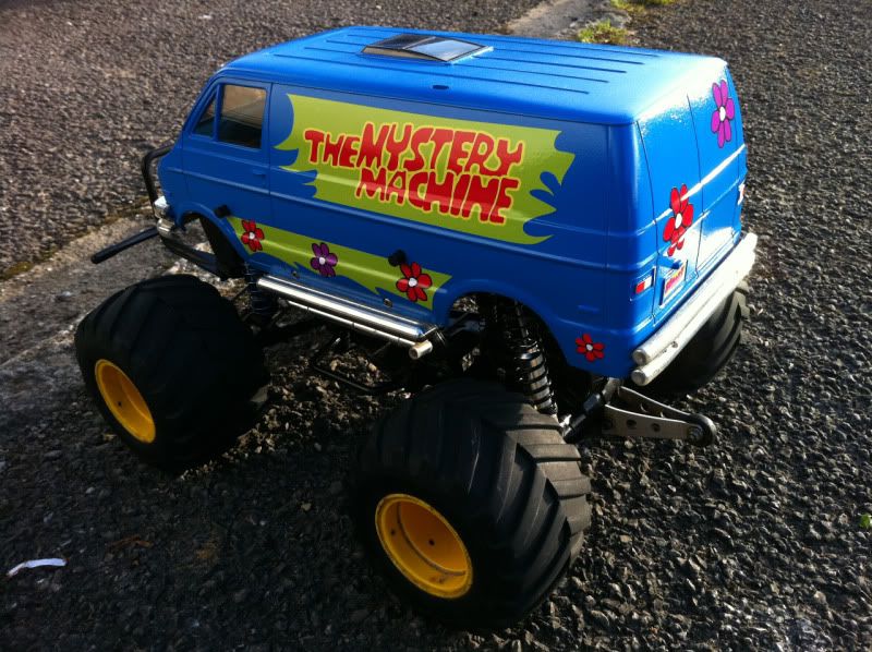

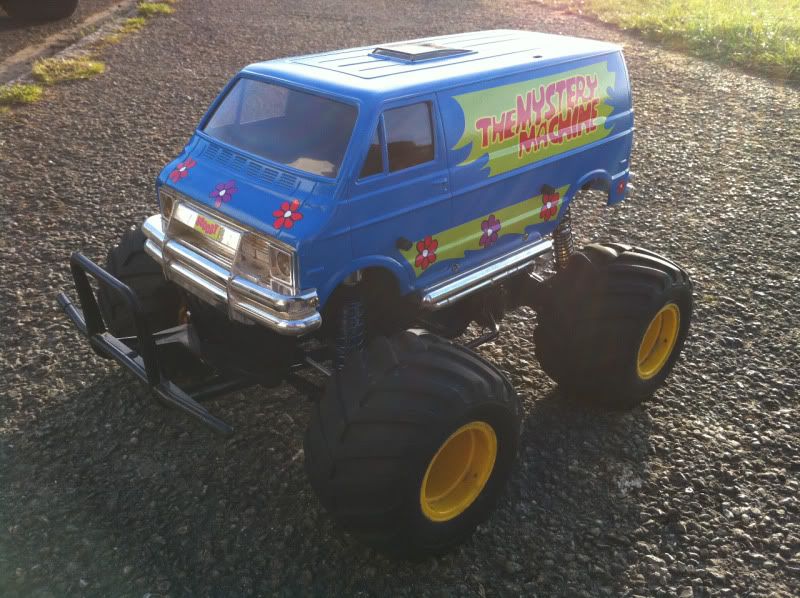

My original Lunchbox had got a bit tatty, decided to tart it up a bit. Fitted new chassis, shell, window glass & new dampers.
FX10 front arm mod. I also moved the steering servo into a more central position.

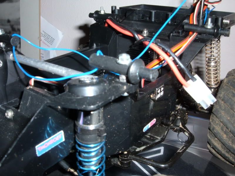

Front strut brace to stop chassis flex.
The body mounts had snapped ages ago, found these much tuffer ones on the bay

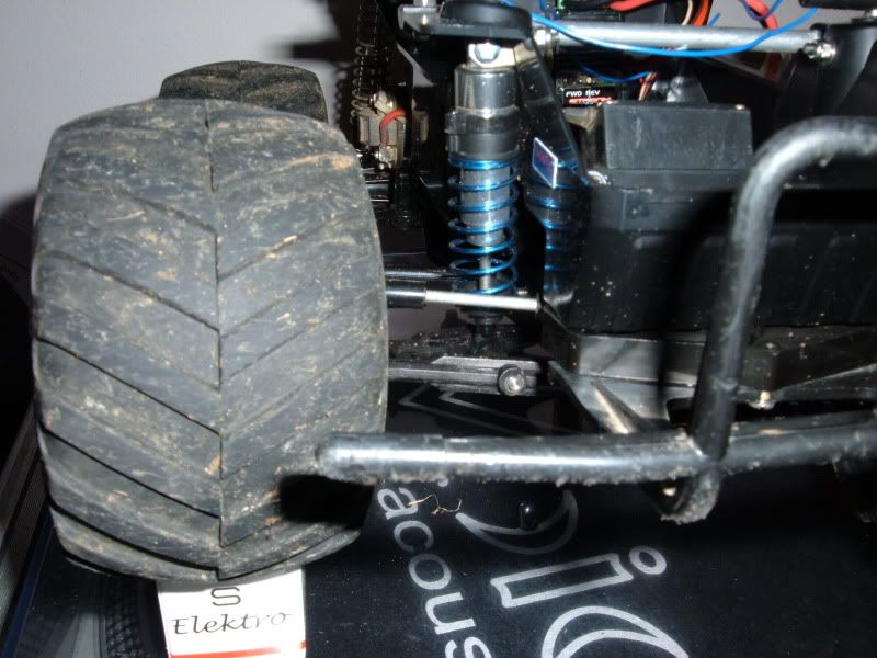

Third shock mod & oil filled dampers all round. Kept the stock rear springs to keep the back end as soft as possible.

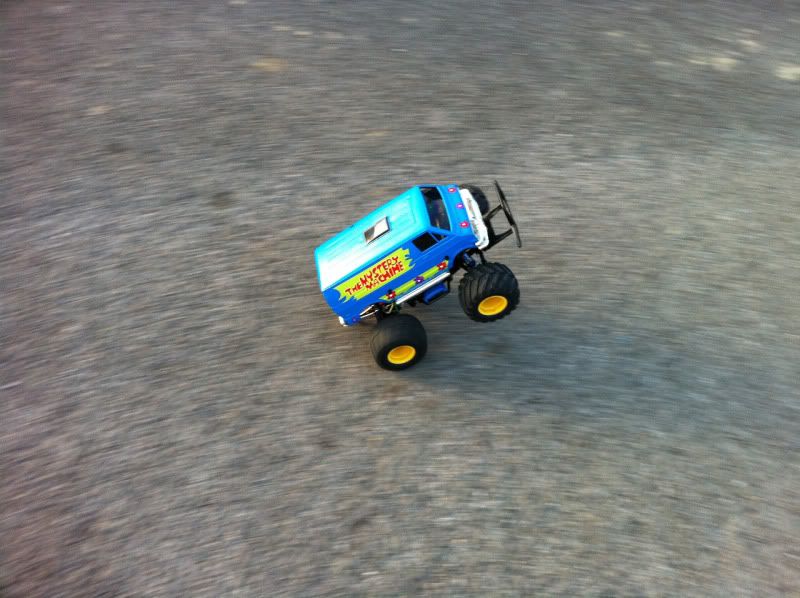

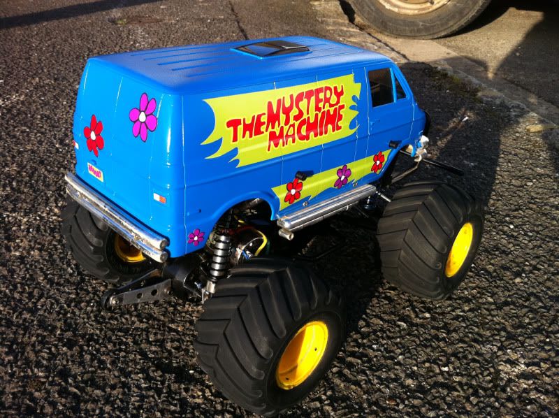

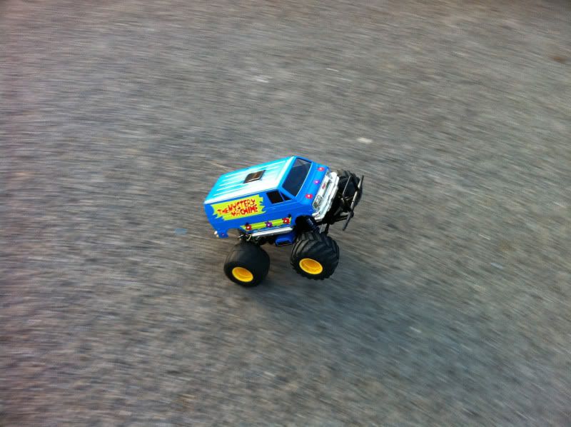

Few pics of the first run out.
In the past with hot motors I found the Lunchbox was getting broken all of the time. I decided to go back to a silver can to reduce the damage. Wasnt quite enough wheelies for me so I have a vintage Yokomo motor in it now, no idea of the spec but the performance seems smilar to a sport tuned.
Big improvement having the double wishbone. You can actually turn at speed on tarmac now without rolling the car over, obviously the handling is still comical but its probably as good as a Lunchbox can get.

I'll try & get some better pics from the underside of the Lunchbox.
