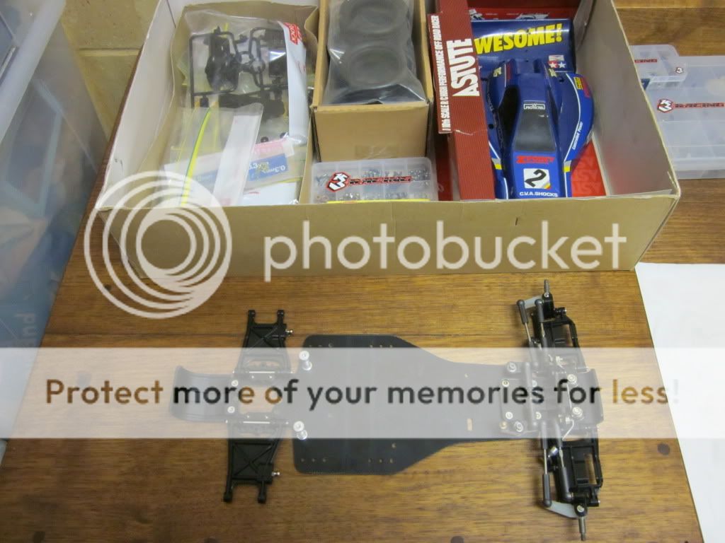

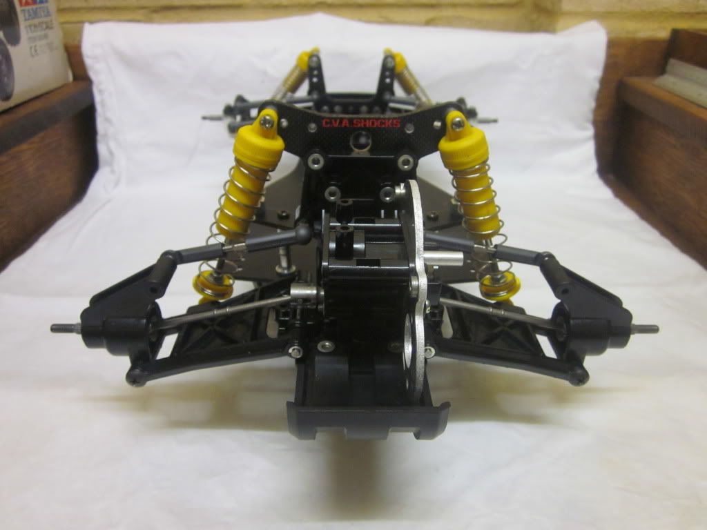

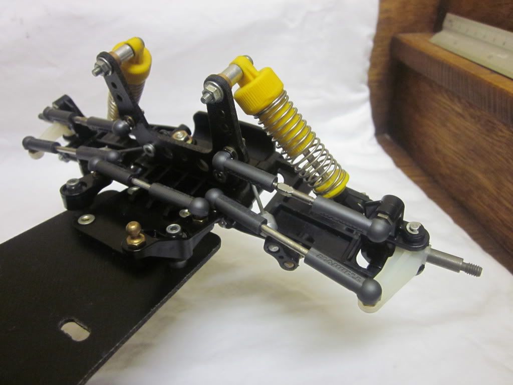

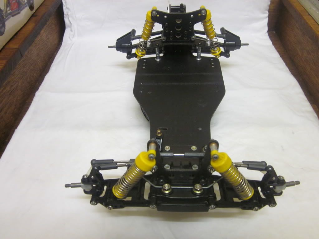

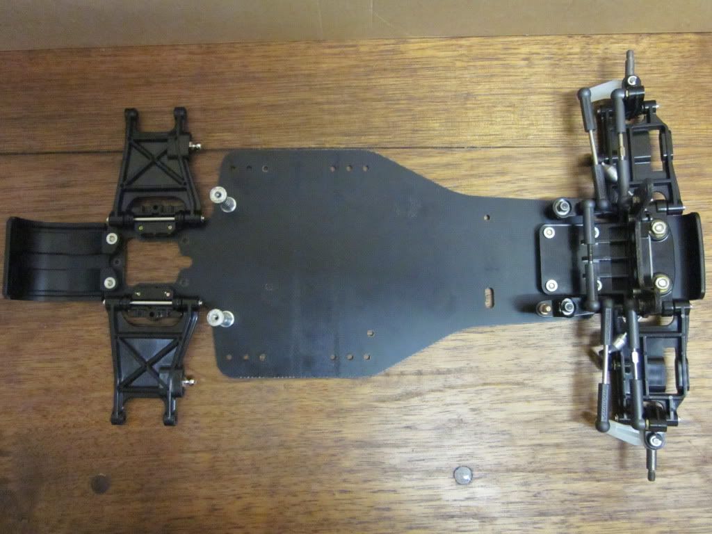

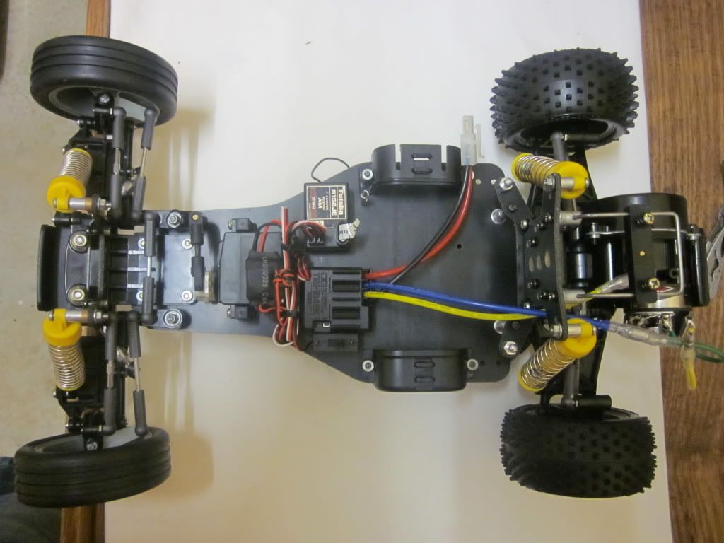

Here is where mine is at right now. The suspension and uprights are Madcap, the steering arms are from Super Astute (cut down and then shimmed), new turnbuckles and TRF201 ball cups and then ball raced original steering. Still plenty of work to do. Comments welcome.
Currently I am waiting for several orders and some billet parts. This means more time on TC and not much progress in the shed. At least some kind people here have introduced me to image hosting and my camera.
This is for anyone who is interested. There seems to be a few Astute fans out there! ;)

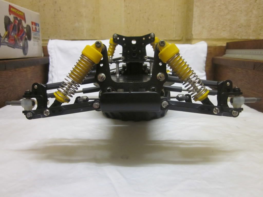

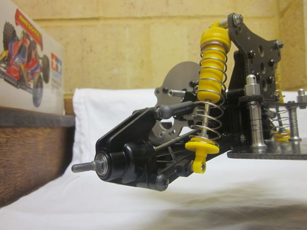

Hi guys. I am doing the Madstute hybrid conversion right now and I have just fitted the Madcap arms and hubs. The rear arms and hubs are a direct replacement. The rear arms can be fitted to either the Astute rear arm mounting blocks or the Madcap ones. I have fitted my rear arms to the Madcap mounting blocks (these appear stronger than the Astute ones) using longer 10mm x 3mm countersunk screws. Should you choose to fit Madcap front suspension arms as I have, there is a couple of tricks. The Astute front uprights foul on the arms and hinder droop so can't be used. I have used the Madcap uprights however the Astute steering arms are too big for these. I chose to trim down some Super Astute steering arms however the other option is using the Madcap steering arms. (I found some on-road arms that worked well also, just not sure which model they are from). The Madcap front suspension arms also have a smaller gap where the front shock is mounted. You will have to use something alternative to the original Astute which has a tiny sleeve with a ball in the centre as this is too fat to squeeze into the gap. I used a pivot ball from DB01 suspension. This just popped straight into the lower eyelet on the front shock and was fitted with two 3mm washers. The upper mounting point for the front shocks also needs to be spaced out from the tower an extra 3mm (I just used one of the left over metal bushes and some longer screws). DB01 shocks are also a direct replacement so some of these or some 3 racing DB01 shocks are a good option. The upper suspension links are replaced with modern turnbuckles, ball connectors and adjusters. I hope this is helpful and feel welcome to PM me if you have any questions.
Got the madcap rear wishbones and hubs on mine now - just need to dig out the article on how to put all the upper links onto the hubs - first glance says i need something more than the bits that came with my Astute.

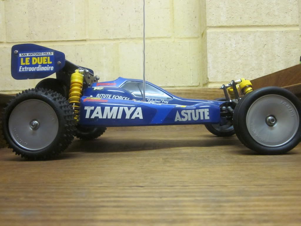

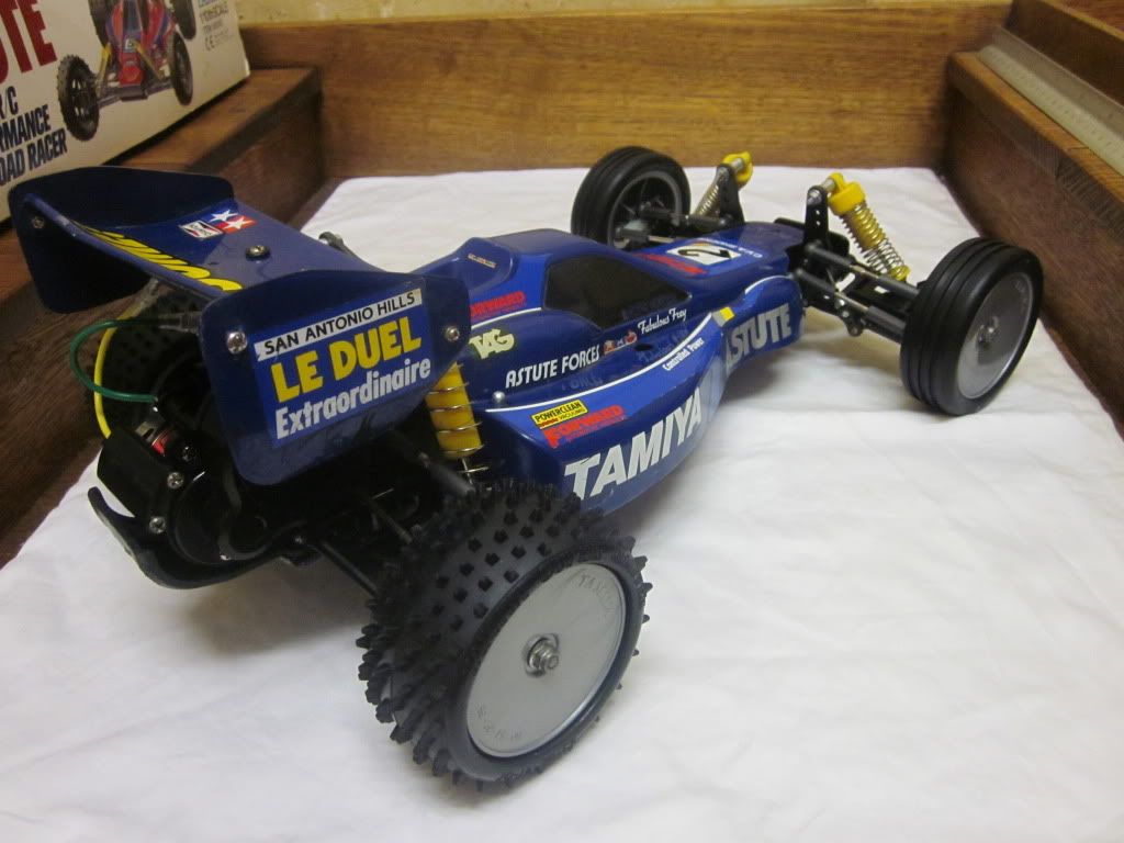

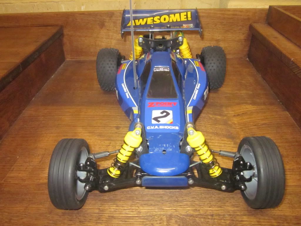

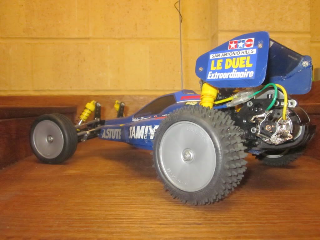

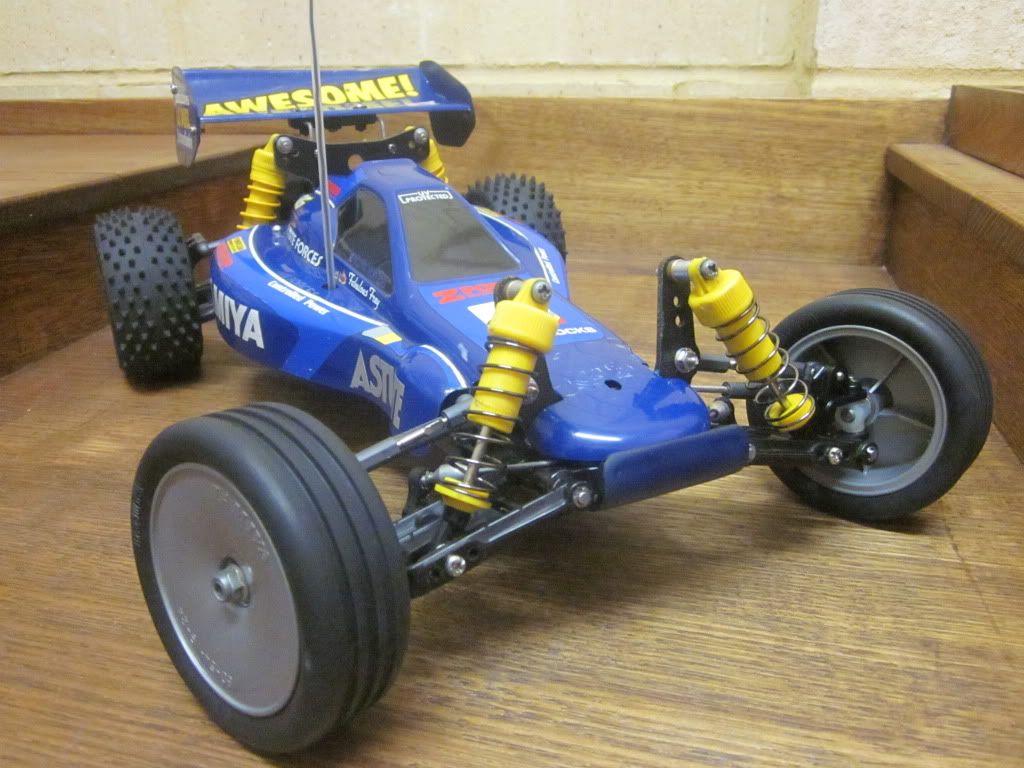

I haven't yet bought a new body for this car but I just couldn't wait to run it. I patched up the original body, fitted a GT Tuned motor, TEU104BK speedie with added UBEC and standard am radio. I'm stoked that I chose to run her before she was finished because it went great, the body stood up and I can get some enjoyment out of it and set it up in the mean time. There was plenty of nostalgia on the shakedown run as it's mostly my original car and original body re-run after being MIA for over 20 years. :) Shakedown only saw it needing a spring change with front softer/rear harder, a few screws tightened and a washer to stop the servo saver from popping off.
The front toe out is exagerated in this shot, I actually ran it close to neutral! Also which LiPo packs fit in this carrier?
Pre Shakedown
Post Shakedown

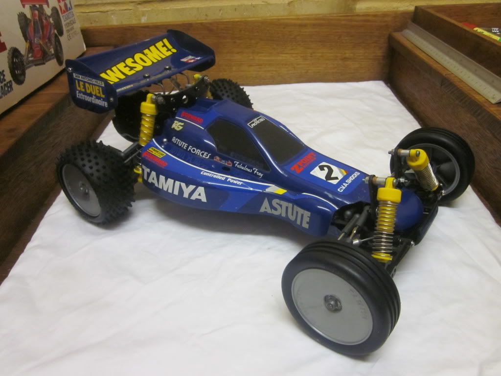

I will definately paint up a display body and maybe change dampers, just which colours and which dampers? I have thought about fitting springs from the DF03 spring set to the original dampers, does anyone know if that will work? All suggestions welcome, specially body colour and decal combos?
Very nice work, looks great even with that body !

Keeping those wheels on it? I say Orange/Silver combo.... Sorry I just think those two colours work well. :)
Nice build BTW.
Thanks guys :)
Orange/silver with these wheels and some hi-cap dampers would look sharp. I've already got a blue body so I guess orange is a chance!
I would also like to see this with ps4 blue, ps41 bright silver (silver band on the lower body and wing sides), yellow Holiday Buggy 2010 wheels and tyres and the yellow dampers. At the moment it's likely to get the black CVA dampers from my DB01 or 3Racing DB01 dampers for running. A pair of DF03 rear wheels fitted with dirt hawgs isn't out of the question either!
I would like to keep the yellow CVA dampers on her if I could get the spring rates spot on! Can anyone chime in and let me know if those DF03 dampers or springs suit?
I still have the original wheels too for the true Tamiya vintage look.

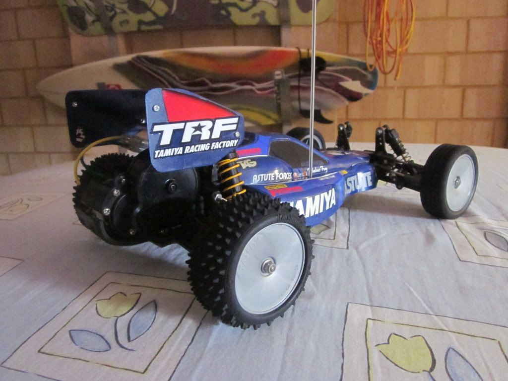

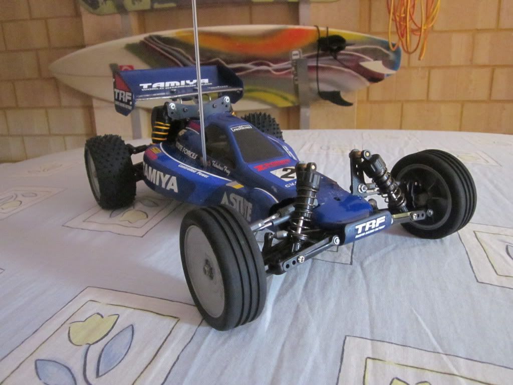

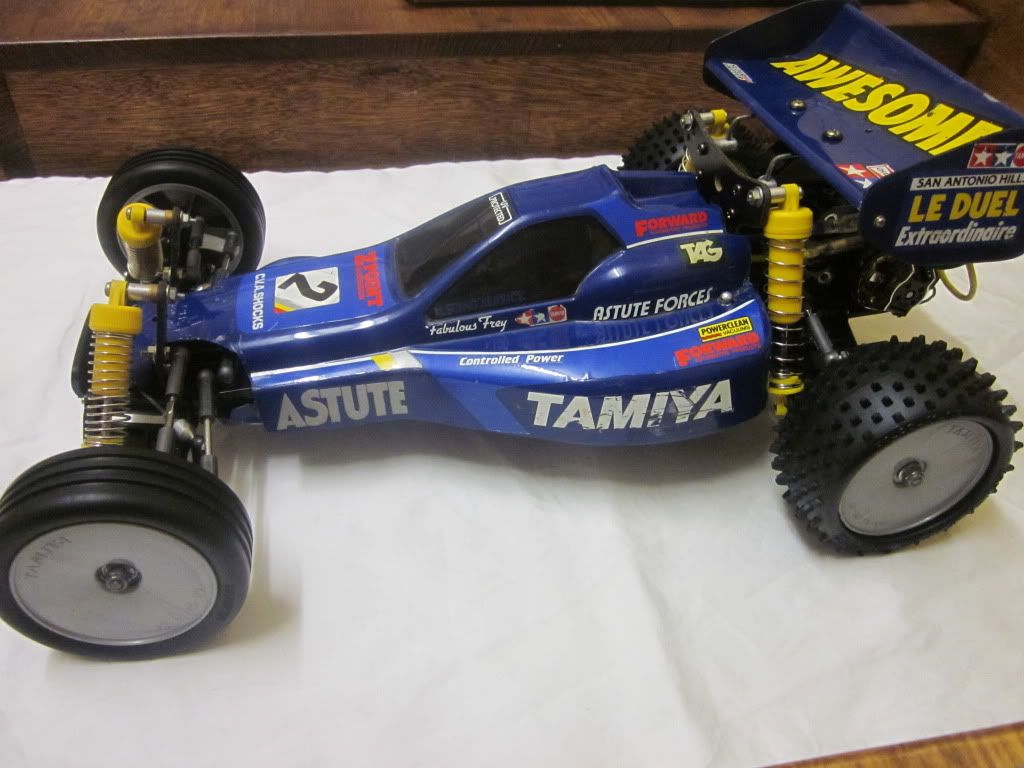

I went with the DB01 dampers, the rear needing some very hard truck springs from a friends spares box. I had a spare wing so just couldn't resist a TRF theme. This could easily handle brushless power and the reduced weight of Li-Po batteries would do it a real favour.
I had to go back to the original rear upper susp links for strength. The lighter set up suffered bent screws holding the inner ball connector.
I'm really happy with this set up and will run it like this for a while.
One of my boards is in the background because the surf was ripping today. The Astute is coming to the beach with me next time :lol:
