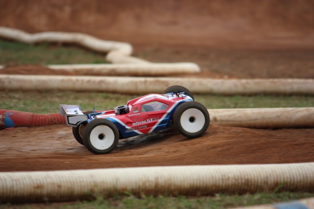

I tend to mostly back them with white, coz my white stripe causes it (see attached) I also use this scheme on my Nitro cars without any trouble. If you want to back it in black, I would go white first to keep the colours bright and popping.
