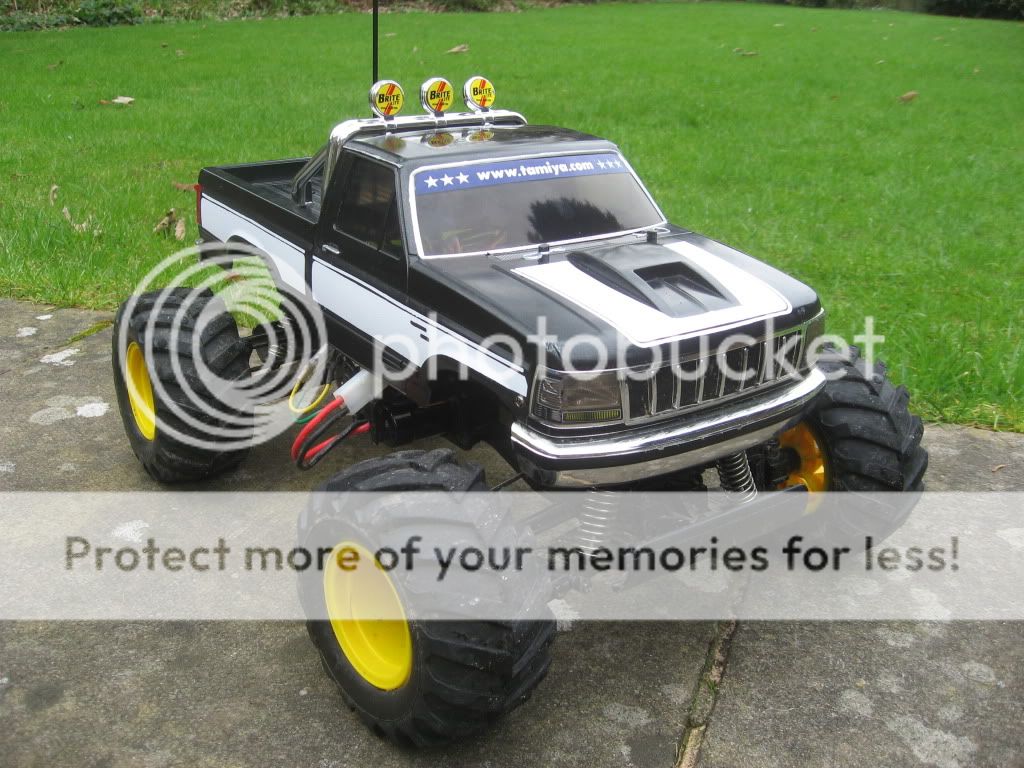

This must be catching as my blackfoot is doing the same thing, it is only going about 30 meters and then will usually turn left or not respond to ant control input from my transmitter. I am running it with a 104 bk esc and a new acoms receiver and although i have not cut or trimmed the antenna in any way it does look a little short. I wonder if it is because I am using a Futaba transmitter.
Does anyone know if you mix brands with Transmitter / Receiver combinations if you get a decreased performance.
I also have put new batts in the transmitter and fully charged the 7.2 and upgraded to a 2400ah. The tamiya esc is also brand new.................strange must be catching amongst the xtreme blackfoot owners club :lol:
I will have a play with the radio gear and let you know my findings.blackfoot001.jpg
Changed my receiver over from acoms to futaba and used my futaba transmitter. Result................No more problems...so conclusion. Dont mix transmitter / receiver combinations.
