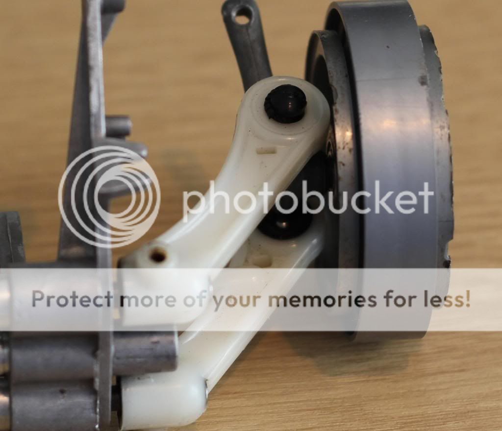

Not hijacking (I hope) hopefully helping to illustrate...
The O rings are they readily sourced today? Is there a good replacement, does anyone know how stiff the rubber was?
O-rings can be easily (i think) found, i have some of them and i'll take the correct size for you. Anyway in the past when i was after them i used standard tamiya shocks O-rings and they seems to do the job.

I'm back with some info as promised.
In the picture below the comparison between the original 3mm shocks O-rings (organge one) and the RCH ones for ball cups (Black one), measures as follow:
Tamiya Shocks O-ring (3mm):
Total Diameter: 6,5mm
Internal Diameter: 3mm
Height: 2mm
RCH O-ring:
Total Diameter: 7mm
Internal Diameter: 4mm
Height: 2mm
I think that with a little search should be easy to find some rubber O-rings similar to RCH ones.

Perfect, picked some 4mm inside dia, 2mm thick black o rings up off eBay.
Thanks for the help
FWIW I ended up using 3mm inside dia, 2mm thick. These worked better than the 4mm ID. Thx again
