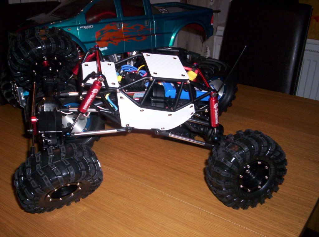

Finished the build yesterday - wrestled for 2 hours with the screws n bolts for the side panels B) , thankfully the top panels went on in a couple of minutes ;)

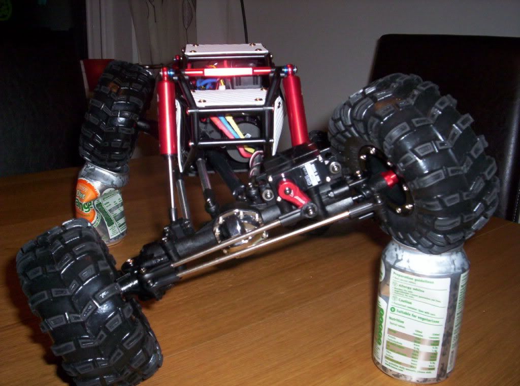

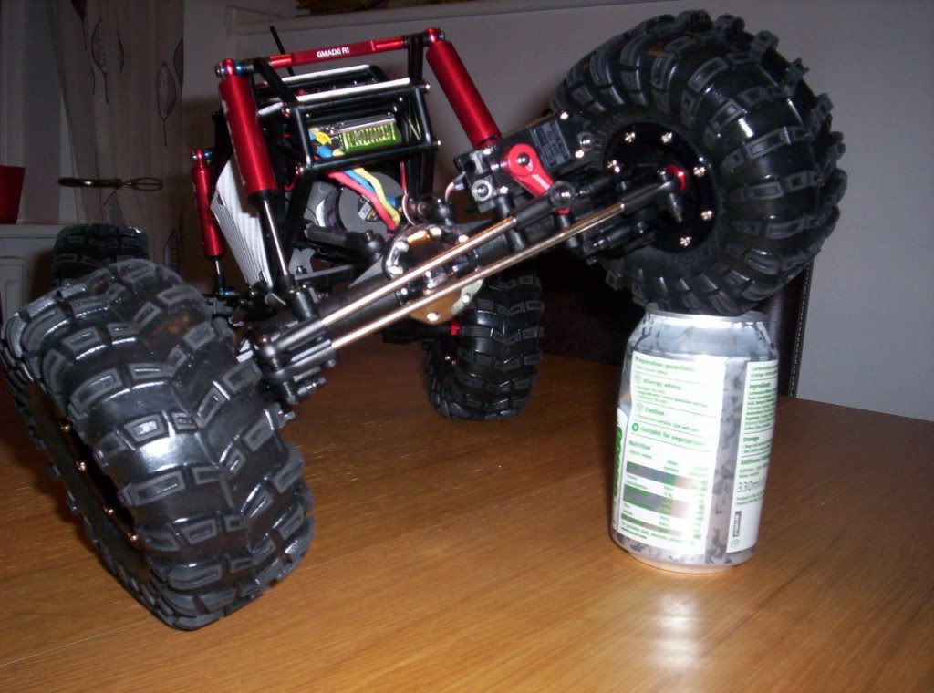

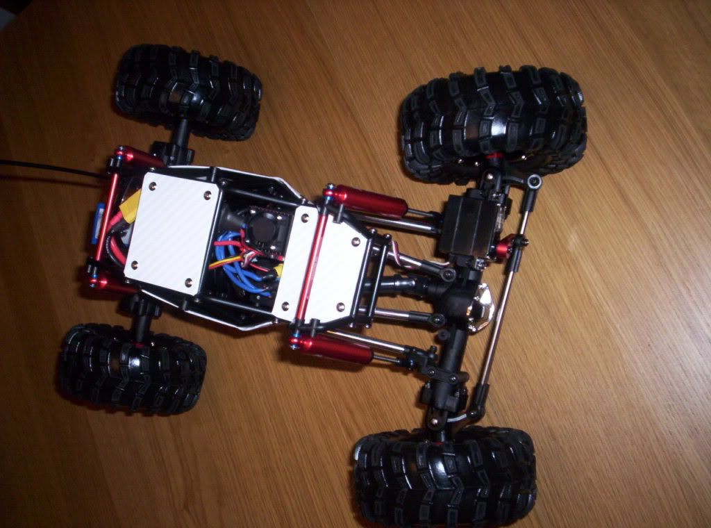

So all ready for its first outing now, a few pics of the finished article before i trash it :o

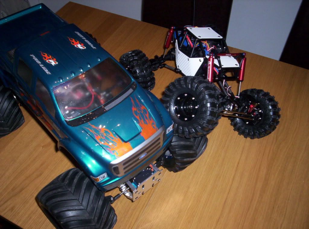

..and duelling with its big brother (Gmade Spider conversion for Clodbuster)..
Hop-up parts are..
13mm axles wideners
Shock tower braces
Answer RC servo arm (bit of bling to match the shock bodies !)
As this isn't going to be a crawler, I used some Fastrax 50wt silicon shock oil rather than the supplied thin Gmade stuff - the shocks have a firm abut progressive action so should be reasonable good for handling at speed. And so far there's no signs of any leakage from the shocks, that other R1 owners seem to suffer.
Current power train is a Hobbyking 45A ESC powering a Hobbyking 3980kV brushless motor with 16tooth pinion via a 2S lipo pack. I'd have preferred a 12 tooth pinion, but the motor shaft is 5mm, and a 16 was all i had in the toolbox at the time.
I cut my own body panels from styrene card, using the original lexan panels as a template. These have been covered in white carbon fibre look fim, just to have something a bit different. I have seom black CF film too, so i'll probably make up another set. Not sure what to do with the lexan panels yet, need to think of a colour or theme.

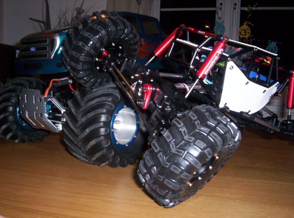

A few poser pictures from earlier....
