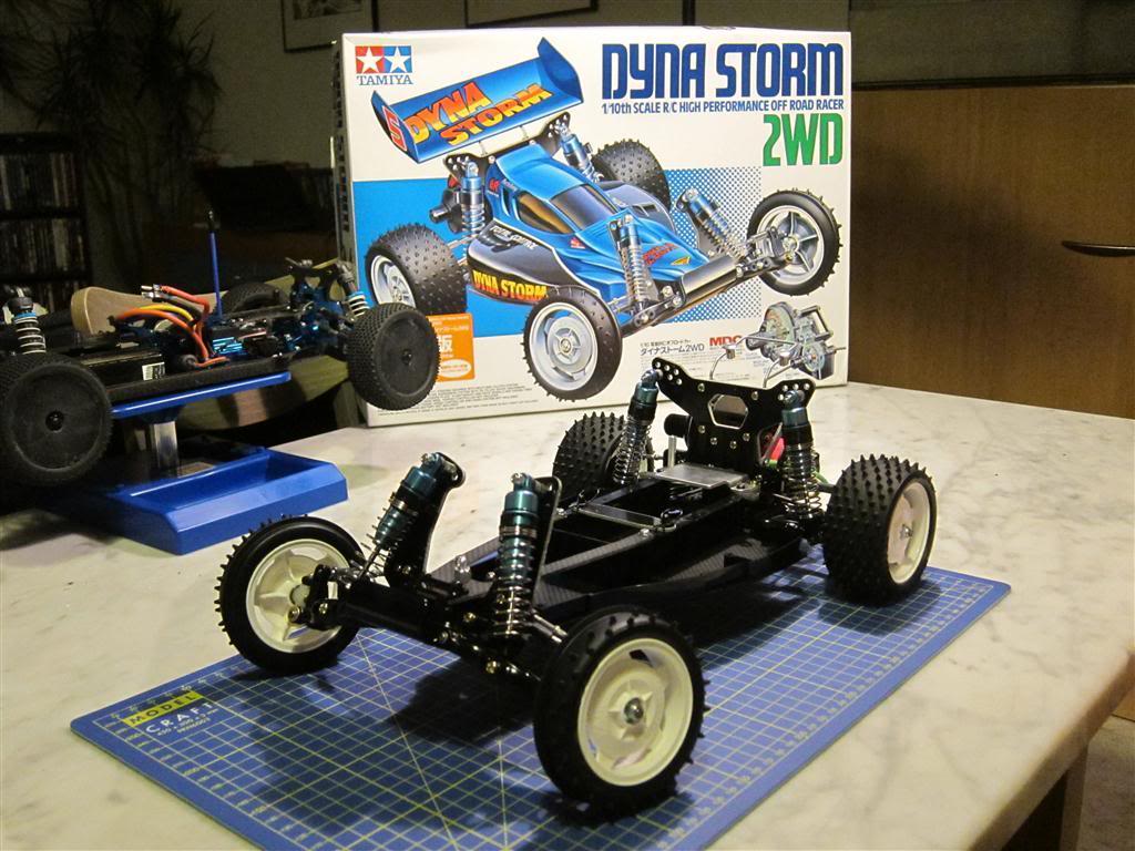

It's finished now so I though I'd share.

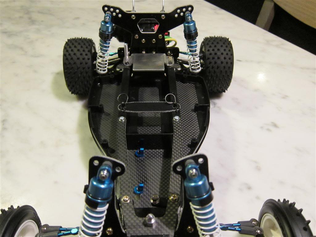

This is the first one I've owned and have pined after one for a while. I was lucky, shortly after I got the NIB kit I found the elusive Tamiya lower carbon chassis - part 4025036 (thanks Paul!) as well as the other two original Tamiya carbon parts (easier to find). You can see the carbon weave through the windows which is nice, it looks quite different from the FRP parts. It's using blue Ti turnbuckles and white TRF springs and it's got a Grasshopper driver's head in there too.
The body has just been prepared, painted and finished by Schaumat here on Tamiyaclub (Showroom: Kokuzu) and it's absolutely fantastic, I can really recommend his work and I'll be using him again. He helped me understand what needed to be done and then the best way to do it, his rates are perfectly reasonable and his service is top shelf, thanks again! B)
This one's for the shelf, wish my photography was as nice as the car lol.
Thanks for looking, hope you like.

You built it with std tb's first and then replaced with the blue ones later? You're dedicated!
Would you mind listing the blue tb part no's for others?
The DS cult continues!! B):););)

@Singapore_959 - Yep, I built it close to stock first because I'd never built one before and wanted that experience. They weren't too hard to swap out. :)
Turnbuckles
42118 - 3x32 TRF Blue Ti Turnbuckle - Servo - direct replacement
42119 - 3x38 TRF Blue Ti Turnbuckle - Rear Upper Arms - direct replacement
42120 - 3x42 TRF Blue Ti Turnbuckle - Front Upper Arms - direct replacement
42121 - 3x45 TRF Blue Ti Turnbuckle - Front Steering - 5mm shorter than the kit part, too short for a runner I think, fine for a shelfer
