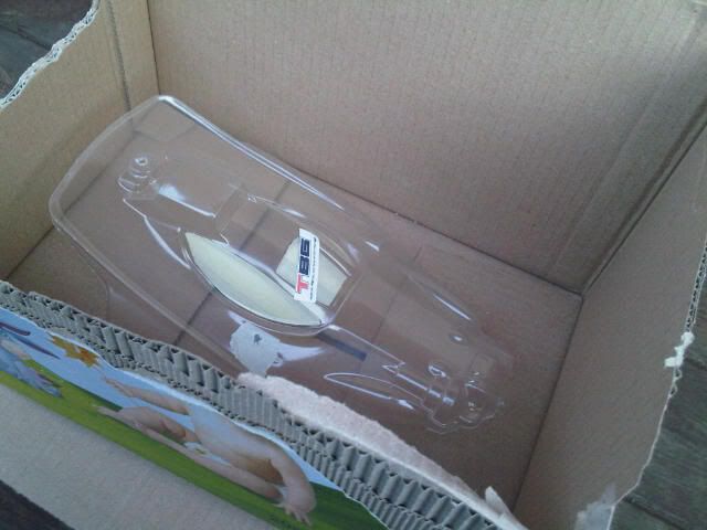

also how good is the repro body

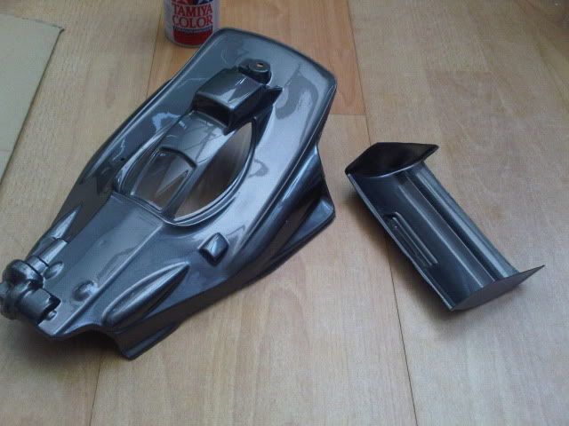

Body has been trimmed and washed, had to slightly adjust the drilling point for the aerial. It's now ready for paint.
Semi- professional spray booth :blink:
Sent from my White BlackBerry® 9700 wireless device
Painted. PS-23
I removed the protective film on the wing, masked the front and sprayed the back, had me confused for a while :unsure:

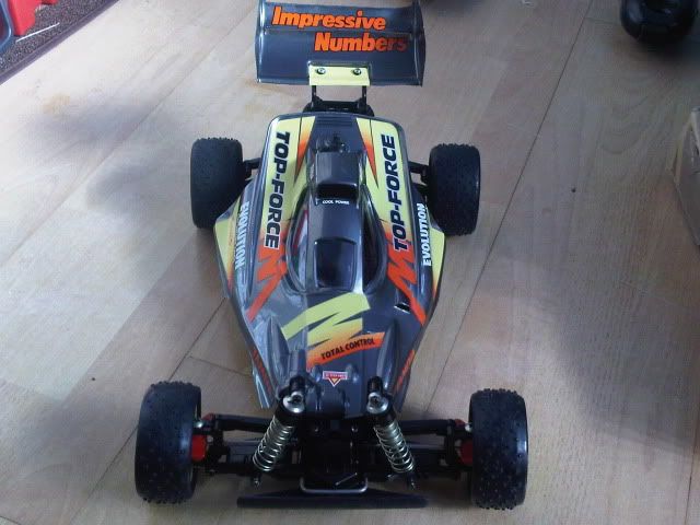

Paint job and decals completed, and it was a bit of a nightmare in all honesty.
Took a long time to do, I used most of both decal sheets due to making mistakes, and there are still a couple of creases here and there.
Project isn't finished yet, new wheels and tyres are required, and will probably upgrade the suspension if I find something suitable.

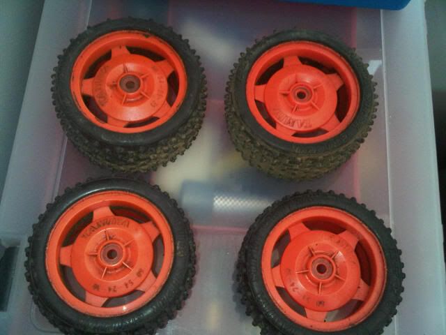

Been advised that Normal TF Star dish wheels can be sprayed PS-24, might give that a go as I can't find the orange DF-03 wheels anywhere B)

Picked up a Terra Conqueror yesterday, so gonna use the wheels, motor, bb's etc on this project :blink:
Just remember to use the other parts that are std on the evo & TC like the 6mm rod ends and ball joints, adjustable upper arms and steering rods, pins in the suspention arms, hollow gear tubes, Uj drive shafts, hard diff joints etc etc
