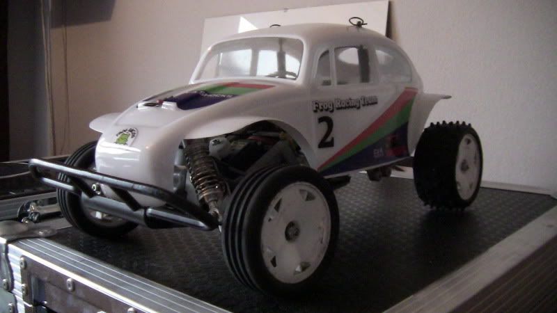

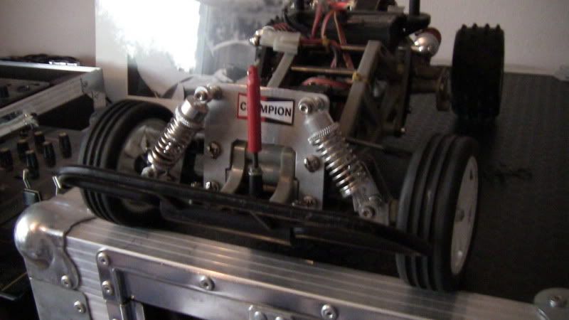

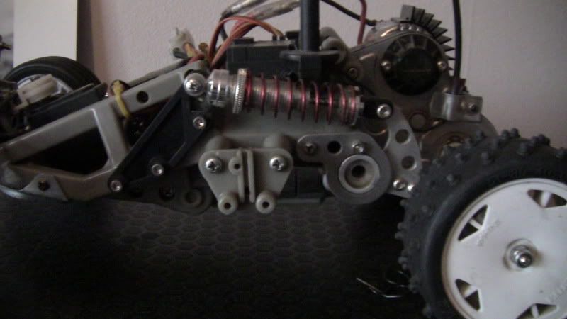

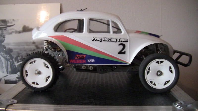

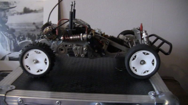

Here's some pics of my upgraded Baja Frog.
Home built front shock tower & unknown dampers from the bay, CRP front bumper & heavy duty rear shock mounts, Yeah racing rear dampers with the softest spring set, .50 cal alloy rear arms & Super stock RZ with a steel pinion.
I moved the steering servo into a more central position & fitted some thicker steering rods. Also fitted the 12mm hex adaptors to alow a greater choice of wheels.
I'm going to have a go at making my own allot nerf bars & maybe rear cage, just to finish it off.

That looks right good. I am going to stick the servo in the center as well because it is just such a stupid design being at the side like it is. I like your shock tower, I almost started building one but managed to get a hold of some CRP shock towers (thanks shwng1973 :lol:). Good luck with the nerf bars and post up some pics when it's done.
