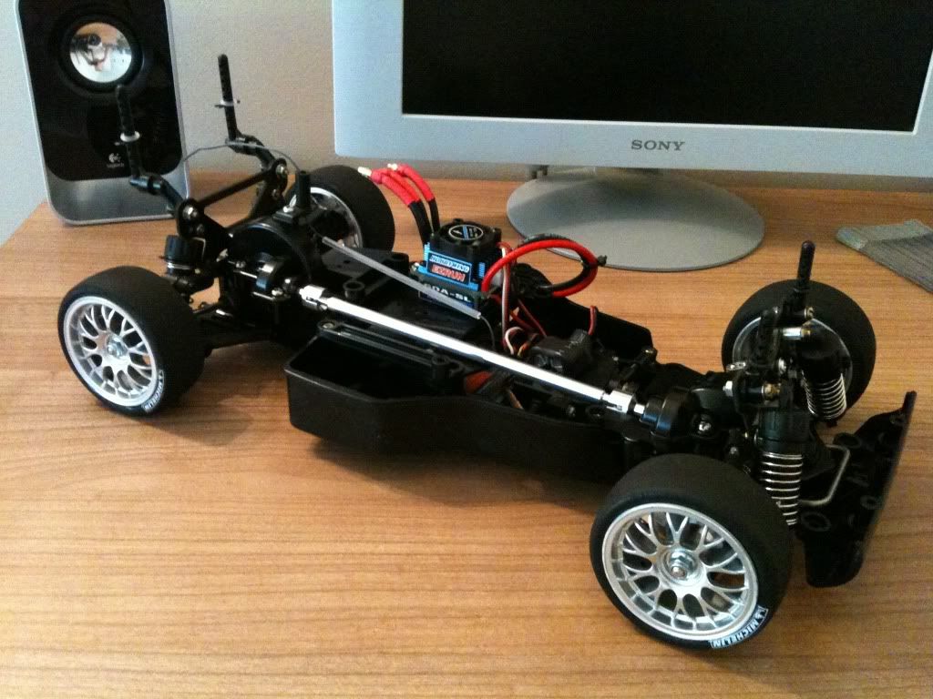

Cheers for the nice replies guys. <_< These are what I ordered.. http://cgi.ebay.co.uk/ws/eBayISAPI.dll?Vie...e=STRK:MEWNX:IT
I was looking at the alloy steering parts as I notice a little slop in the steering. I am also tempted by the carbon chassis decks, but havent seen the battery holder anywhere. If I could find that I might go ahead and get the carbon decks. I replaced the rear gear casing as the other had some damage to it. I think I will end up replacing the front case also as it has faded and looks a touch orange in comparison. If I can persuade the missus to come along next time I run the car I will get some video of it in action. Cheers, Dan.
I thought you'd ordered new steering arms, lol. I managed to take out most of the slop in my steering with new balljoints, cups, and adjustable turnbuckles for the upper arms and steering arms.
The best, and simplest mod was to put a small foam disc under each ball cup to keep a little pressure on the ball and socket. It's worked a treat and there is still enough play in the linkage for it not to be twitchy when I drive it.
Whoops, I meant front knuckles.. <_<
Thanks for the advice.
It works under the tie rod bar too, this is where most of my slop was. I cut up an old tyre insert between two bits of paper in a hole punch. Feed a couple of the pieces on top of the arm when you thread the tie rod on, and no more play.

Very nice car, do you find though that the drive shaft flexes and vibrates running the Brushless set up? I was running a 19 turn brushed in one and the shaft would flex and whip bumping on the chassis plate creating an awful racket. I am running full bearings and the gearboxes seem smooth, i think I'll get one of the blue alloy shafts from ebay to stop the flexing/noise and power loss. Has anyone else experienced this problem or is it just my car.
rgds mcwee
The coathanger wire main propshaft is famous fo flopping around and even spitting clean out of the chassis with big power. The slotted type hopup alloy propshafts are better and stronger than the alloy dogbone style ones. I've snapped the heads from a few of the dogbone style sets.
rgds mcwee
Cheers, I had noticed it wobbles around.. And was thinking of replacing it also ;)
Can you link me to one Mark? PM if you can't link in the thread. :lol:
Edit, found only the dogbone style ones on AsiaTees.
Can you link me to one Mark? PM if you can't link in the thread. :)
GPM TA2025 main propshaft. Sadly out of stock at Asiatees.com. There's a link at the top of each model's parts list that has a complete list of all hopups made for that chassis. Everywhere I've looked is out of stock :lol:
The dogbone style one is still better than the bent piece of wire. I break them when landing from jumps, which you shouldn't be doing with a touring car, so might be ok strength wise onroad. It's in rally/truck/buggy DF01/TA01/TA02 that I've had issues.
The drive shaft came today, and I just fitted it.. Did you use the O rings? As it seems very tight with those in place, So I left them out for now.. I noticed that the cup where the driveshaft fits in was catching ever so slightly on the front gear case, so I took a blade to it and trimmed it a bit. I should be ready for Lipo power now. :)
