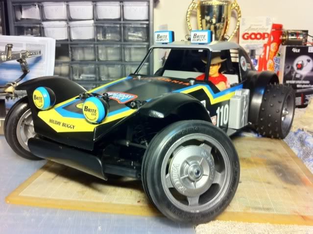

Firstly, this is how the HB2010 look like when i first build it
And this is how it look like it now

Honestly Dude, that just looks plain silly and I bet it hampers the performance.
Why not keep the vintage HB the same and the new the way it is! The DT-02 chassis is very good. With new shocks that is. ;)

Does any know the wheelbase width and length of this? Trying to achieve this:
http://www.tamiyaclu...l.asp?cid=98734
I’ve configured mine to 260 mm wheelbase, but if you flip the rear suspension arms you’ll have something like 250 mm. But the resulting drive shaft angle is quite alarming, and mounting the rear shocks become an issue.
However, when using touring car bodies like shown in the showroom entry, the tall rear shock tower and gearbox can be an issue.

Plus Does this method with the DF03RA arms narrow the HB enough to fit under a touring car chassis?

Yeah, in this thread, but there is no mention of how wide it now is. I'll have another look around.I already have a new holiday buggy chassis and a MK2 Escort shell to go on it. I ordered some DF03RA arms yesterday, so I'll just try it and start up a project thread next week.
