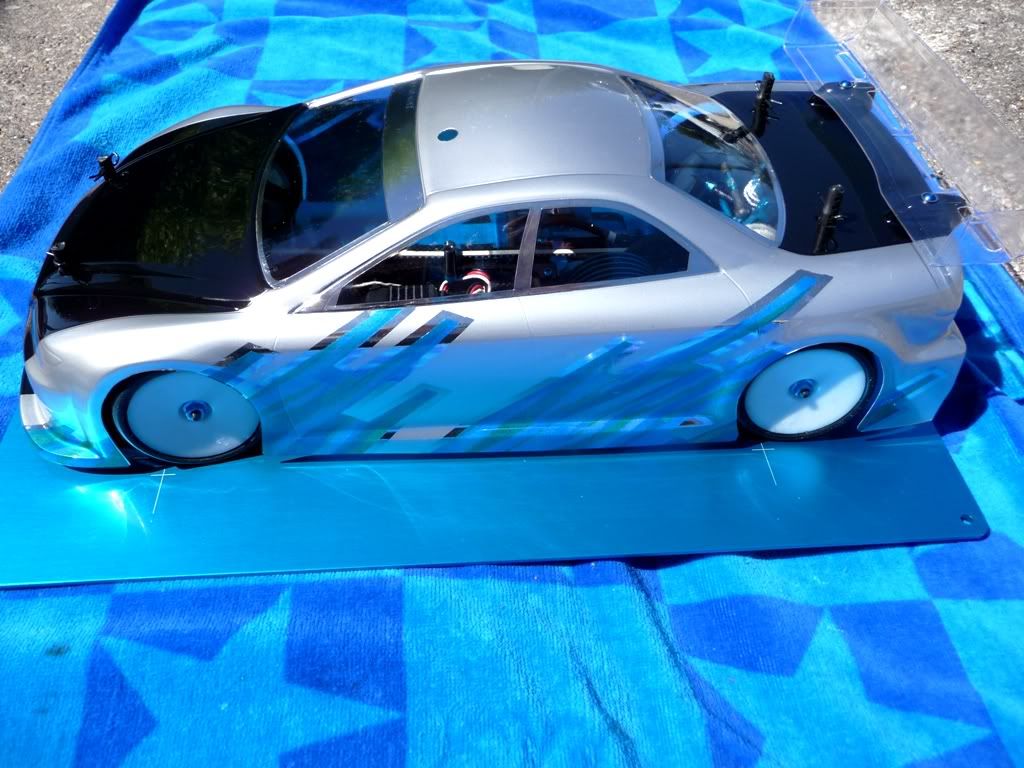

The SpazStix Chrome is great. It's really expensive though compared to other polycarbonate paints. Because it's not very opaque, there are lots of cool effects you can make by layering it.
This is it backed with a lighter blue for a weird blue/chrome effect. Changes in the light. I think I even drew some stripes no it with a blue sharpie before laying on the chrome.
This has the chrome backed with black for a pure chrome look. Came out fantastic, but my pics have too much blue in them:
