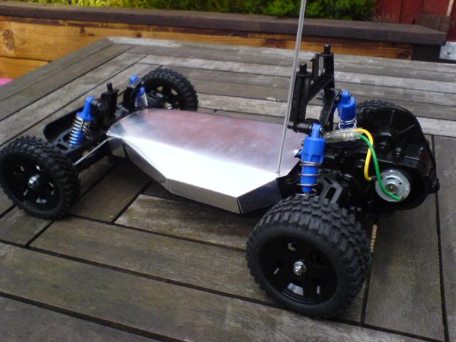

Been able to get a bit of fiddling done this weekend as well as hooning around the garden with my new little HB2010. First proper mod for my HB is a dust cover to stop debris and god knows what getting thrown into its tub, something it seems to excel at.

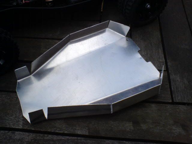

The original idea was going to be a plasticard "lid" that would fit over the body and be held on with velcro, just like the Tamiya touring car covers. But having worked it all out on cardboard templates and transfered it to the plasticard, I found I couldnt bend the P'card enough without it splitting along the fold lines. It could've been taped together but I doubt it would last long with the kind of vibration and wet running an R/C car gets subjected too.

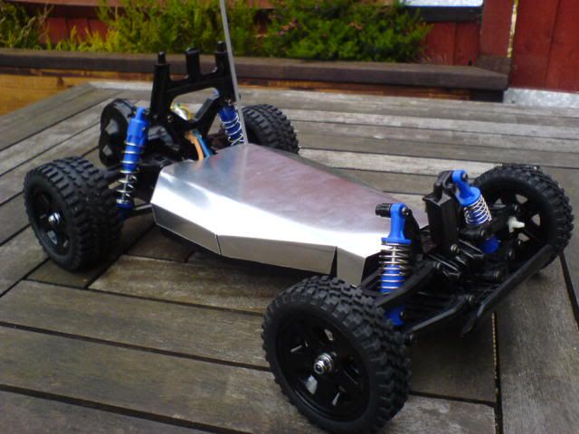

Which brings me onto the Mk 2 and a "light bulb" moment. Using the same template I transfered the design on to a small piece of sheet aluminuim I had in the loft. Cut out with the dremel and cleaned up the edges I then bent the "folds" over a piece of wood to get a much stronger angle that held just where I wanted it. With a little drilling & tweeking it now holds on by itself! I just added a section of foam to protect the motor wiring and its done.

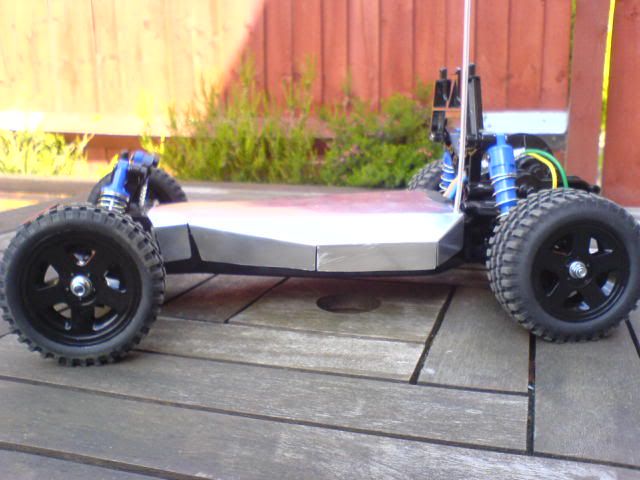

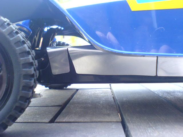

As its so low it easily fits under the HB bodyshell and bearly touches it at the widest point, just infront of the rear wheel arches. Out of interest I popped it on the kitchen scales and it weighs 60grams. My one worry was that it may interfere with radio reception but its been fine in my garden (although its only about 40ft long) but I'll take it out and do a proper test when I get the chance.
Im pretty happy with it. Think a coat of satin black would be a good idea.

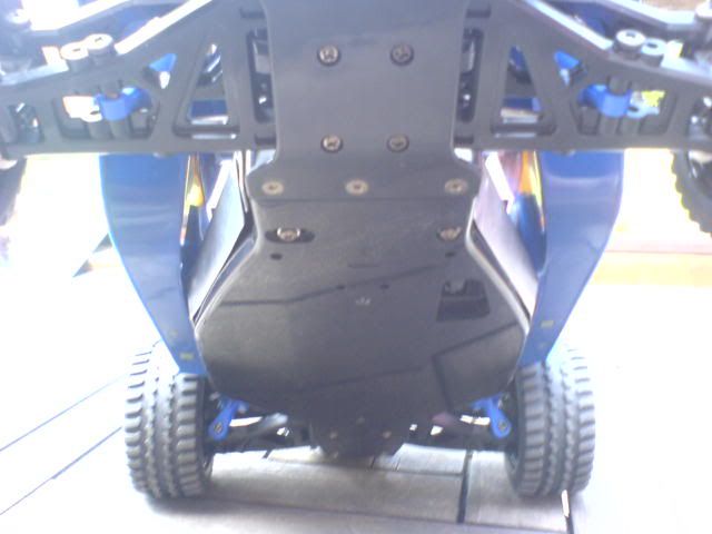

It holds itself in place as I've bent the side walls in a little further than necessary. You can just about make it out in the 4th picture down where its upside down. You need to flex the sides outwards slightly to ease it over the tub and it then springs back gripping the sides nicely. That coupled with the antenna tube being thread through a hole secures it in place perfectly, yet it can still be easily removed and there's no body pins to loose or tools required.
