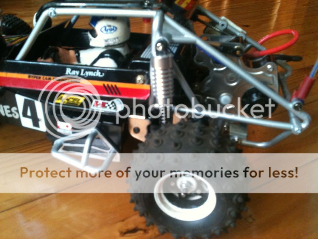

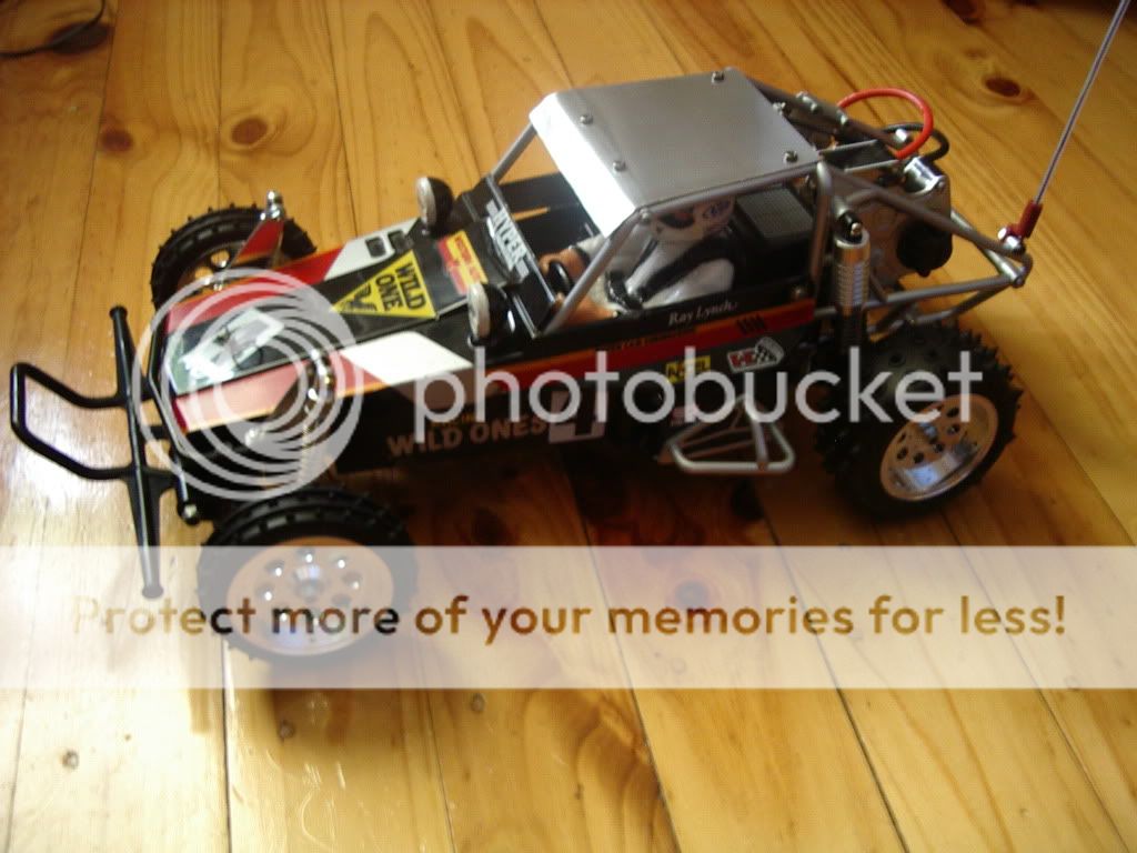

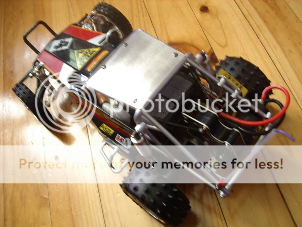

Thanks. I finally found a Wild One and really lucked out. All original, no scratches or marks. It was built and used a couple of times and I guess sat on a shelf. The owner passed on and all his stuff went to a local shop where it was purchased and put on a Kijiji. I can't beleive how mint it is. The driveshaft are making noise when you accelerate (clicking). I remember my Blackfoots and Monster Beetles doing this years ago when I was a kid. I might retrofit them all but we'll see. The car also came with a complete set of new drive shafts, and diff gears. I'll post pics soon. The only things I see missing are the stickers for the chassis and the stickers on the rear shocks.

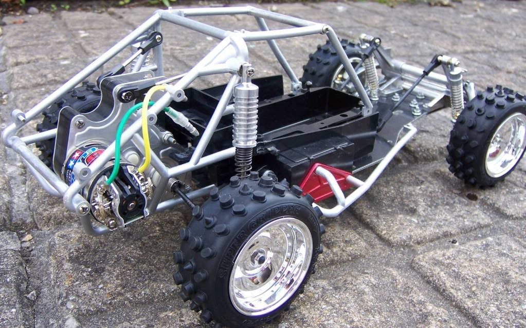

here's one i made earlier,
re-re Frog gearbox,uj's and 12mm hex adapters.
mounted as normal at the bottom and held only by 2 turnbuckles at the top.very sturdy..dosnt seem it on paper but once built you'll see.
