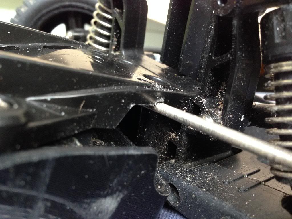

As far as I can remember, check the steering links. When I built the CVA front shocks according to the HB2010 manual, the right rod will hit the servo cover plate on full compressed suspension. On hard landings, this can cause the rod to bend.
Thanks for that heads up GregM, I'd completely missed that. 2 mins with a round file and it's sorted.

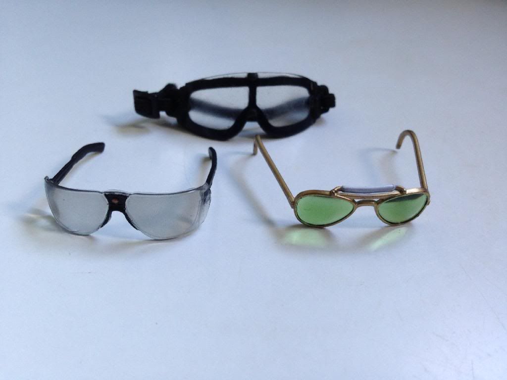

Had a search through my 1/6 figure spares for dust goggles but the only pair I had didnt suit the helmet apature.
2F40FC5C-C5E7-4C7A-8AC3-C98FE73D2A4B_zps
I did find a rather groovy pair of shades that after a little fettling look like this...

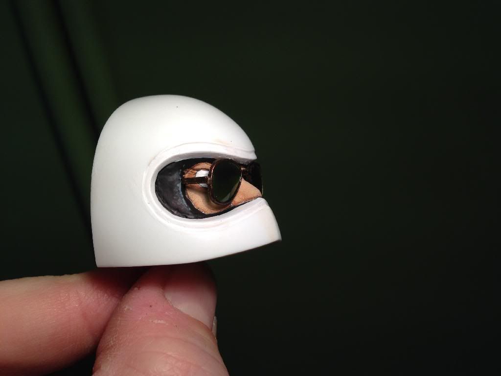

E46A6C92-FA86-4555-8912-CC60B0A94E8C_zps
Perfect for a little California beach cruising. I just drilled two small holes to accept the glasses arms but I managed to crack the bridge while test fitting, once his face is painted I'll glue them in place and paint over the crack.

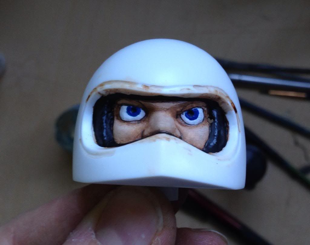

Ok here's the face painting progress...
7D6D3966-A52D-44A2-BA8A-78853EE8C521_zps
And with the shades
B66BB3D1-2B47-4D03-B449-13596B93FABF_zps
7DC336E8-F7A3-4CF3-863E-08805FE85251_zps
I didn't realise the lenses were that transparent, they give him a bit of magnification to the eyes and I can't help being reminded of Eddy the eagle Edwards :)
