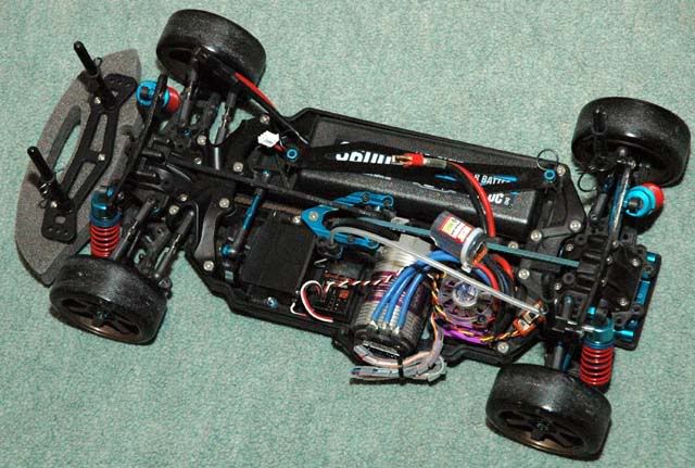

I have just bought a capacitor for my ESC and believe you need to fit it to the battery wires? Can anyone suggest a decent wire splitter or way of doing this? would it be advisable to use a standard block type one like used in the home, then seal it?
Or could I twist the wires together and solder them to the same deans plug? Think that might be a bit to much for the tiny plates.

It will do nothing for your car, if your ESC needed a capacitor (which is only there to smooth the power supply) it would come with one in the box.
Anyway... to fit it it's usually easier to solder it on the the terminals of the ESC, and it they are not visible then cut a little bit of the jacket away from the cable and cover over with heatshrink or maybe electrical tape to stop it shorting out on anything.
I know its junk......but it looks cool, and to have it fitted but not wired is a bit of a cop out, so I'm gonna fit it anyway for looks more than anything. Will solder it straight to the deans I think.
