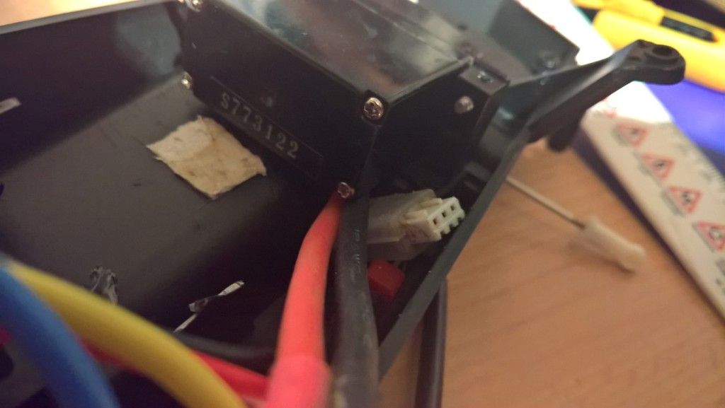

I have a 4000 Mah in mine.  What  I will say I changed my servo to a low profile one as a standard height one made fitting the battery awkward and pinched the wires badly
With normal servo
With low profile one.
I don't now how well it goes as it's a new build and I am currently in the waiting for paint to dry stage lol
With normal servo
Yeah the servo does limit the entry angle a bit, is your 4000mah the Core one I linked above?
