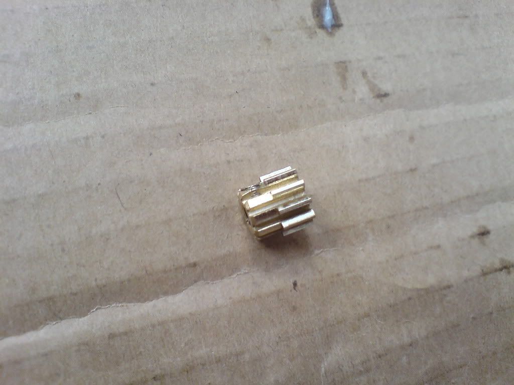

But to find the answer to the grinding problem it required me to take the gearbox out and carry out further inspection. What I found to be the problem was that the pinion gear could not be tightened to the flat of the motor shaft properly meaning that the motor shaft was just spinning and not moving the pinion gear. This meant that there was no grinding of the gears, it was just the sound of the motor spinning at high speed
This is what the pinion gear look like after I took it out:
Closer up:
If you can see the thread in the gear has split meaning that the grub screw could not be tightened up properly
Thanks for your help guys B)
