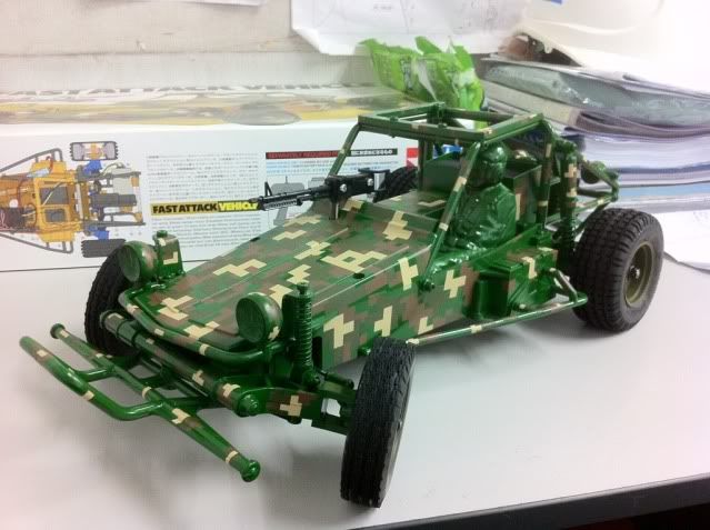

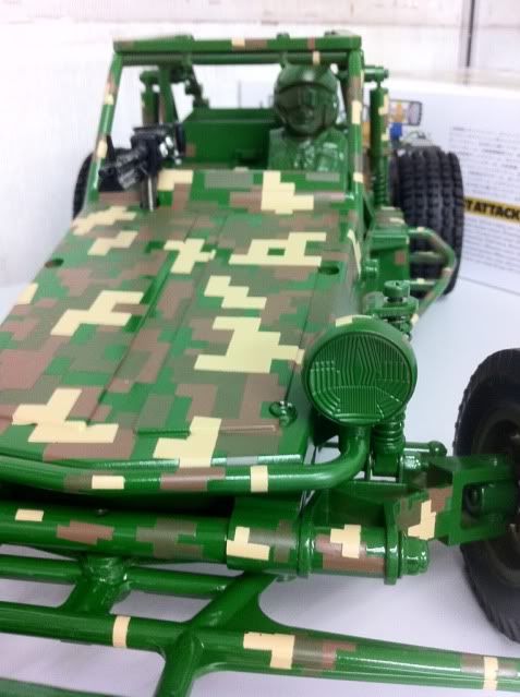

Nice build B)
could you tell me what the paint colours are used please? just so i can order them
Darren
U can actually choose not to paint it... Tamiya has included a camo decal that you can use straight away.

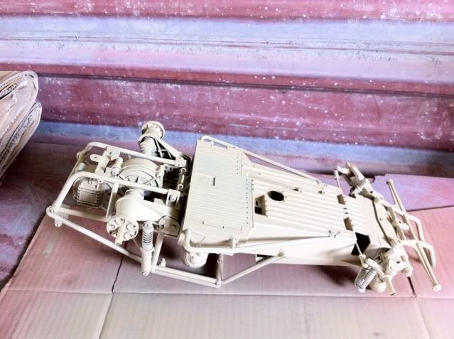

After 3days of work... Finally got a ugly looking camo paintwork done...
Still got to finish painting e driver, lights, install servo n esc n hope that we can a race soon....
Thanks for viewing....
