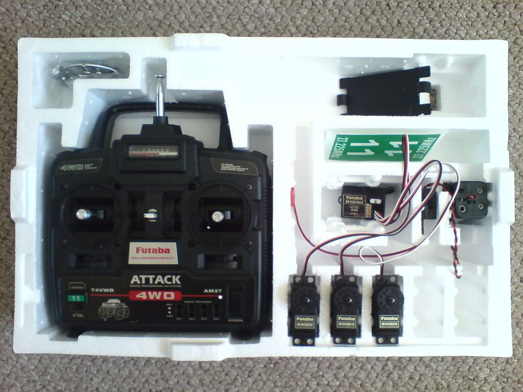

I then went out on ebay looked for a transmitter and found this (Futaba 4WD) which i bought for £100

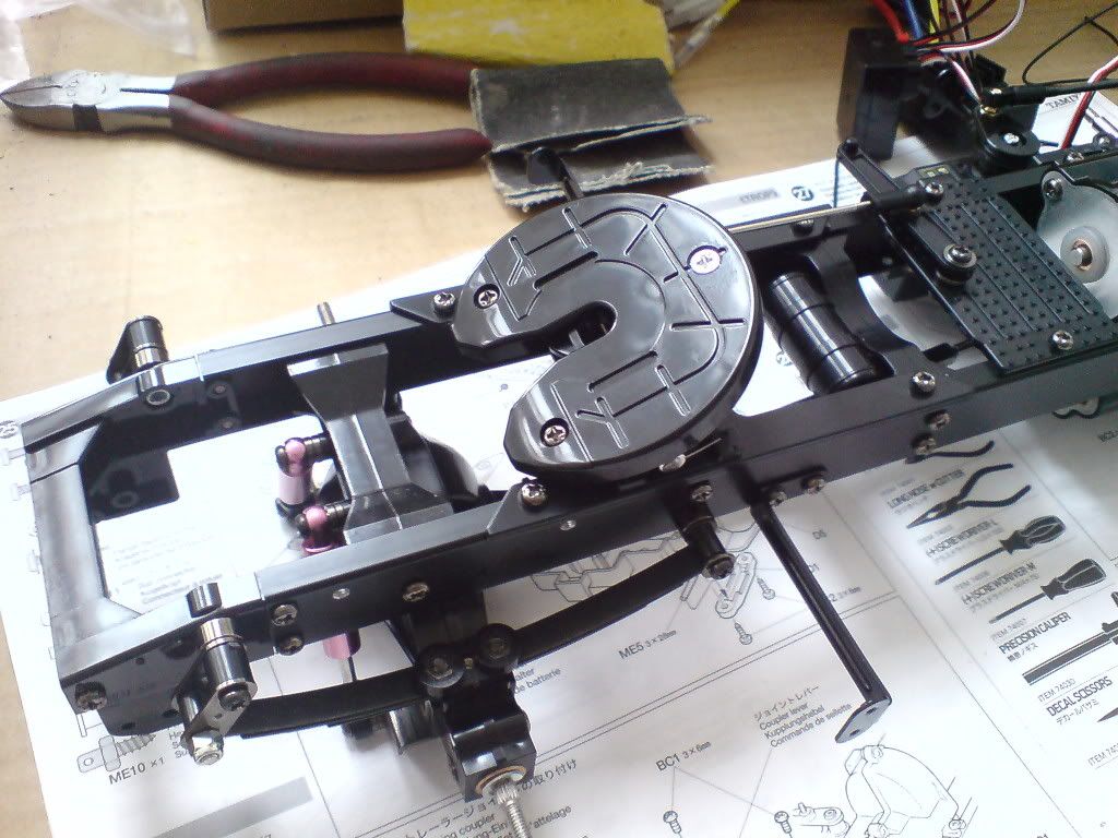

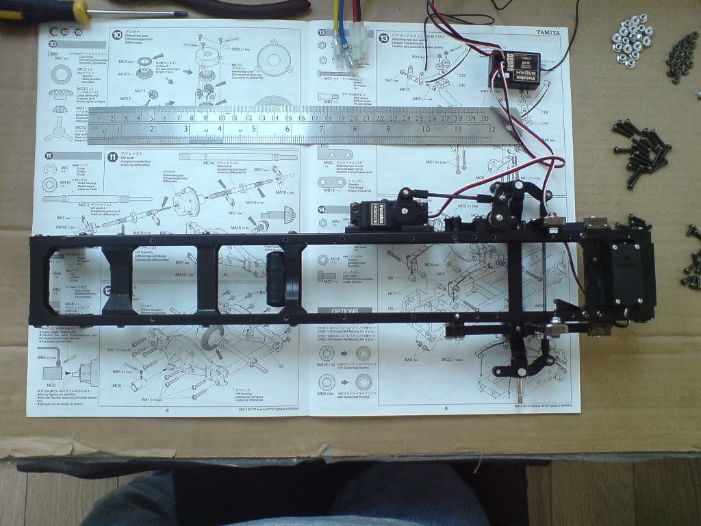

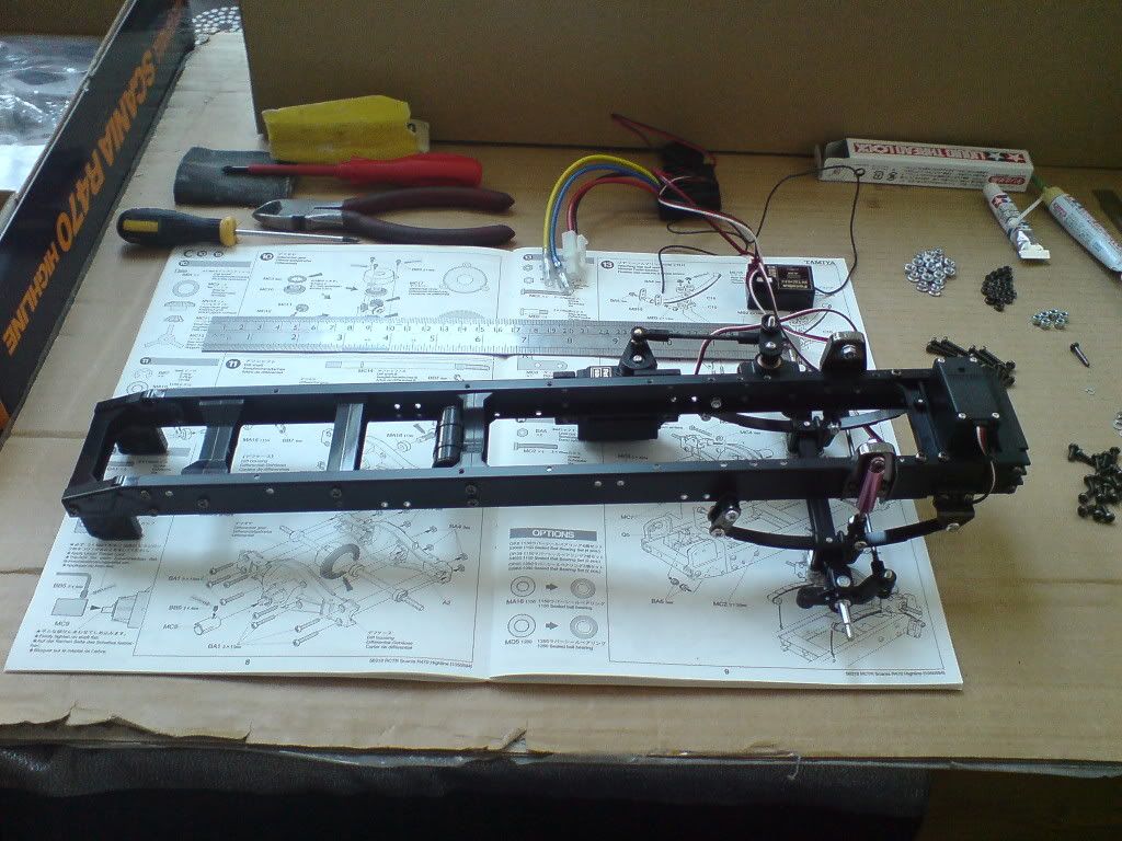

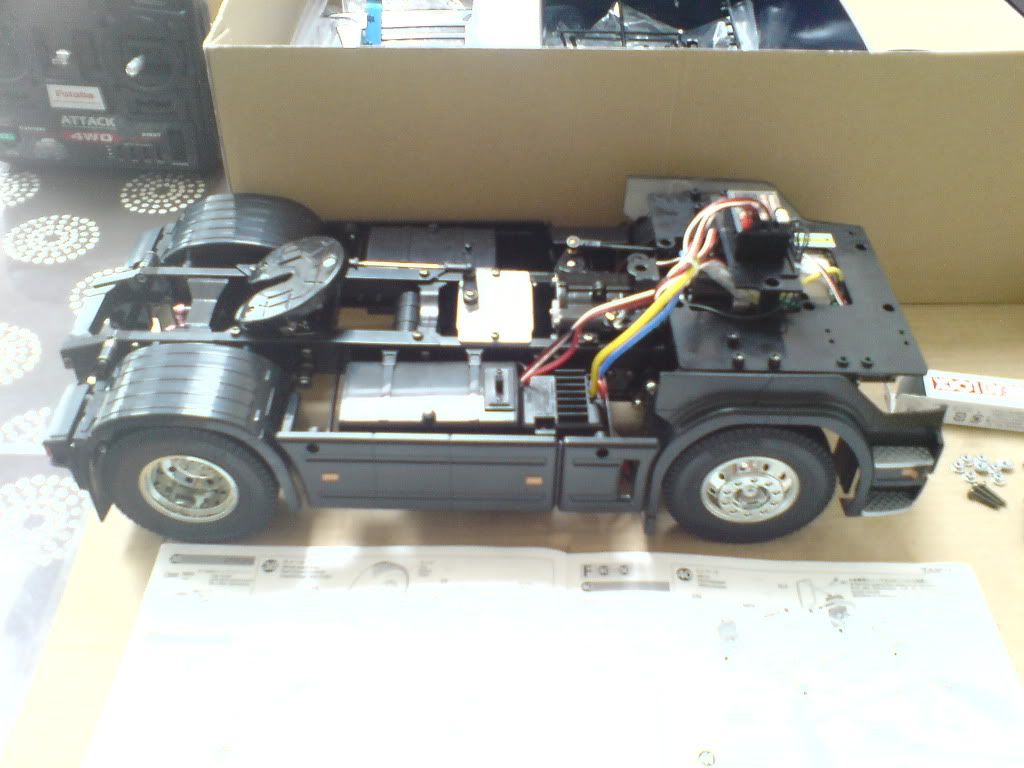

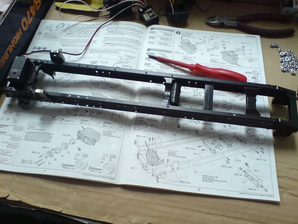

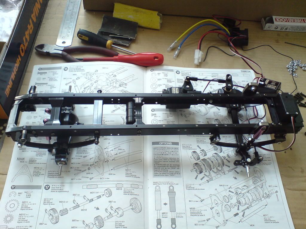

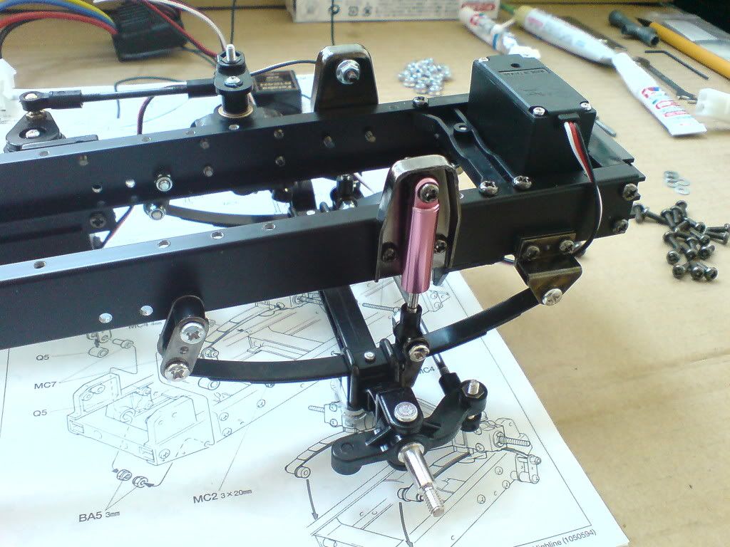

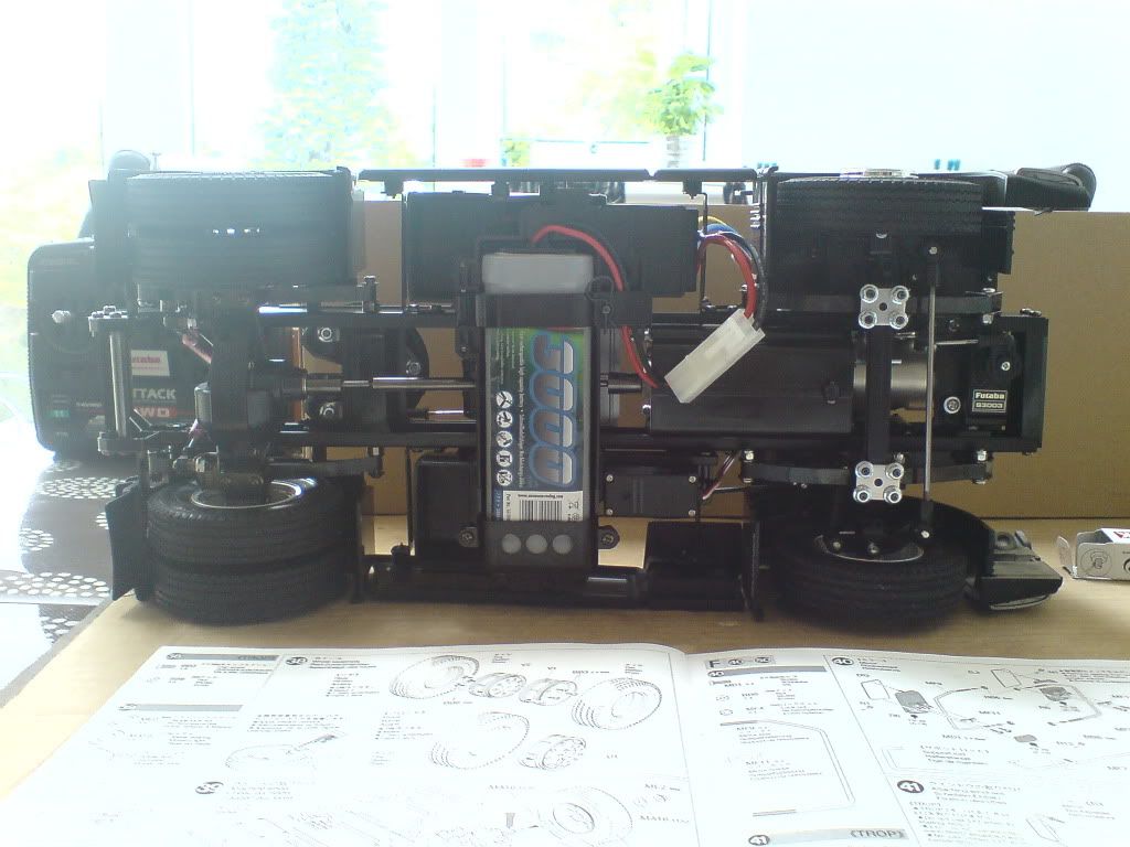

Base Ladder Frame

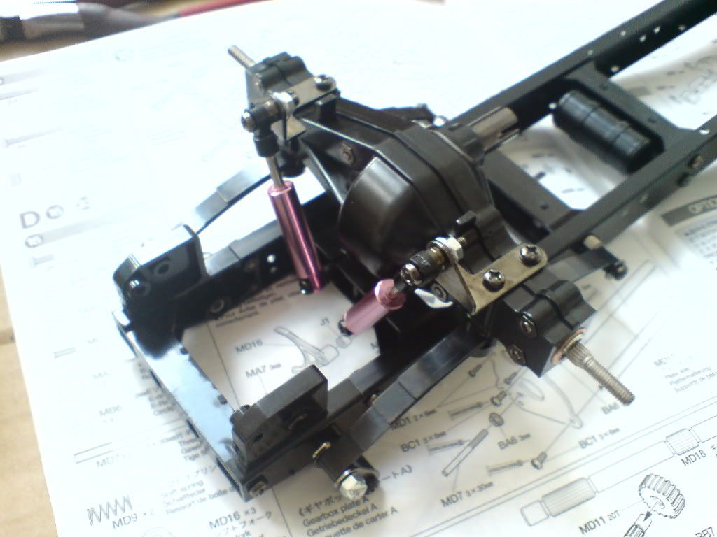

Front Suspension

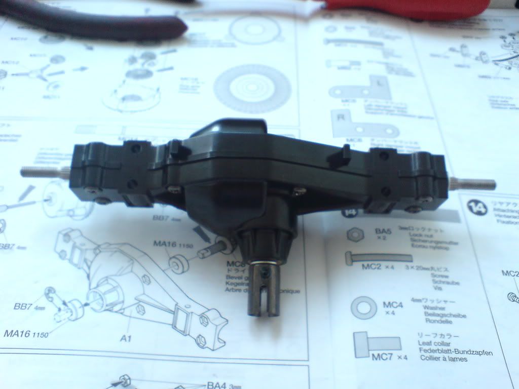

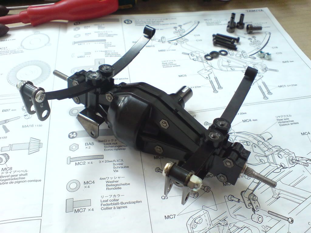

Rear Differential

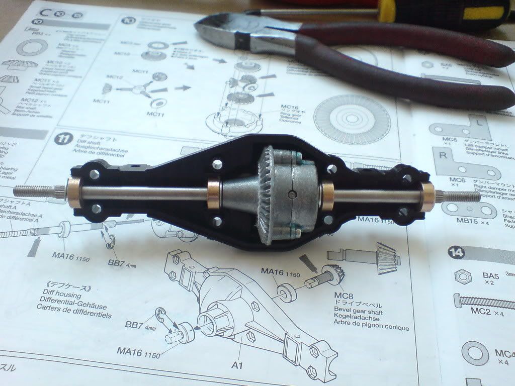

Differential Housing

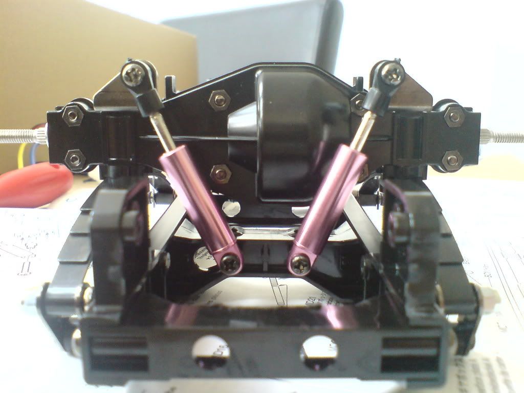

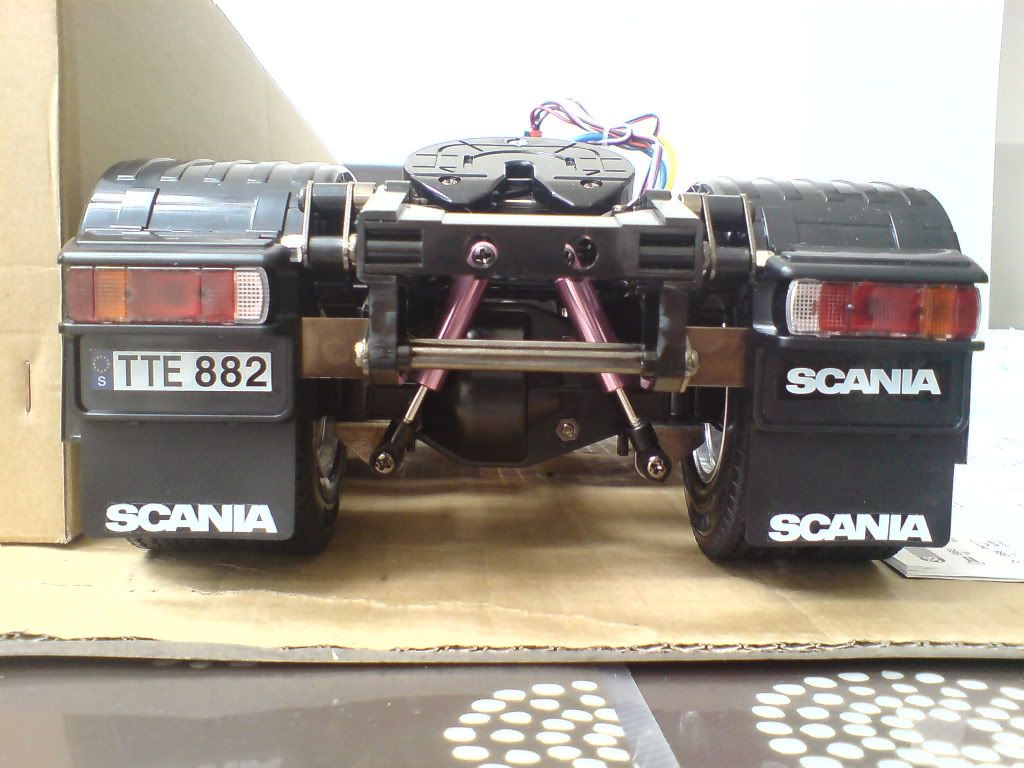

Rear Axle Complete

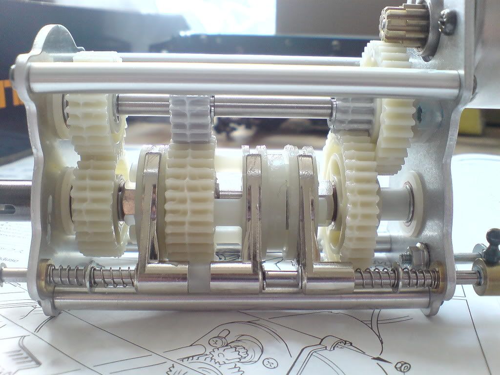

Shift Rod Complete

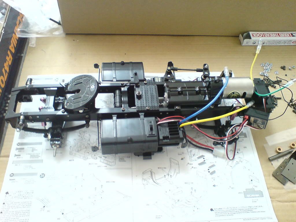

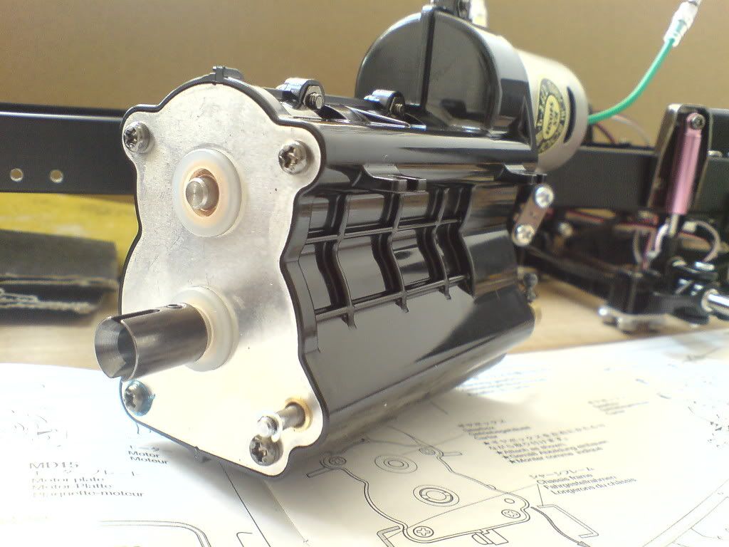

Assembled Gearbox
Fuel Tanks, Gearbox and Coupler Fitted
Coupler

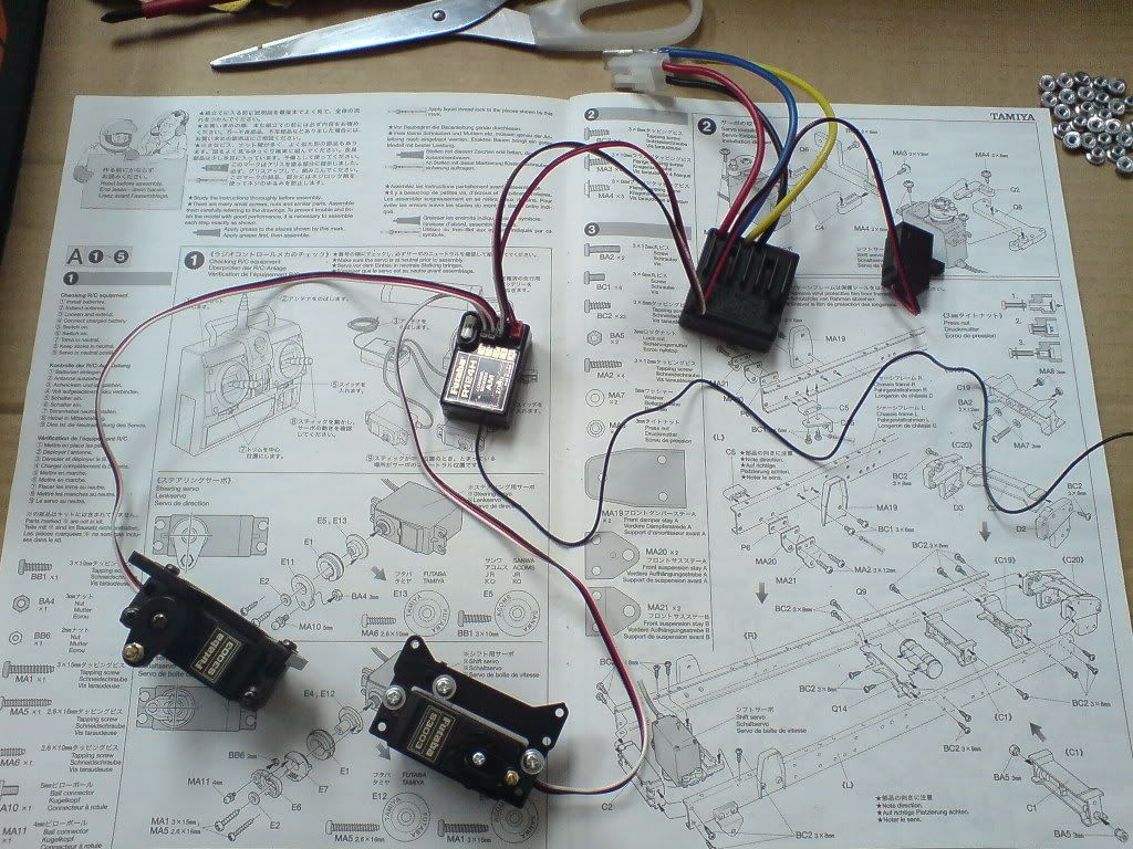

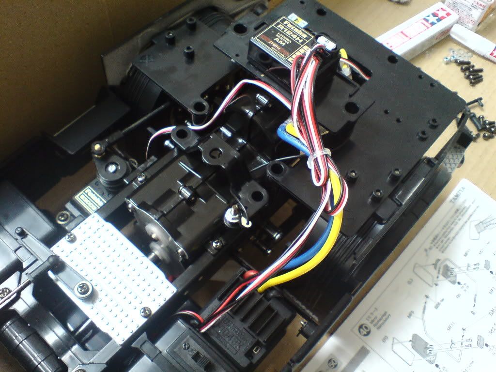

ESC

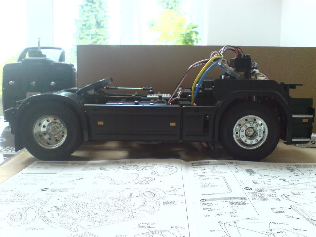

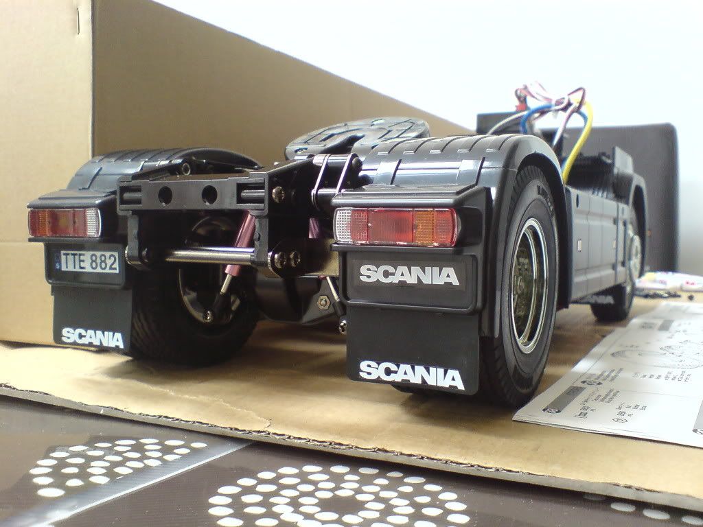

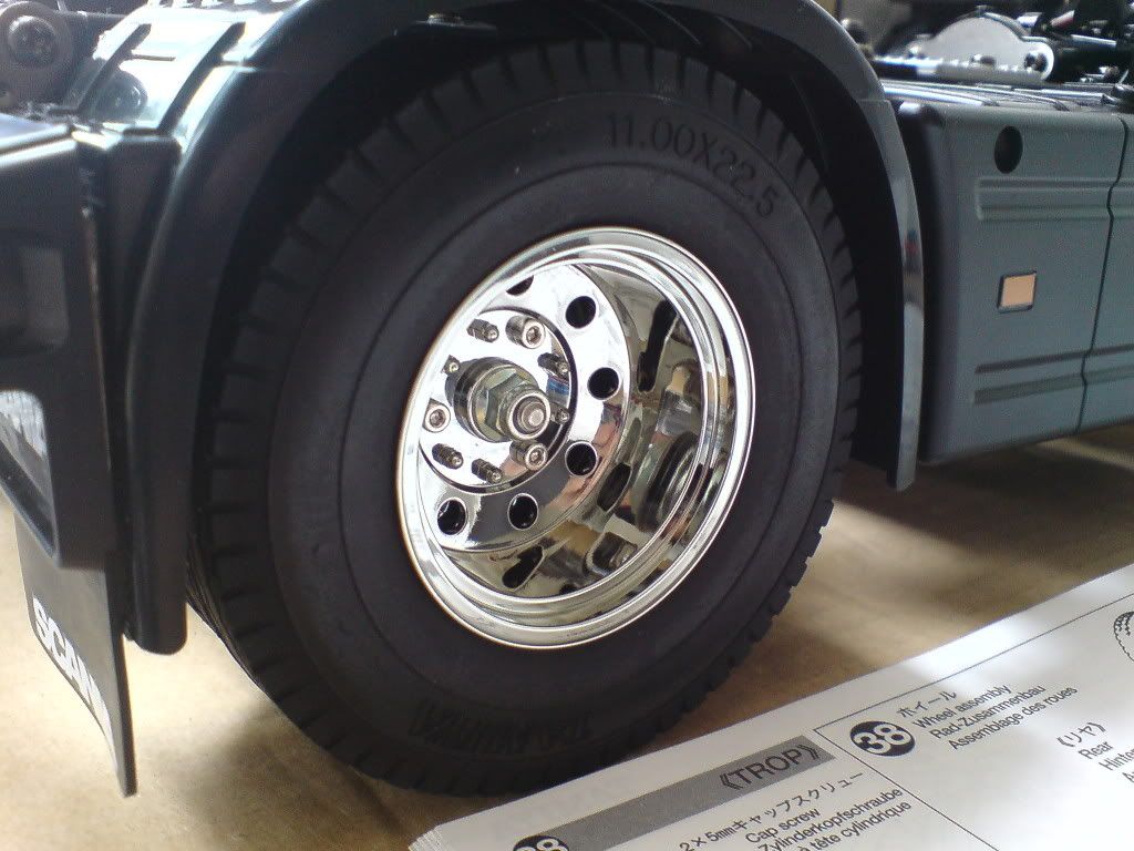

Fenders, Front and Rear Arches, Rear Light Clusters and Wheels Fitted

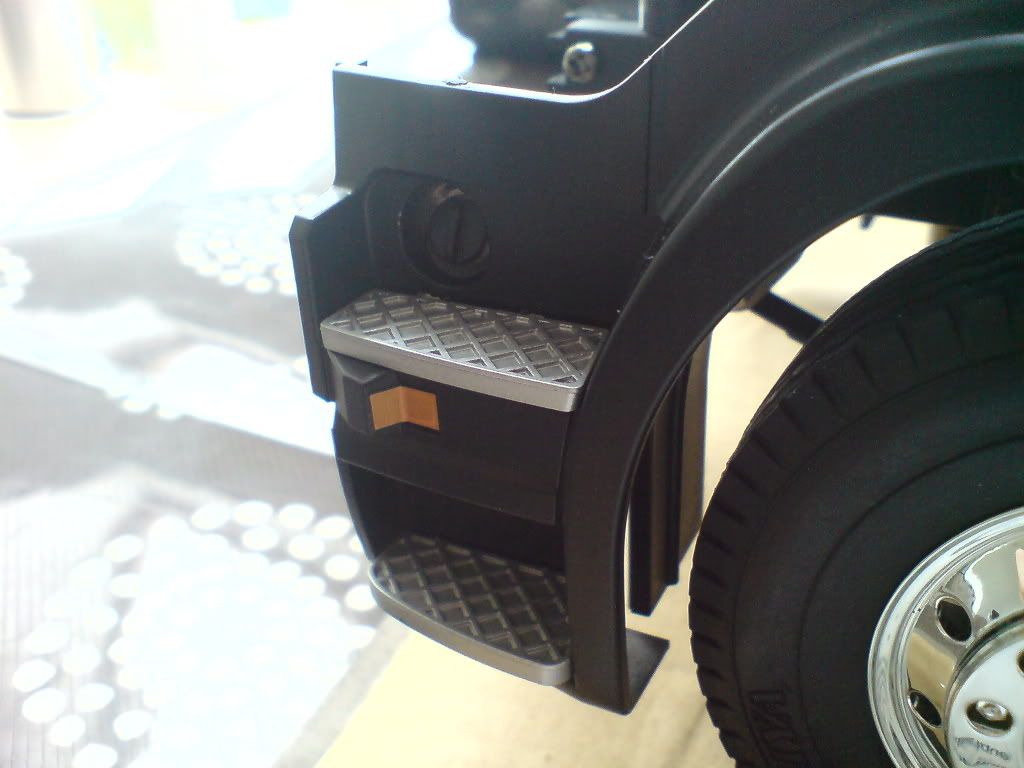

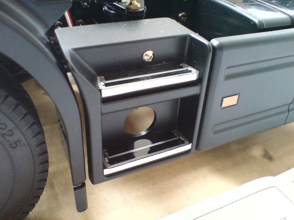

Front Step Plates

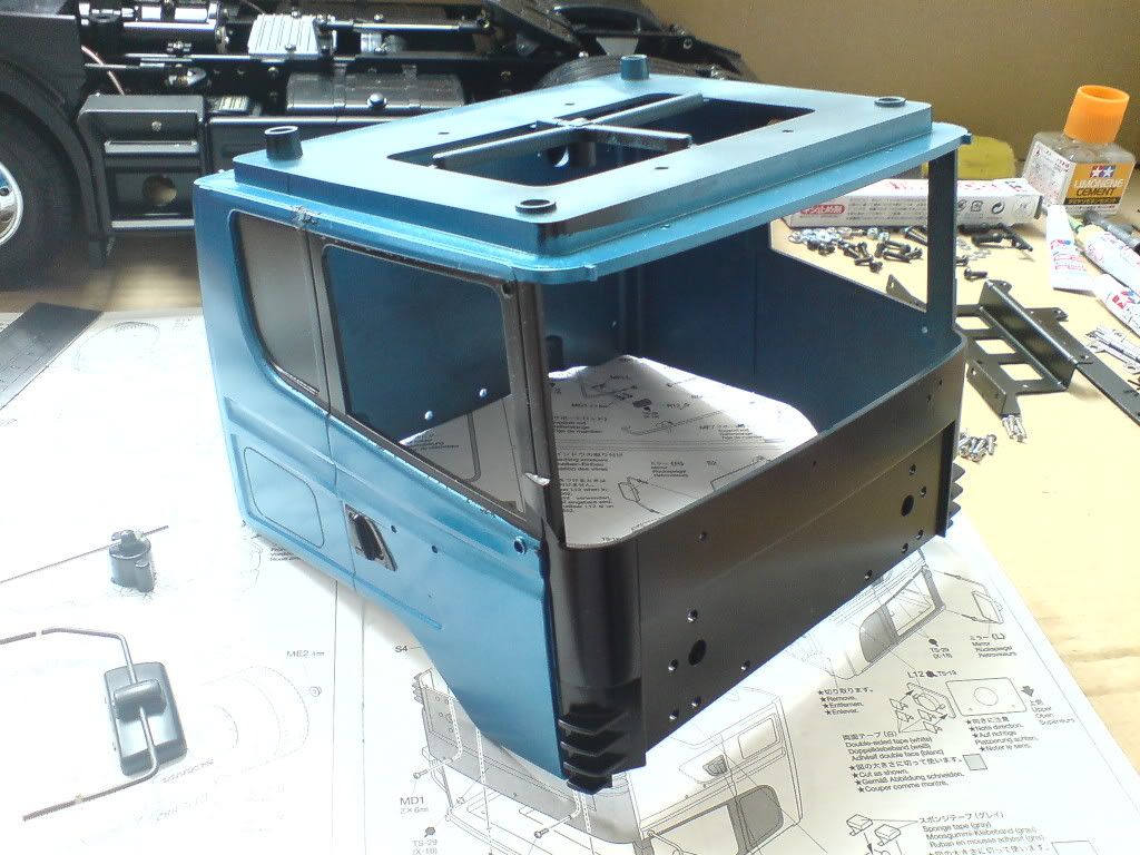

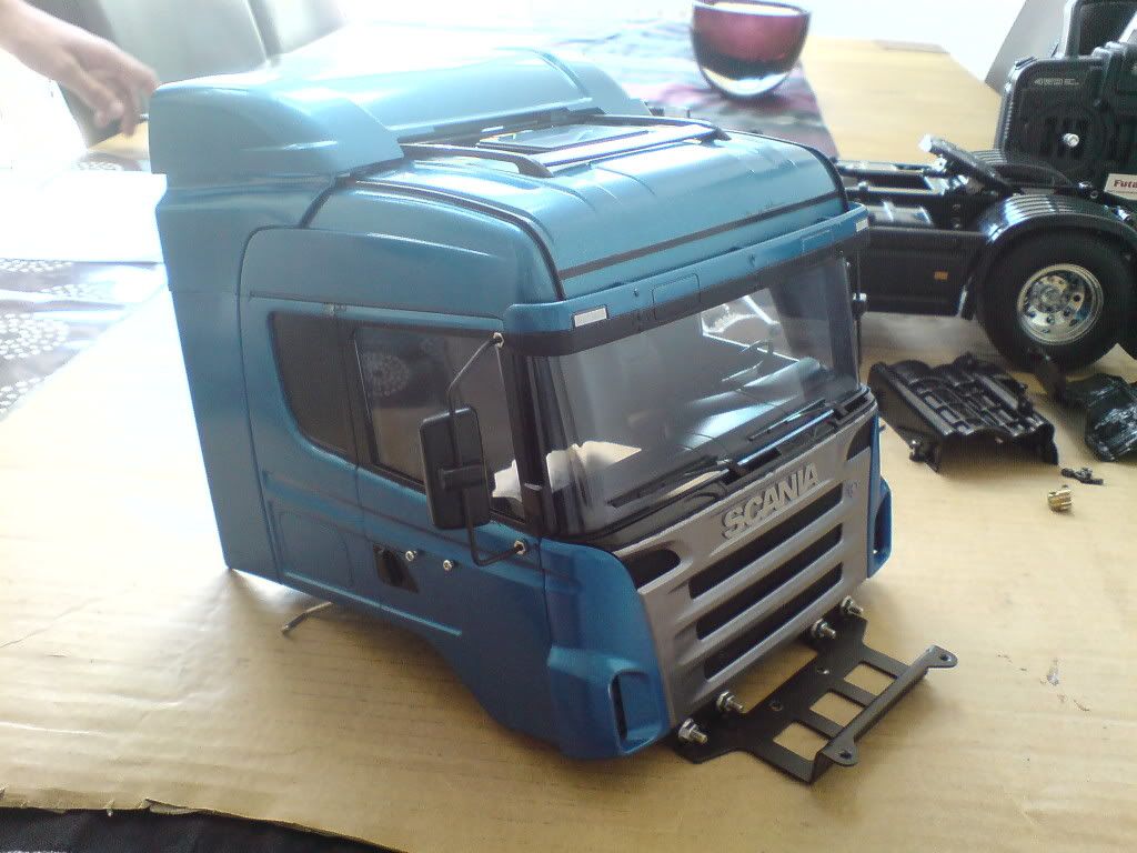

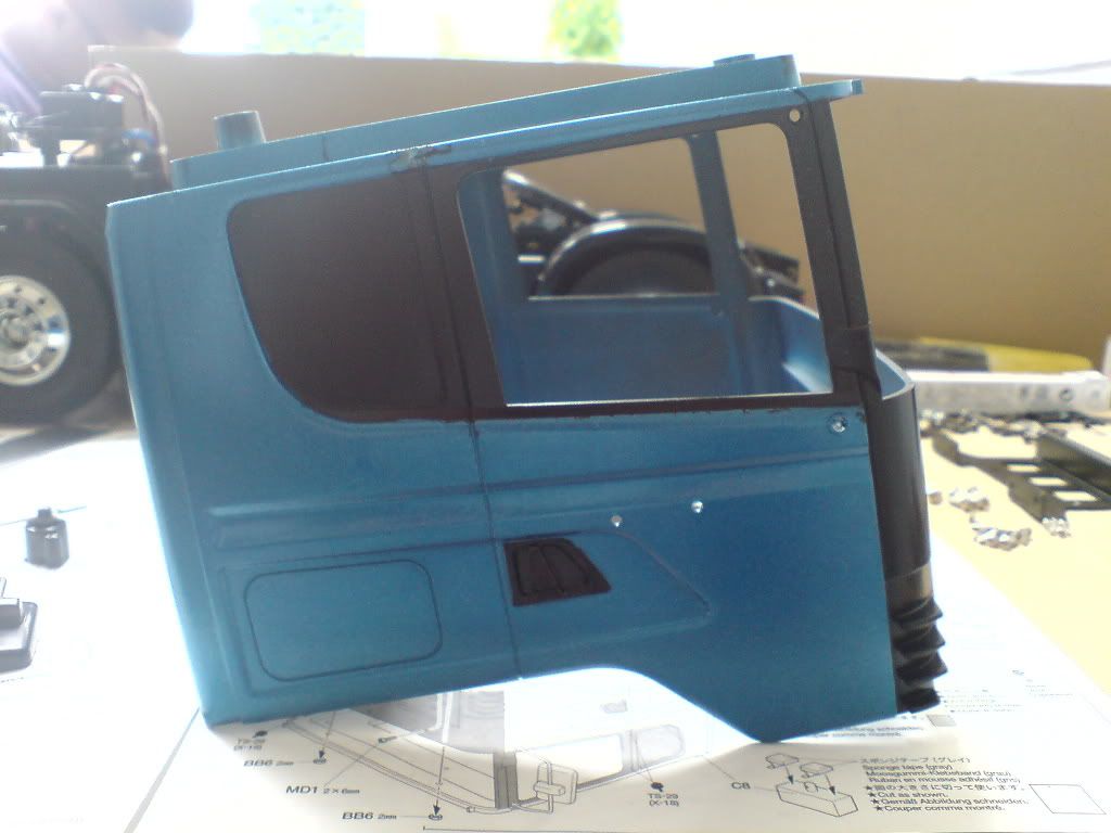

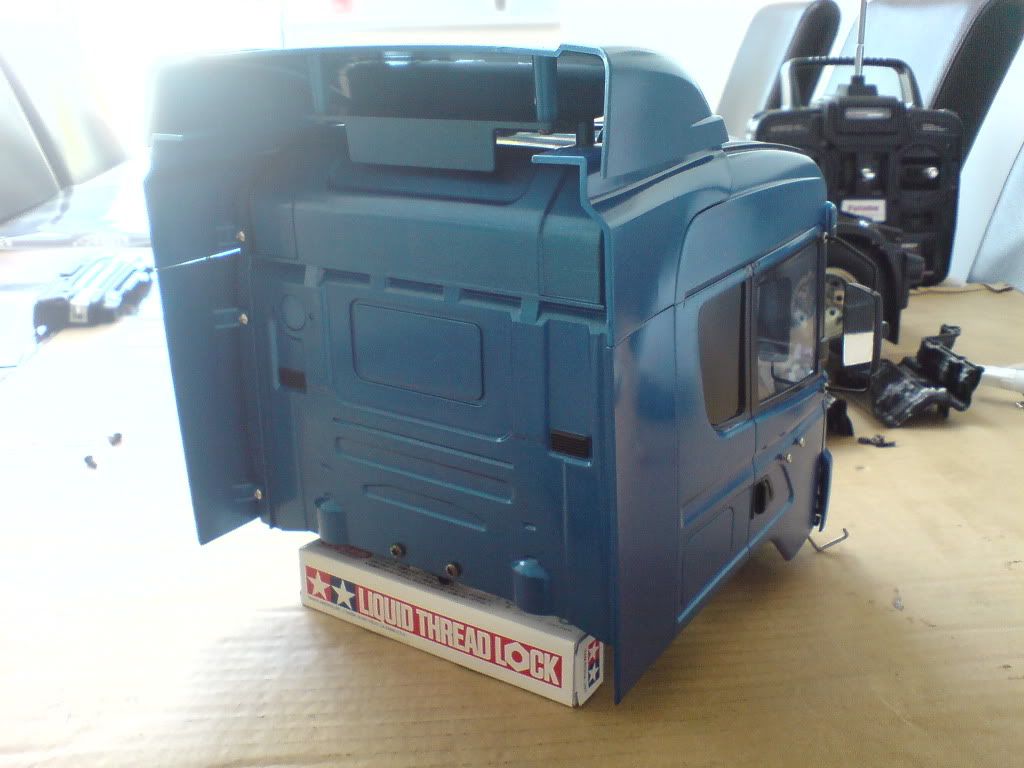

Cab Painted
Finished Cab
There is only one thing left to do...
...get some finished pictures up
I havent taken any yet because of my problem with the pinion gear, the truck has been stripped down and is waiting for its new pinion gear (Link Here)
Ive ordered one the other day and should be arriving soon

I would suggest you get a ball bearing set as well if you plan to run it. I notice the rear axle uses brass bushings so far.

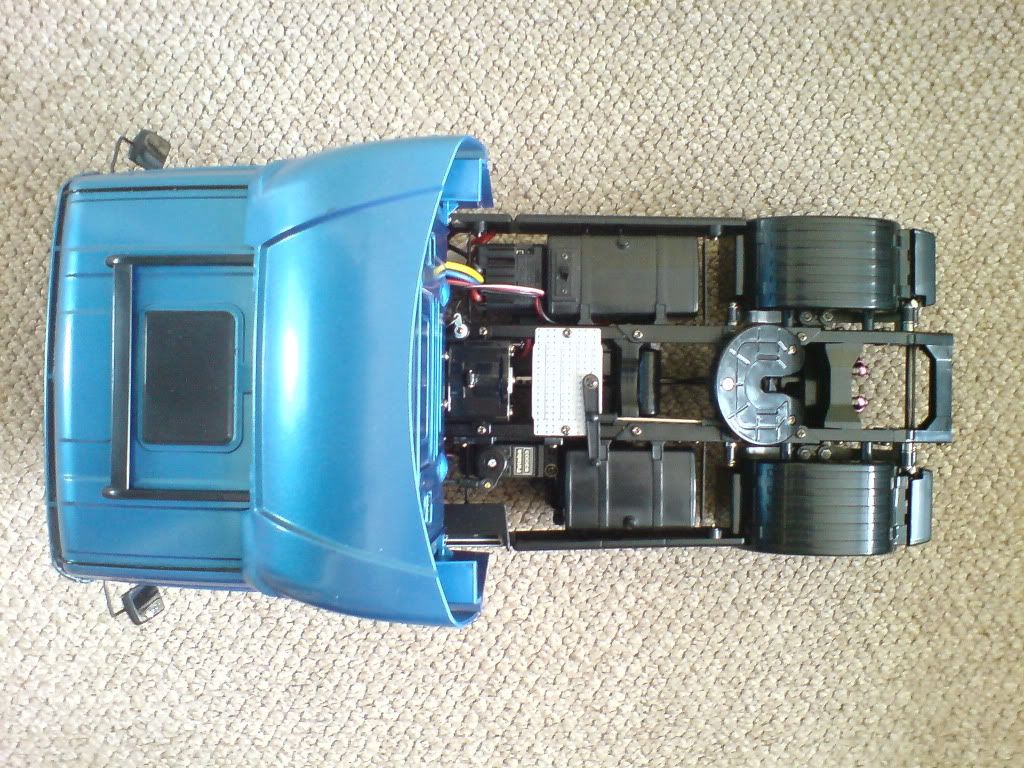

Just thought you should know that from looking at the pictures the motor pinion is fitted on the wrong way round. The fat end should be the part in contact with the spur gear. This is probably what caused the pinion to self destruct and your problems with getting the grub screw to tighten on the shaft. Other than that a very nice build.
Hope this helps
Im thinking of getting some soon

the cab doesn't come pre-painted so you have to spray it yourself
Hope this helps
I just realised after I took the gearbox out that the pinion gear was the wrong way around and i too think that is what caused the problem
Thanks for the help anyway

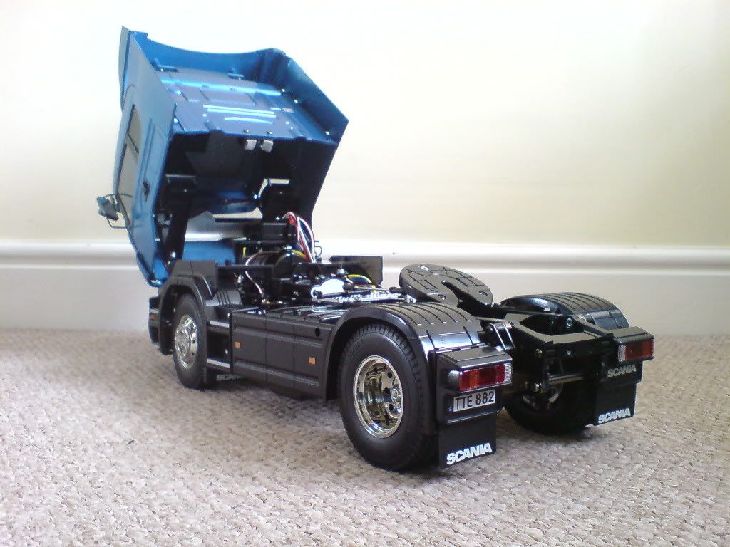

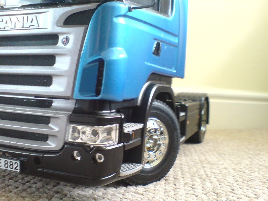

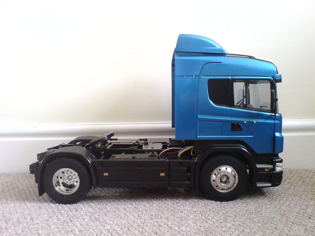

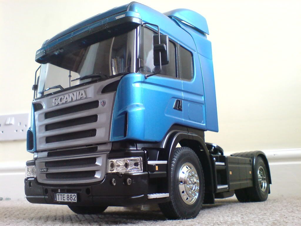

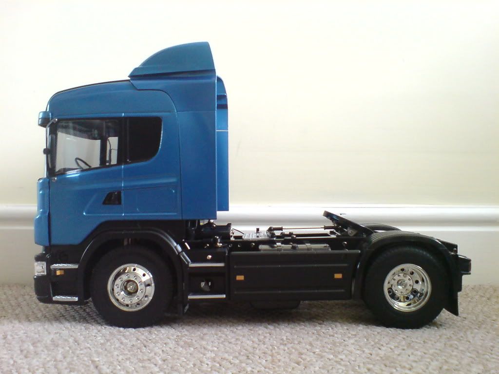

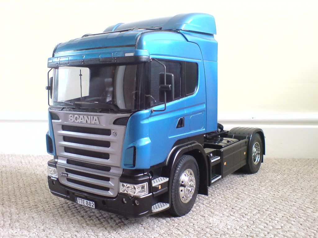

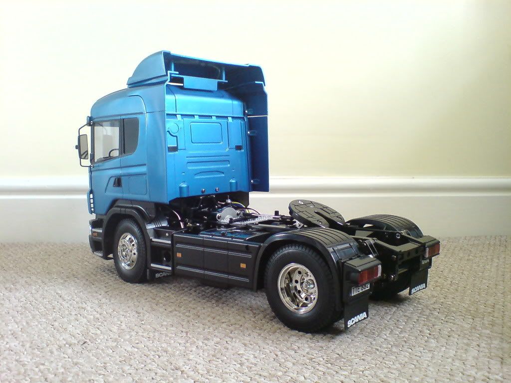

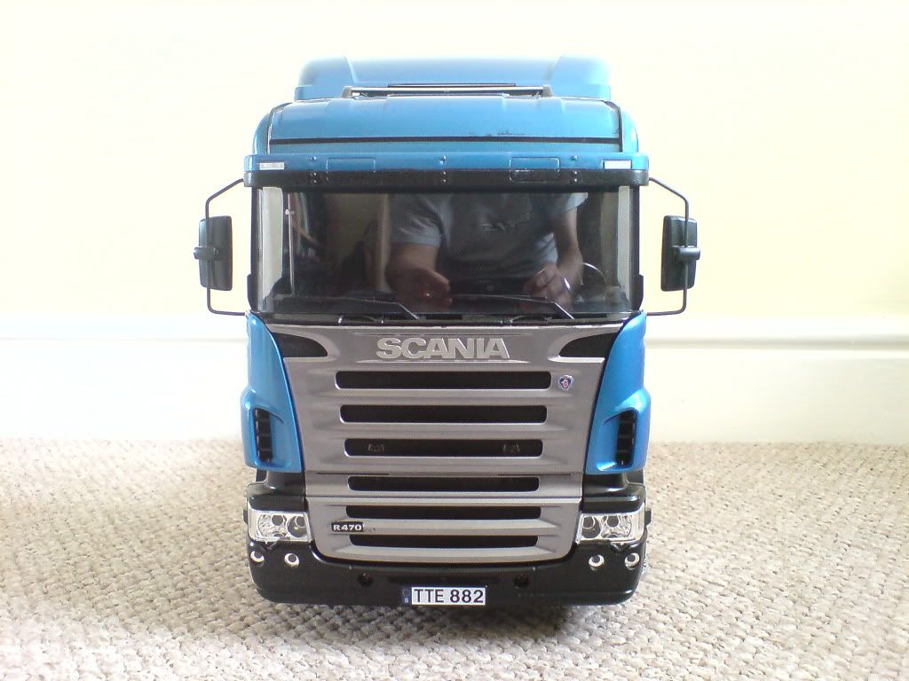

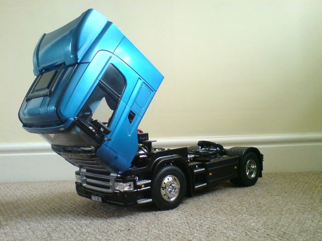

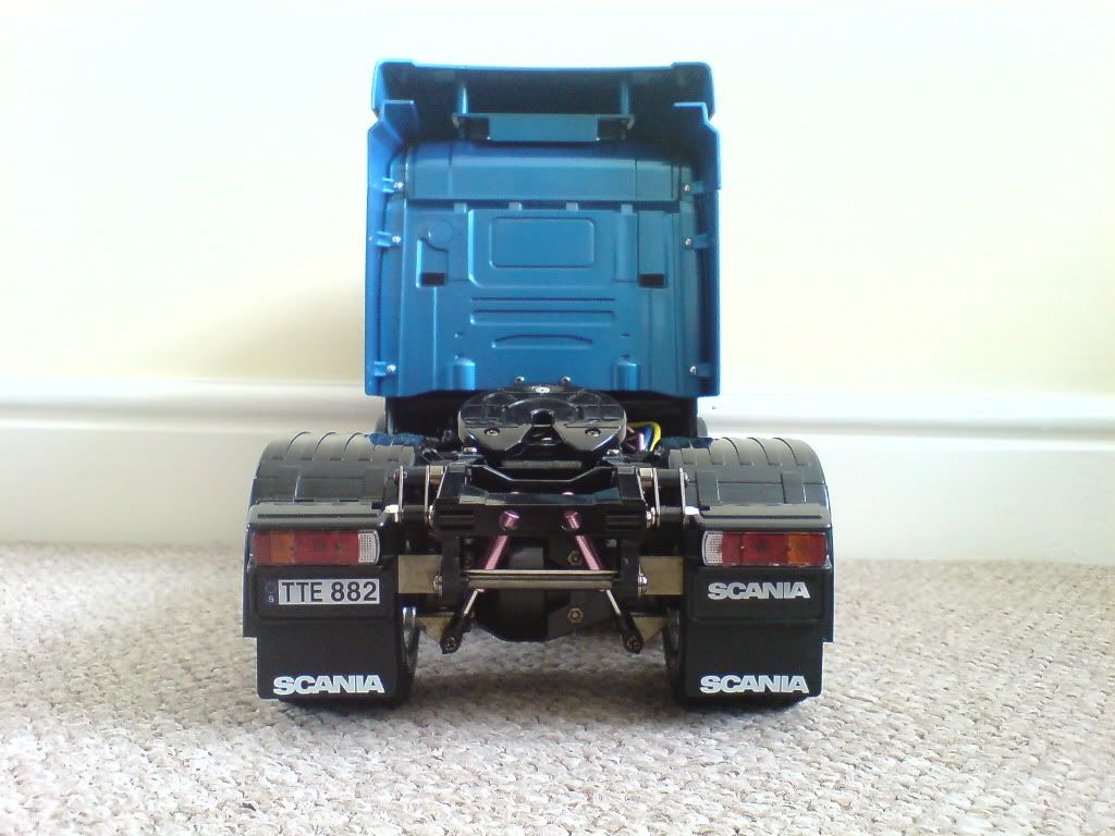

Well I finally got round to taking some finished pictures of my truck after polishing and replacing that broken pinion gear
Here it is:
Looks great. Love that colour, it really suits the scania. Paint finish looks good too. Really clean looking. Well done.
Any plans for a Trailer ?
Thanks mate, I think its the polish that done it

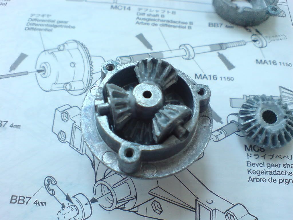

Bought some ball bearings, Carson Poison Truckpuller Motor, Telescopic antenna and more ceramic grease

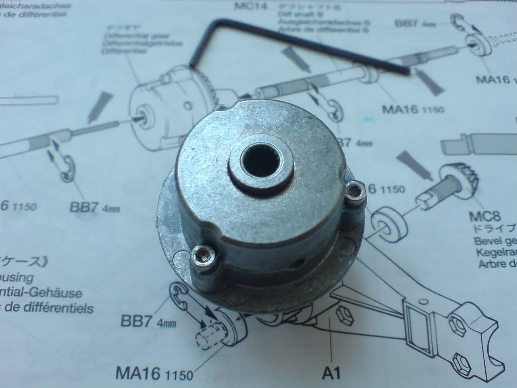

to start with i had to strip the whole truck down and take apart the gearbox and differential to access the bushings to replace them with ball bearings
Gearbox Stripped:
Differential Stripped:

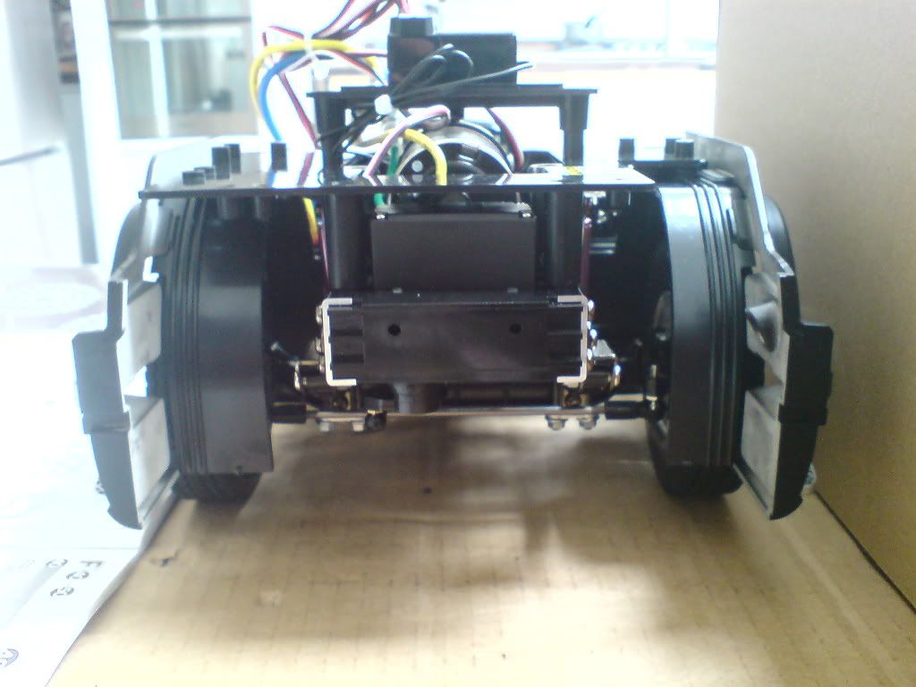

Steering Component
How the truck looked after...

lol, looks like just as much work to do the bearings as the whole truck! :lol:
