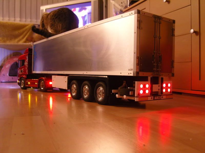

I added 1 or 2 extra lights to my scania
Side markers on the unit ran from a spare output on the mfu (the gear indicator one iirc) and I doubled up on the trailer lights (ones at the back ignore the rest!) and they too where powered from the mfu, it seems very capable of powering more lights.....but they HAVE to be the bog standard 1.5v led 3v units just pull too much, all the lights where added in series or parallel to give maximum brightness....
The trailer lights where a different story
And gave me nightmares for weeks! Again all done with 1.5v LEDs and 1 9v battery!
Interesting. Thanks for the input and really nice looking setup btw.
Ill get my hands on some 1.5V leds and have a go.

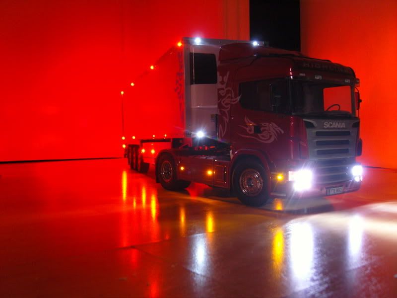

Here´s a few shots of one of my trucks with its lights on.
I am always using Servonaut electronics in mt builds, as they are way, way better than the Tamiya MFU in all aspects, however, you always have to make up your own light-systems, as Servonaut does not offer any pre-built "throw-in-the-model" systems...
Anyway, here it is. :)

That looks like a real, full size rig. Great job, thanks for sharing.
