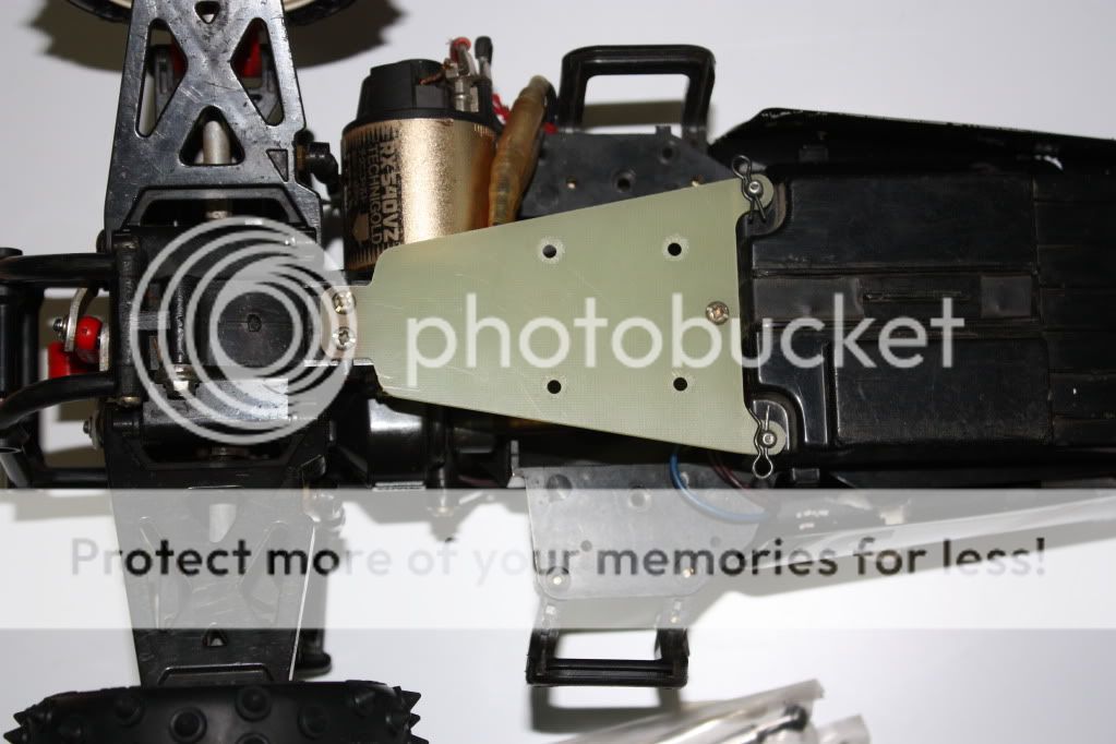

Got a hotshot recently came with a lot of parts. Cleaned it up a bit as it was really dusty...
Need a little help on this model as i am not too familiar with it.
So far i know it missing an underside piece cover or chassis?
Looking for one dogbone for the front, wheels & other stuff that i will discover when you guys look at it.

looks like an original Hotshot (1)
you're missing bottom "tub" for chassis that holds the servos etc,
plus you'll need the servo hardware & servosaver etc
tub & parts from re-re will be usable, wheels/tyres identical.
Not so on dogbone though, you'll need to get original.

Nice to hear the re-re tub/chassis will be usable.. Time to order one..
It has the servo still on the car but not sure if its complete. I see two pieces of it there.
Anybody has a original dogbone around? I need one..

i got 2 bottom tubs and a spare bone or 2 . as far as i could tell there was no difference in the bones on my original hotty . the bones had some line around the ends but other than that , the same . the end bits are different to other drive cups as the ball is bigger . how are the rear arms ? no broken off bits ?

Remember that there are two different lengths to the original Hot Shot dogbones. The rear ones are slightly longer and do not have the line around them, the front ones are shorter and do have the line. I don't think it will cause any problems if you mix them up.
The re-re Hot Shot instructs you to use the TA01 style front knuckles. The front dogbones are also shorter than the rear, and have a rib around the middle.

The rear arms are great. No broken off bits or anything.. :) It looks like after the rubber bag melted on the motor it wasn't used much after. The tires didn't have much wear on it too. I guess parts went missing from storage or something.. I haven't replaced anything yet on the buggy. Still missing bottom tub,dog bones & 2 tires.
I'll take better pics on the next one..

Yeah the rubber bags disintegrated pretty quickly. Better just to leave it off.
Radio box was probably removed and raided to get the RC gear out of it, and never reattached to the car. You're probably missing some miscellaneous parts from the radio box, like the servo mounts (and washers/screws), steering horn, brass steering ball joints, and servo saver (easy to get, same as re-re E parts, and S servo saver parts are still easy to get), and the 6 screws that attach the radio box, and the snap pin mounts and snap pins that hold the battery plate onto the radio box.
You're also missing the front bumper and skid guard (and mounting screw hardware). You can just use re-re C parts for that.
I would ditch the standard speed controller that's in it (the thing dangling underneath with all the wires), and replace it with a modern electronic speed control (ESC). A TEU-101BK/TEU-104BK will do just fine.

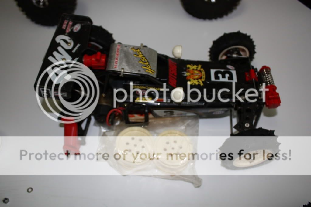

Got a few photos yesterday. Found another hotshot. Installed the right side wheels for pics bald ones.. ;) the first one i got was missing 1 front & 1 rear wheel..Still have to dismantle everything for a full rebuild some time. Its missing a bumper.. Anyone have one?
I replaced the motor from the other hotshot i got it had a nice motor on it.. :)

A little update on the hotshot. Bought some new re-re rims. They are too white & didn't match the fronts.
Only to find out later i had some new in package ones sitting in the shelf hiding.. :D
Installed the new rims & tires. I had some front ones that i know of. Totally forgot about the rear ones.. New battery holder from crp.

Great looking battery holder , very nice job . If i look around ALL of my stuff & in box's , cupboards etc I would be surprised on what i have .
I'm sure we all would ., We are RC junkies , with hidden rc bits :lol:

Those front drive shafts are a nightmare, I still need a pair for my vintage hotshot :)
Yeah i know.... The re re ones can be used i think? Unless you are restoring to full vintage then you need to find those...
@ Matman Thanks! The battery holder is a cheap upgrade.. B)
