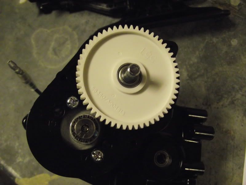

I have a dilema & i'm kinda baffled here....i also upgraded the motor to a tamiya mabuchi 540-J motor (upgrade kit from modelsport)..comes with 16t + 17t pinion gear & the all important shim..
Problem is when fitted/motor in the 17t slot as per destructions..the pinion is about 2mm away from being in mesh with the final drive/spur???...what gives here guys?? these must be the wrong type pinions??....please help!

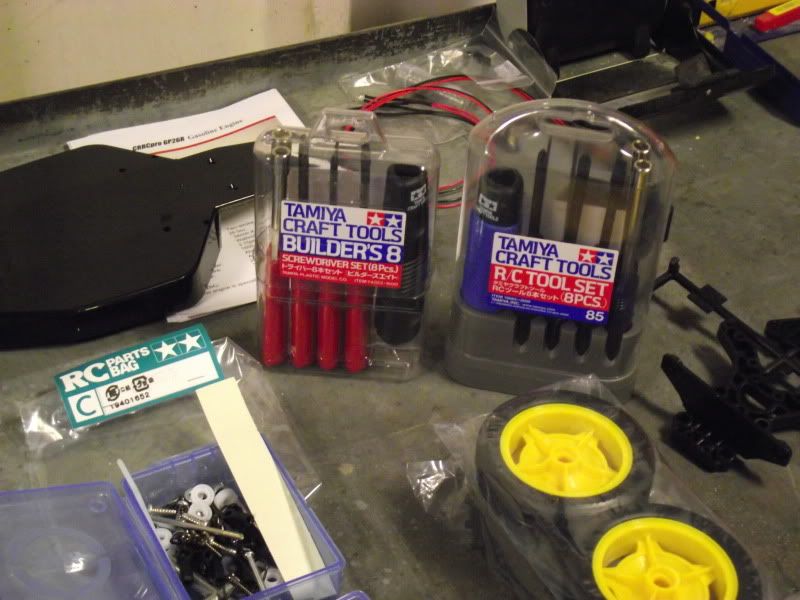

Someone kindly gave me these Official Tamiya tools!! yay!!..
003.jpg.

It's the wrong gear pitch... you have a 17 tooth 0.8 module pinion, meant for the touring cars. You need a 17 tooth 0.6 module or 32 pitch pinion. And don't get one from Tamiya; find a steel one.
Wrong way around.
The touring cars like the TT01 have a 0.6 module pinion (what Neo Tamiya bought). You need a 0.8 module pinion for the DT02 Holiday Buggy.
Avoid Tamiya aluminium 0.6 module and 0.8 module pinions like the plague. The aluminium is soft, will wear quickly and destroy the spur gear.
Better is to use steel 32dp pinions. ARW3200-17 and ARW3200-19 are the part numbers from modelsport. 32dp is so close to 0.8 module it's hard to measure the difference. The 19 tooth pinion is probably best with a standard silvercan 540, but as these are cheap I recommend you buy both the 19 and 17 tooth.

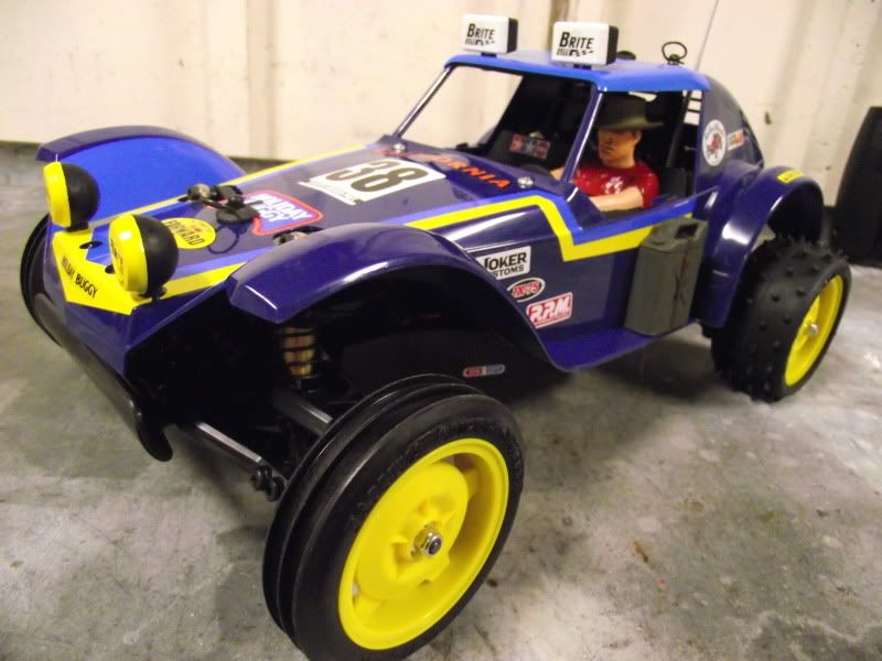

Ok guys...just finished my HB~2010 Today!!..yay.. :lol: ...all detailing done & i'm just waiting for my correct pinion set to arrive..

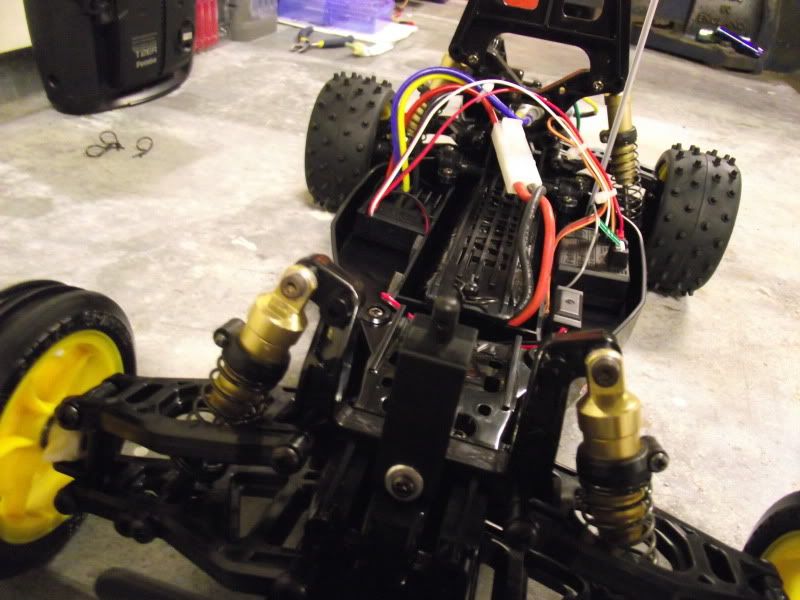

What an enjoyable build!!...although yesterday faffing around with the std suspension block dampers..(worse than the LB!?)...i decided to ditch them..fortunatley i had a top quality set of alloy racing shocks in the drawer!!..i forgot about!? B) ...so i proceeded to strip them down & changed the shock oil (it was like sludge!)...there were no leaks from these & seals were in great shape & pistons etc, re-filled with fresh silicone oil & bled...wow the suspension is superb now!!...ride heights set & this should corner like a dream.
Motor Upgrade to a 540J..& Full ball~bearing set added....digital steering 3kg servo....i chose to use an old servicable traditional stick set for this/crystals etc!!..(futaba).
Tracked up & ready for the club this sunday...it a great astroturf track & has a high rostrum...cannot wait to run this Tamiya around it!!.
The pin spiked tyres will be perfect for that....guys i'm exited!!!...i'll stick with the wide tack, as i'll what to go round corners at speed....i remember my old HB being a bit poor in this department...& robustness!.
I'll see how it handles being used for what it was meant for.. ;)
Watch this space for a full track report!!.

Remember you need to put the pinion on. motor backwards so it matches up perfictly with gear.(shows you on hop up page in hol buggy manual
