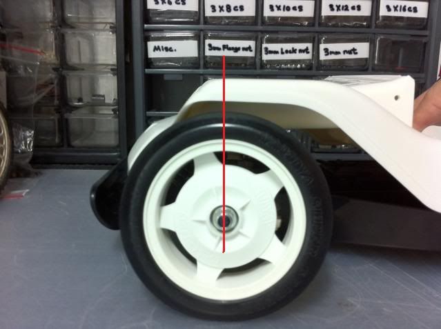

Yes it's to bad it really is nice I think it's better looking in person... BUT like others said the front wheels are just to far farward for this buggy that's what makes it look stupid.... At least tamiya could have made new A Arms for the front that pushed back the front wheels like a half inch or more!!!
One way to fix this some is to swap some front Blitzer a-arms and use spacers to bring the wheels back a fair bit. Just keep in mind, you'll need new steering rods and camber adjustment rods because the arms are narrower than the DT02 arms.

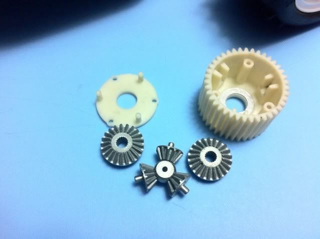

Anyway..... Got around to change the bevel gears to spline and narrow down the width of it.....but was met with afew small teething problems.... Will have to go look thur again to find some solutions......

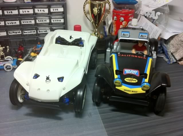

Together with the HB2010

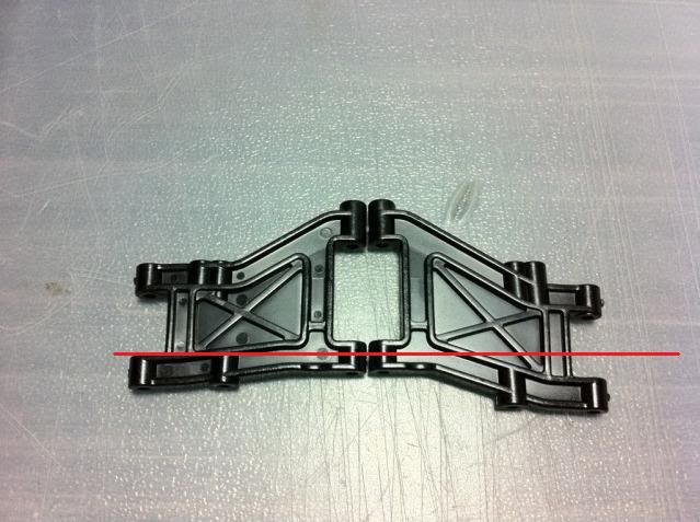

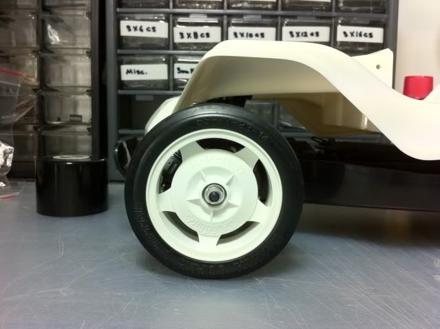

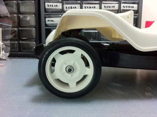

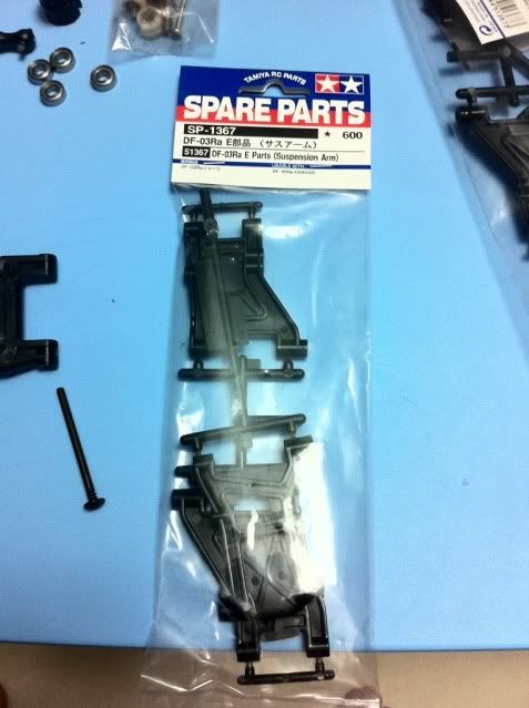

following comment from fellow member, donut, i swap the front arm from E2 to E3, and it does bring the front wheel further back afew mm....
photos....
E2 compare to E3
before
after
with this changes... it was easier to mount the shocks.....

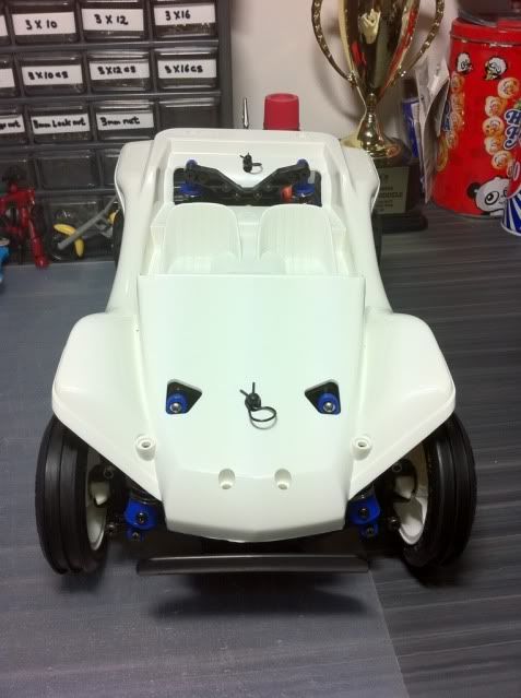

Finally got to work on my Sand Rover and followed your instructions on how to bring the wheels in. Only things I did different were:
- trimmed the front shock towers so they don't extend past the hood of the body
- fabricated an additional shock tower so I could cover up the holes on the hood and use extra DF-03ra shocks I had in my spares box
- trimmed the rear screw pins instead of drilling holes in the chassis
- used washers instead of spacers and installed the front uprights as far back the A-arms as possible
Now to cover that horrible gap between the chassis and body.

Nicely done on the front shock bracket donut, i like ur idea....
I am also currently in the progress of covering up the holes..... what are you gonna do about the rear?
Now with E3, the wheels is sitting much better right?
