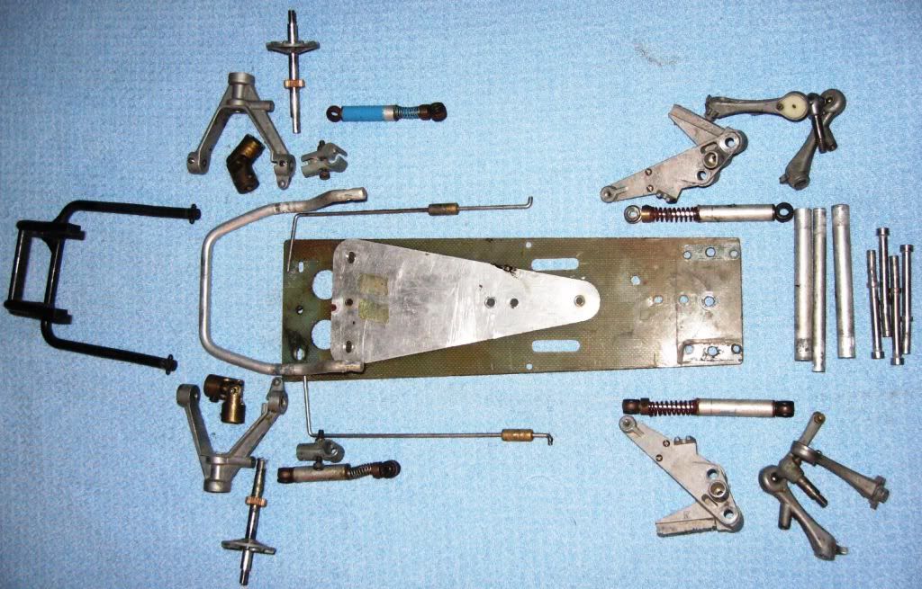

Anyway, 20 minutes later...down to component parts...
...not too bad at first glance, but wait..

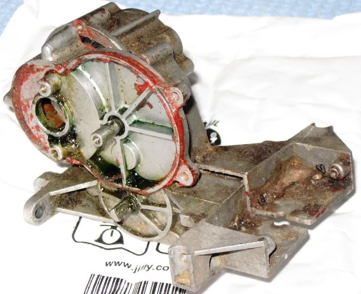

...what's that ? - mouse droppings ??, red paint where there should be silicone sealant ? and what's leaking from the geearbox ?

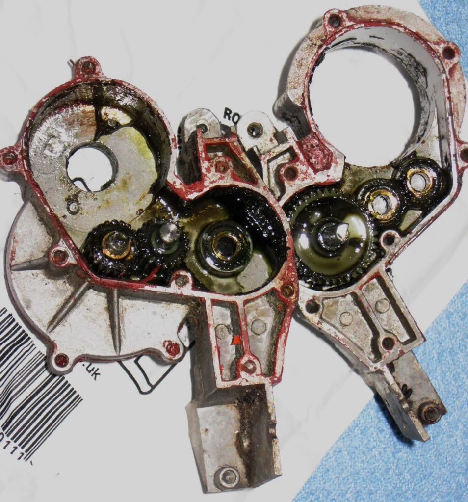

hmm, better take a better look inside..
Nice - thick black, green grease - poor motor trying to turn that lot !

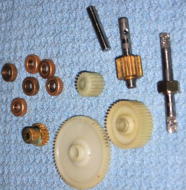

Gears after a quick degrease - much better !

Wow, that's one of the worst SRB gearboxes I've ever seen & I've seen some nasty ones.
At least it still has both the motor stay nubs & should be ok after a good clean.

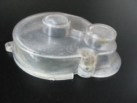

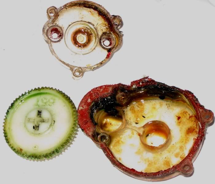

Remember that gear cover..
well after an overnight soak in a mixture of household bleach and warm water (20/80 mix) it now looks like this..
whatever the red paint / sealant / grease / gloop was just lifted off/dissolved away leaving a nice clean gear cover - its not quite as white as the picture suggests and yes there are some micro cracks evident but this one will be modified to go over a slipper clutch set up in one of my other SRB projects.
I had similar blue gunk on one of the chassis' i got from eBay, again it dissolved away and left a clean casing but it was horrible stuff
