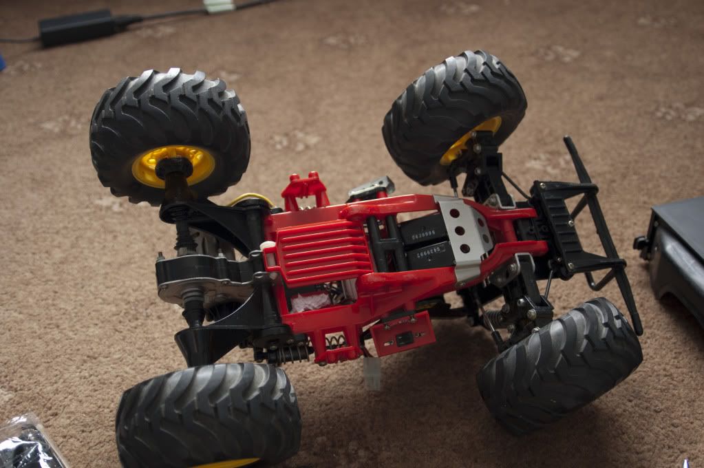

Ive just got my hands on a great blackfoot and im looking for some new tyres, got some decals, and a few new/upgrade parts, but the tyres are much too hard, or is there a way of re-viving my old ones.
this is how it came to me, before the strip/clean and re-build.
If they have hardened but not cracked then rub some smooth peanut butter into them. The peanut oil will revive them a little. If you intend to use it then repeat the treatment after the first three runs and then every other. Will keep them from cracking and deteriorating.
mmm think ive heard that somewhere before but cant think where, well a jar of peanut butter is a bit cheaper than a set of new tyres, cheers for that i will keep you informed.
Lol I'd forgotten about the peanut butter trick til it got mentioned earlier this week. And yes I have used it on 1:1 cars in the past!!
