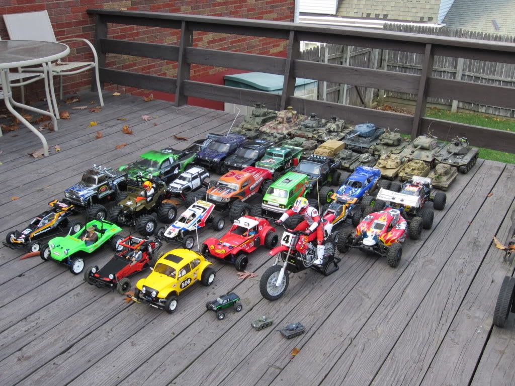

:o Can't go wrong with Deans connectors i been using them for ever... all my rc's have deans!!
My god that is quite a collection!
